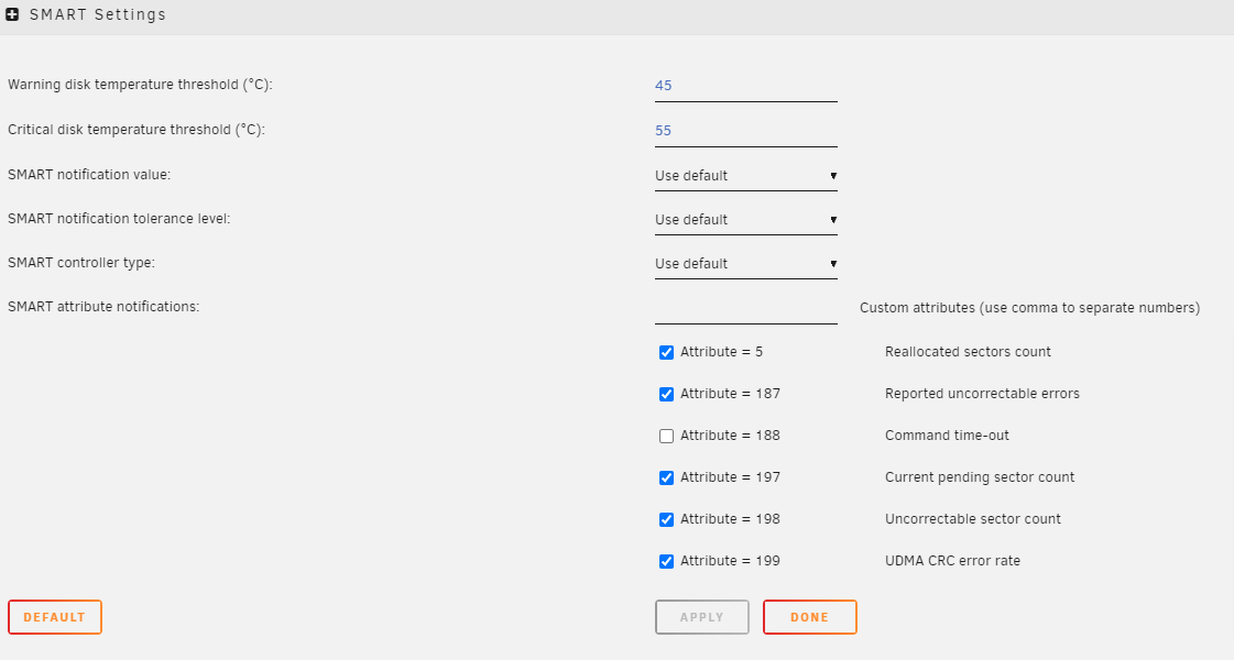

October 12, 20215 yr Author i've tried twice to run the SMART extended self-test. it goes for a few hours, eventually i come back it shows "No self-tests logged on this disk" but i also get notifications as follows 1) array health report [FAIL] 2) Fix common problems > Errors have been found > Investigate settings > which sends me back to "disk1" has read errors "Suggested Fix" >> If the disk has not been disabled, then unRaid has successfully rewritten the contents of the offending sectors back to the hard drive. It would be a good idea to look at the S.M.A.R.T. Attributes for the drive in question Begin Investigation Here > back to disk1 settings, image attached I believe the next step would be to replace disk1, correct?
