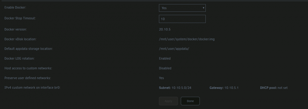

Do you have any containers with macvlan IP addresses specified?
As far as I know I do not.  I have Host Access to Custom Networks defined as Disabled but I do have a custom ipv4 network for pihole.
Edited by Rockstar
Added screen cap
That'll do it.
Interesting! Would just stopping the container be enough to test or should I remove the the whole thing?
