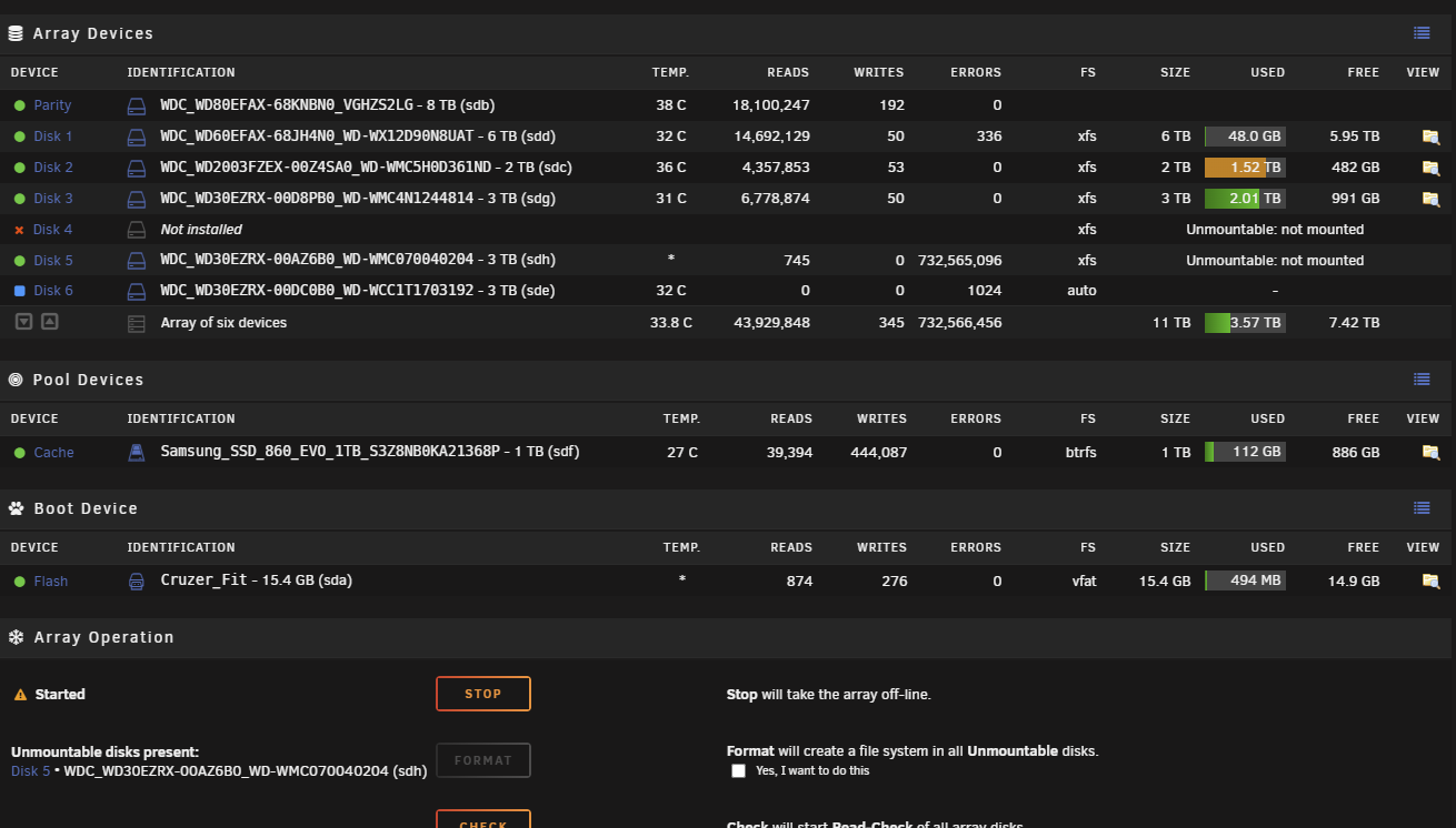

I'd love to use unBalance, but it doesn't recognize that either of the drives that have issues have content. Currently, I'd love to get any emulated data off both disk 4 and 5 (probably moving it all to disk 1):
Is there a bash command to run, or can binhex-krusader help or...? I'm on Windows.
cube-diagnostics-20211025-1701.zip
Well that's expected if the disks are unmountable, disk5 dropped offline, check/replace cables and post new diags after array start.
Disk _5_ dropped offline? Don't you mean Disk 4?
No, disk5.
This situation is going from bad to worse. Now I have three disks not working, although only two of those are actually connected.
