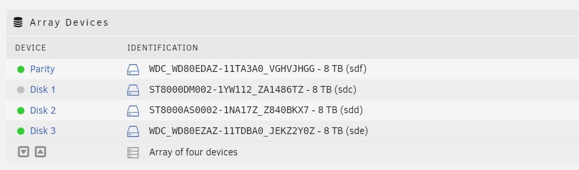

The Spindown of my HDDs doesn't work. When I click on spindown manually, the HDDs will spin down for a few seconds and then they spin up again. The Only drive where the spindown works is the parity drive.

The only Disk that spins down is Disk 1. All other drives doesn't.

Now Disk 1 and Disk 2 stay in Spin Down. But Disk 3 and my Parity Disk don't.
@Squid mentioned Nextcloud would be a Problem for spinning down the disk. So it makes sense that Disk 3 doesn`t spindown. Is there any way to solve that or do I have to live with this when I want to use Nextcloud? Is likewise responsible for not spinning down the parity disk?

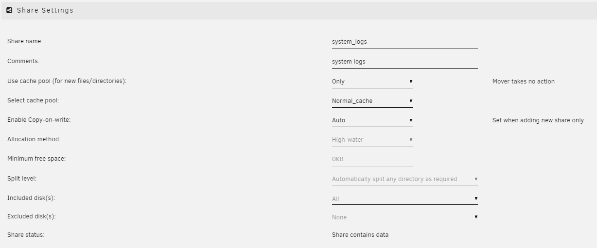

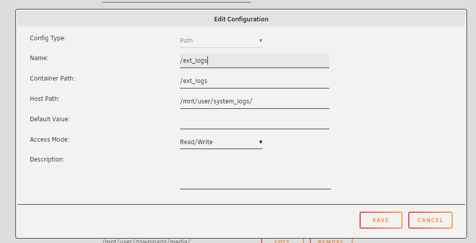

ext_logs is share with cache (only) and this share is mounted as an external path on the nextcloud container. so this is not on the docker itself.

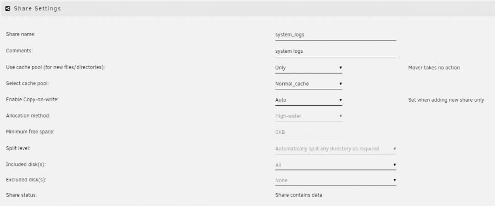

this is how is it setup on nextcloud
and this is the share settings.

That is a fair point. posted couple of screenshots above. more more clarity i will mentioned the details again below.
1. setup a new share for storing log files (preferably set to cache only so it will not harm the spinning disks) - example screenshot below
2. Edit nextcloud container settings and add an additional path and point it to the share created in the previous step.
3. edit the config.php (normally located on /mnt/user/appdata/nextcloud/www/nextcloud/config/config.php) and add the below lines somewhere in between the other configs there.
'logfile' => '/ext_logs/nextcloud_logs/nextcloud.log',
'logfile_audit' => '/ext_logs/nextcloud_logs/audit.log',
4. restart the nextcloud container.
5. verify the disk with nextcloud data is spinning down after the timeout you set.
Hope this helps.
