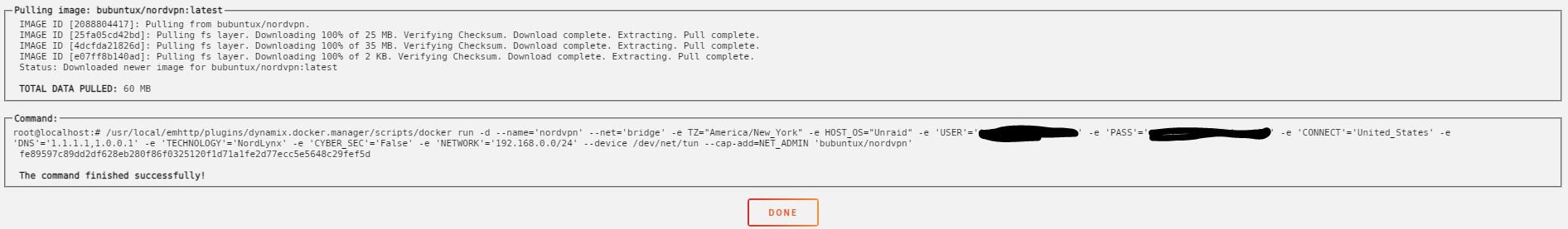

On unRAID 6.9.2, when I install nordvpn docker container, there is no entry/directory created in the /mnt/user/appdata folder. However the install appears to complete properly yet when I start the container, it reports invalid username or password in the log and then goes into a stopped state. If I ssh into the server, I can navigate to the /mnt/user/appdata/ folder and see the folders for the three working containers. When I install the nordvpn container, not directory is created.

Within the parameters of the nordvpn container, I have '--device /dev/net/tun --cap-add=NET_ADMIN" in the Extra Parameters field, my network type is set to Bridge and I've confirmed that the username/password is entered properly.

You will have better chance to receive an answer on the support thread for this docker :
It might be normal that there is no appdata since no path is present in the template.
