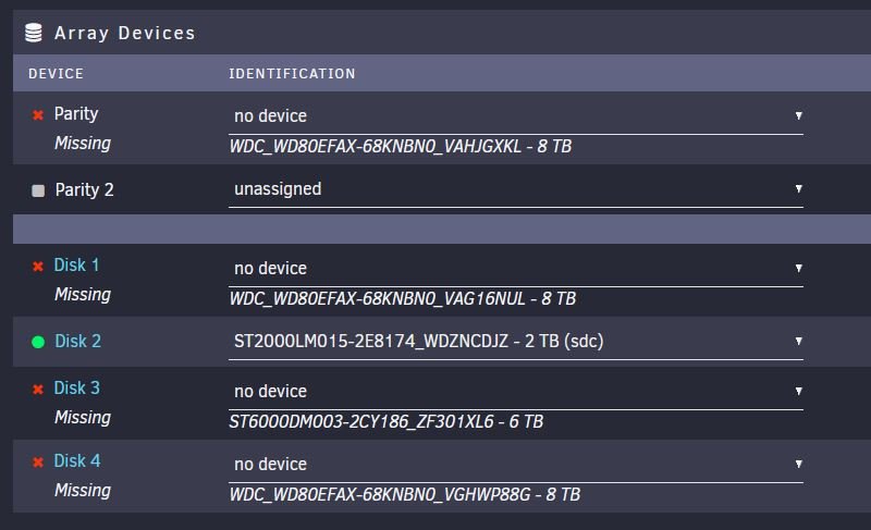

I updated some hardware in my server and now I'm missing 4 x drives (1 x parity and 3 x data), 2 x drives are working (1 x data and 1 x cache) The new hardware consists of:
MSI MAG B550M Mortar MB with latest bios
AMD Ryzen 7 3700X cpu
32Gb DDR4 3200 ram
Migrated across to the build was:
Dell H310 HBA card
Nvidia Quadro K2200
When I started the server I get a message saying "Array Stopped Stale Configuration" and the 4 x drives mentioned above are missing and the drop down says no device against each missing drive. I have swapped ports and cables on the H310 and the drives still don't show. I removed the H310 card and plugged the drives into the MB sata controller and they still don't appear. I've checked the bios and two working drives are the only ones to show. Is there anyway to fix this or have I lost 4 x drives and 16Tb of data? All the missing drives are 6Tb or more.

Did you also change Power Supply?
Yeah I forgot to mention that, went from a tiny HP PS to a Corsair RM750x..
Did you use the modular cables that came with the Corsair? There is no standard pinout for modular PSUs. People have fried drives by using the wrong modular cables.
Yes I did, but I have a couple of Corsair PSU's and used a longer cable from a different PSU, The result? Four fried drives, they won't spin up so I guess I've blown the surge protection diodes on each drive. Bloody expensive mistake to make....
Some people have had success replacing the circuit board on a drive with one from an identical model.
Thanks I've ordered a couple and if successful , I'll order the other two. Thanks for the help.
