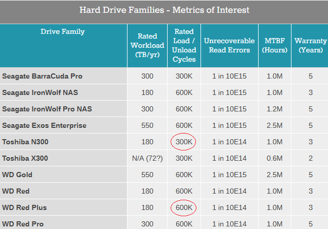

October 15, 20215 yr On 10/12/2021 at 12:30 PM, TODDLT said: I find myself questioning the need to stay with 7200 RPM drives over 5400, based on the current price difference. Any thoughts one way or the other. i doubt you'll see much of real world speed differences in the NAS environment. I think what would be more of interest is a difference in their load/unload cycle ratings: Edited October 15, 20215 yr by Lolight
