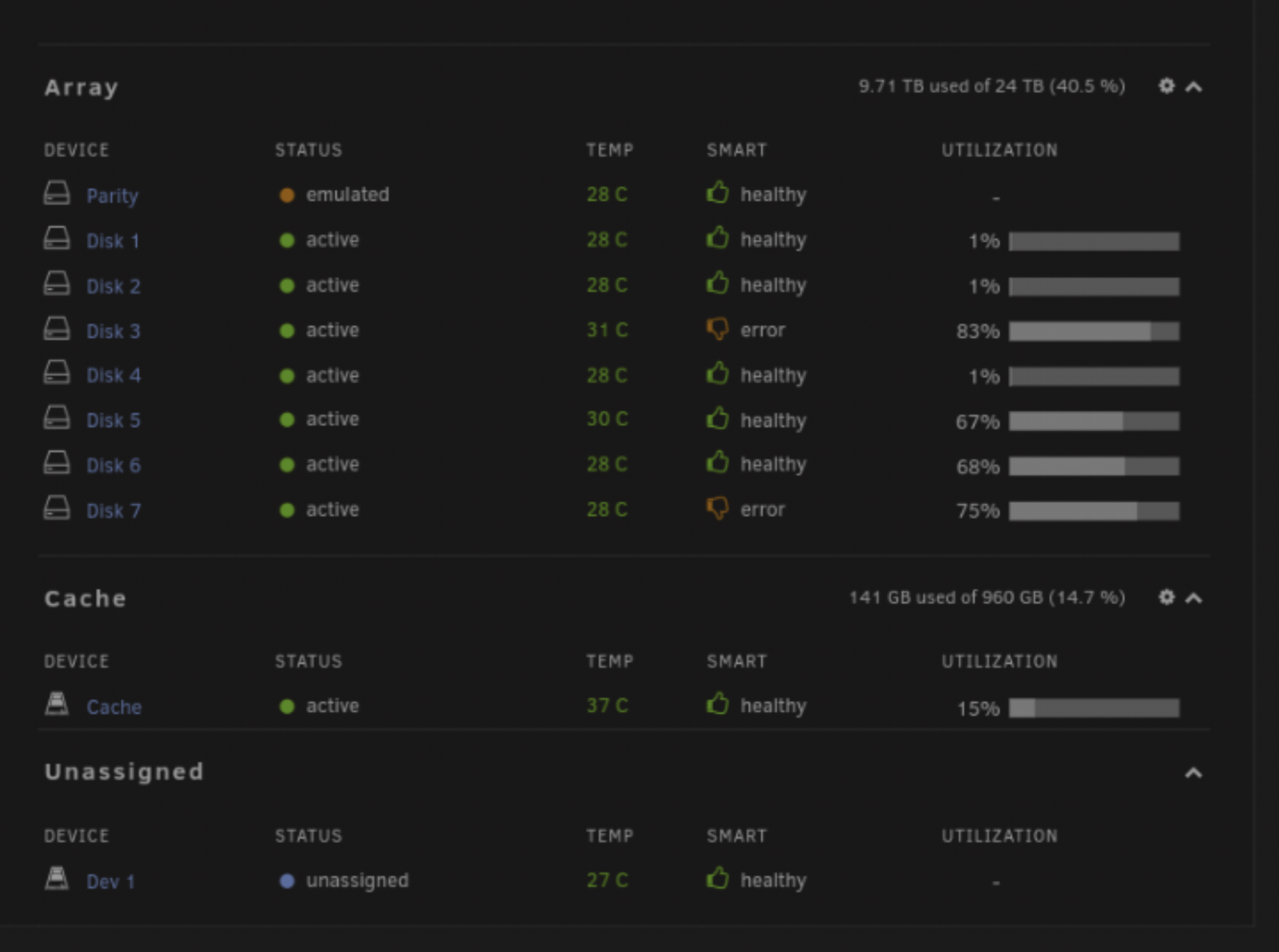

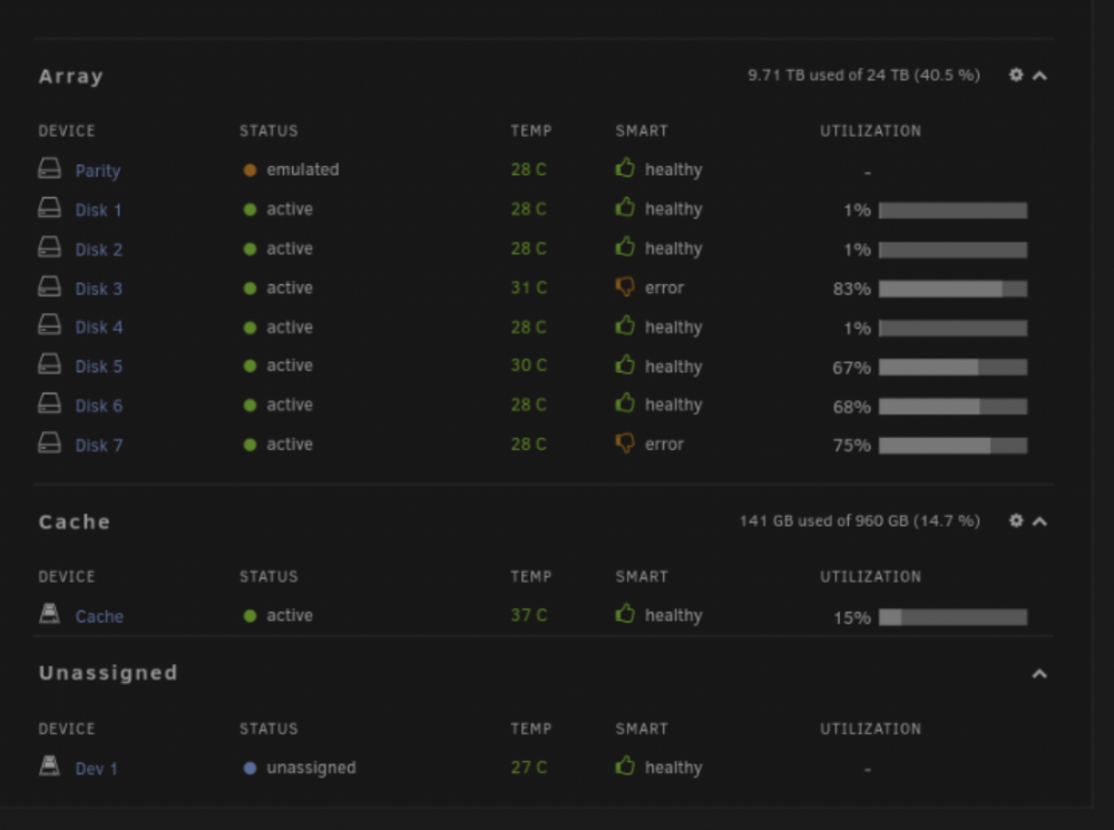

Are there Errors in the Errors column for any array disk on the Main page? Do any of your disks have SMART warnings on the Dashboard page?
2 drives have errors on dashboard page
disk3 is just CRC, which indicates a connection issue sometime in the past.
disk7 doesn't look good. I would replace it, but unfortunately you don't have valid parity.

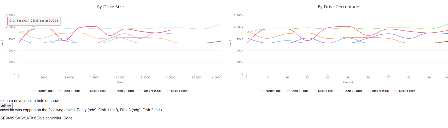

You can also run a diskspeed docker test to see if all the disks are performing normally.

ok let me run some disk speed tests, will post when they are done
So i updated to unraid 6.9.2 i didnt think that would cause the issue, i am back to 6.8 now and the speeds are as in the above picture. so basically something in 6.9.2 is causing this slow disk issue :(
Those speed graphs show the problem, maybe a SAS2LP issue with v6.9? Strange that I don't remember seeing anyone else complaining, and despite those controllers not being recommended I suspect there are still a few in use, could also be other hardware issue with the newer kernel, not controller related.
for the time being i am staying on 6.8 until i setup my 2nd parity and re add few more drives.
