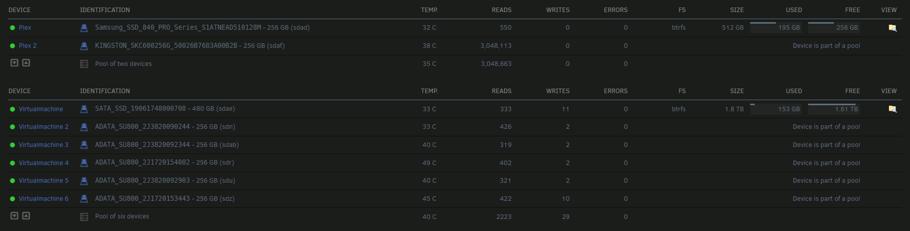

If array auto-start is enable disable it by editing /config/disk.cfg in the flash drive and changing startArray="yes" to "no", then reboot and post a screenshot of main before array start.
Ok, I think I found the issue. The plex pool was looking for the sdae drive, but that drive path was reassigned to another disk after the shuffle. That disk is located in the virtualmachine pool which is initialized first before the plex pool normally. The reason it was causing problems when starting the array is because plex is where my appdata and system shares are located. Disabling docker allowed the array to start fine and I was able to format the other pools with changes and begin clearing the new data disks in the array.
I do not currently have docker running and the plex pool is still read only. I am initiating a full back up of all files on the pool and then I will figure out what to do. I am considering just deleting the pool and recreating it and then restoring the backups since the mover isn't doing anything after I switch from prefer to yes for the cache option or to another cache pool. Unless you have any other ideas to make it work.
I will not have physical access to the machine for the next week and a half so any solutions would have to be software solutions.
