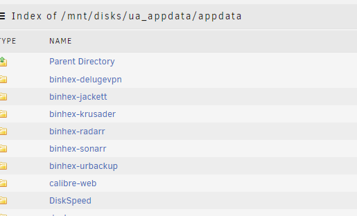

I have checked my Appdata folder and I still have full access to it, via SMB and via the unraid website,
I have this on a un-assigned drive, but I have full access to this.

no I am able to access the drive with no issues, I also through at the beginning that I had a drive issue,
but as I am able to access it and browse through the file structure I ruled this out.

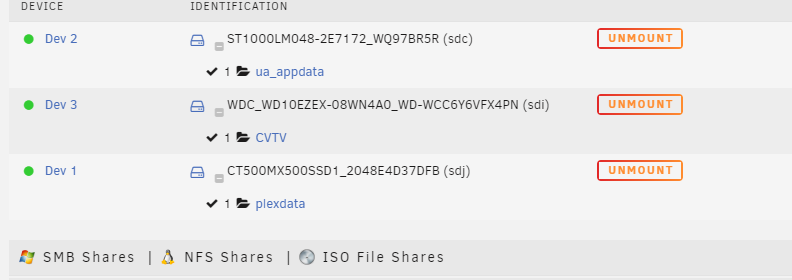

I have attached a screenshot of my drivers
Well the syslog shows you were getting I/O errors on the drive.   Have you tried running a file system check and/or an extended SMART test?
yes and the SMART test came back OK,  but I do have I/O errors.
I had to reinstall all my dockers and relink my VM's.  and I have also just order a new Hard Disc.
