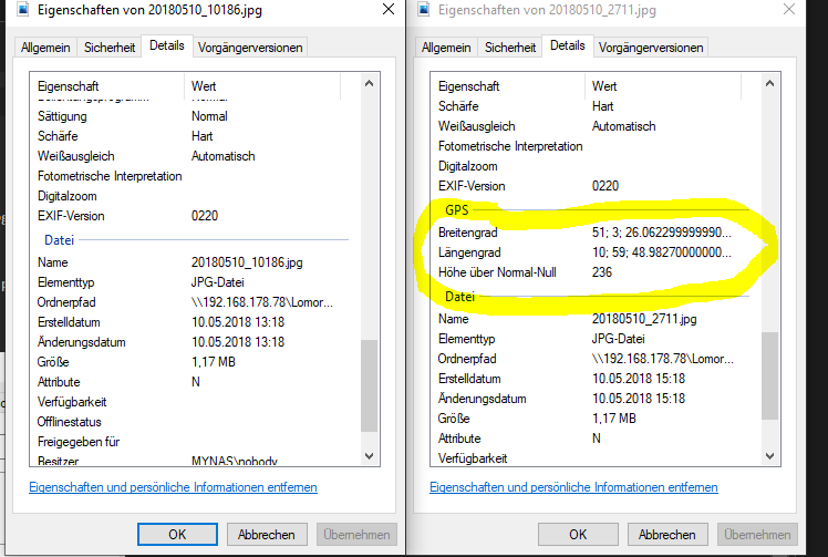

Hi , i import an full backup folder of my pictures with follow commands :
-1  i connect to the docker in  ssh with putty: docker exec -it --user root Lomorage /bin/bash
-2 i started the import process ./lomoc import name pass /importFolder/
after the import i connect with the phone and push the sync botton
now i have a lot of duplicate images in lomorage
have i done something wrong and how can i clean this up ?
thanks
thanks

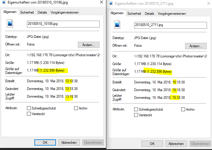

1. For the duplicate images, can you check their SHA1 and see if they are same?
2. Are these duplicate images mainly apple live photos?
no.
one of the file has no more gps information
4 hours ago, Nahasapeemapetilon said:
no.
Seems like 20180510_10186.jpg is newly imported, guess it was imported via lomoc tool. Are you able to locate original files? If yes, can you please check its sha1sum?
i think the android sync or lomoc importer removes the gps data
Edited by Nahasapeemapetilon

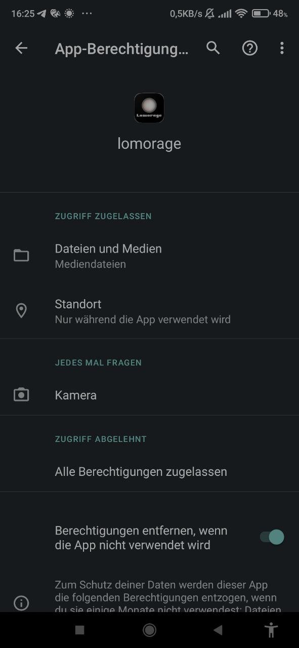

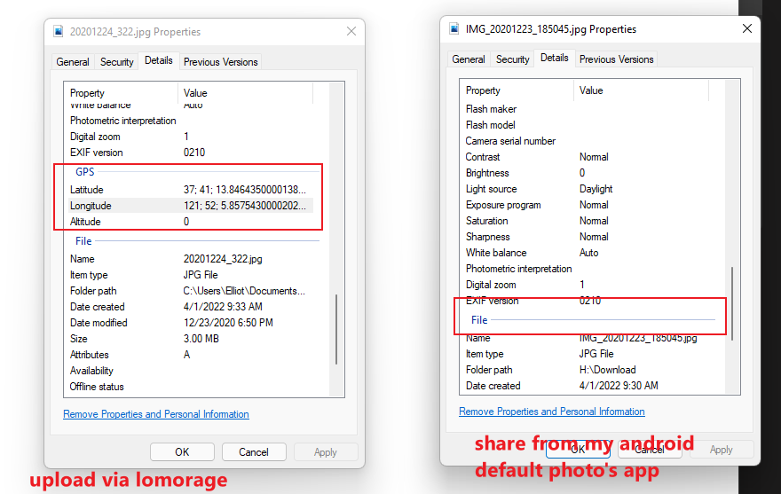

could you try to go to your phone's setting to check the Lomorage app can access the location?
From my testing, the lomorage app will read the picture as binary data to upload to the server.
Maybe there is some hooking on the system level to remove the GPS info for the privacy concern.  Like in my phone with default Gallery app, if this app does not has location access permission, even the pictures do has the GPS data, but share from this default Gallery app, the picture's GPS will be removed.
So could you double check the phone's location permission manager?

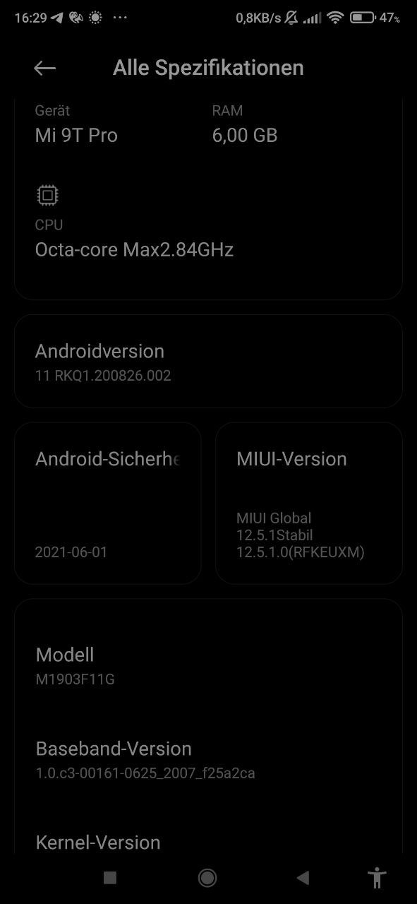

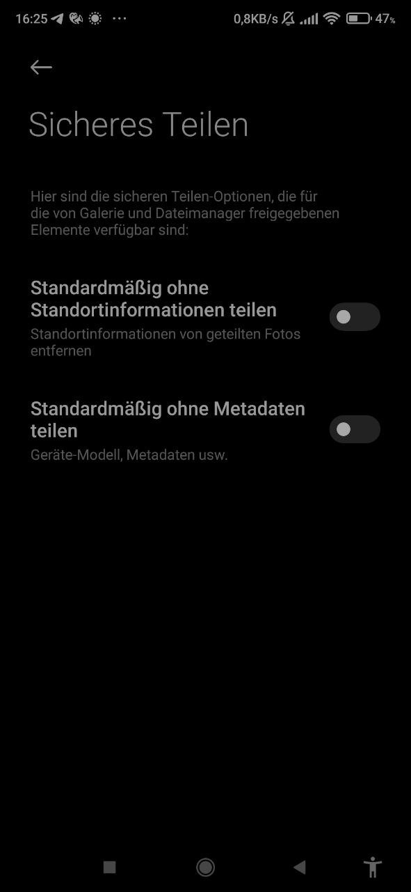

settings for the app
standard gallery app
phone version
before i have synchronized always with foldersync, the app also has no special access rights on the location
nevertheless the pictures then have no gps data on the nas
let me understand,
using folderSync app to upload  photo to nas, these pictures also have no GPS data ?
  • 4 weeks later...
The issue is fixed in latest Android release https://github.com/lomorage/lomo-android-apk-release/releases/download/2022-04-20_10-05-24/com.lomoware.lomorage-v41.0.944.-release2022-04-20_10-05-24.apk. see https://github.com/lomorage/lomo-android-apk-release/issues/5 for more details.
