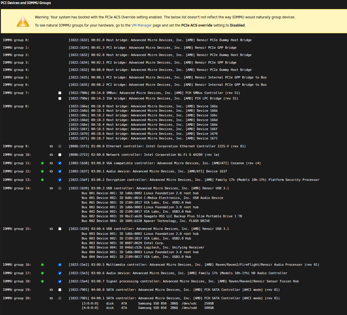

Here is my IOMMU groups:
Edited by techhit

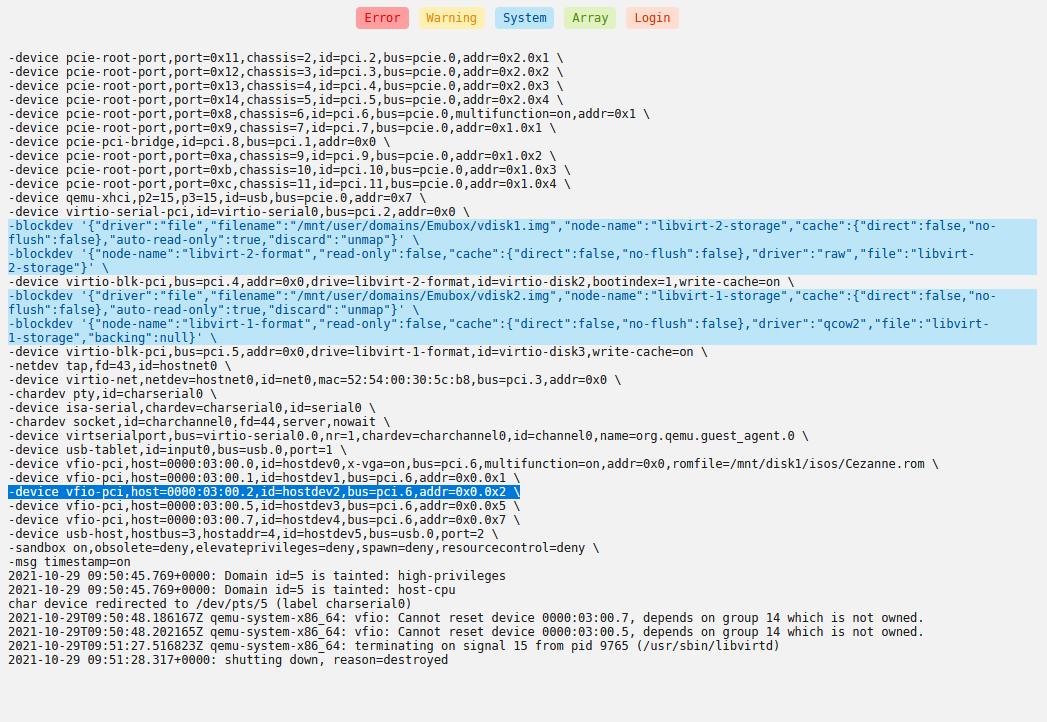

And here is the VM log:
This is an issue with the reset. Libvirt log says that can't reset 03:00.7 and 03:00.5 without passing through also group 14, containing 03:00.3, but you can't because you have the unraid usb plugged in.
Try to attach the unraid usb to a port of 03:00.4 so you can pass also 03:00.3 and hopefully libvirt will not request to pass also 03:00.4 (but I have doubts that it will work..)
Did you try also to not pass 03:00.7 and 03:00.5?
Edited by ghost82
Yes, I've also tried not passing through 03:00.7 and 03:00.5.  And then the error log complains about 03:00.2.
And also, I have just tried passing through the GPU and HDMI audio 03:00.0 and 03:00.1 only, and same result.
Here is the log where I pass through everything.  This time I've changed the flash drive from the back to the front, so that's why it's on a different usb root hub.
-device pcie-root-port,port=0x13,chassis=4,id=pci.4,bus=pcie.0,addr=0x2.0x3 \
-device pcie-root-port,port=0x14,chassis=5,id=pci.5,bus=pcie.0,addr=0x2.0x4 \
-device pcie-root-port,port=0x8,chassis=6,id=pci.6,bus=pcie.0,multifunction=on,addr=0x1 \
-device pcie-root-port,port=0x9,chassis=7,id=pci.7,bus=pcie.0,addr=0x1.0x1 \
-device pcie-pci-bridge,id=pci.8,bus=pci.1,addr=0x0 \
-device pcie-root-port,port=0xa,chassis=9,id=pci.9,bus=pcie.0,addr=0x1.0x2 \
-device pcie-root-port,port=0xb,chassis=10,id=pci.10,bus=pcie.0,addr=0x1.0x3 \
-device pcie-root-port,port=0xc,chassis=11,id=pci.11,bus=pcie.0,addr=0x1.0x4 \
-device pcie-root-port,port=0xd,chassis=12,id=pci.12,bus=pcie.0,addr=0x1.0x5 \
-device qemu-xhci,p2=15,p3=15,id=usb,bus=pcie.0,addr=0x7 \
-device virtio-serial-pci,id=virtio-serial0,bus=pci.2,addr=0x0 \
-blockdev '{"driver":"file","filename":"/mnt/user/domains/Emubox/vdisk1.img","node-name":"libvirt-2-storage","cache":{"direct":false,"no-flush":false},"auto-read-only":true,"discard":"unmap"}' \
-blockdev '{"node-name":"libvirt-2-format","read-only":false,"cache":{"direct":false,"no-flush":false},"driver":"raw","file":"libvirt-2-storage"}' \
-device virtio-blk-pci,bus=pci.4,addr=0x0,drive=libvirt-2-format,id=virtio-disk2,bootindex=1,write-cache=on \
-blockdev '{"driver":"file","filename":"/mnt/user/domains/Emubox/vdisk2.img","node-name":"libvirt-1-storage","cache":{"direct":false,"no-flush":false},"auto-read-only":true,"discard":"unmap"}' \
-blockdev '{"node-name":"libvirt-1-format","read-only":false,"cache":{"direct":false,"no-flush":false},"driver":"qcow2","file":"libvirt-1-storage","backing":null}' \
-device virtio-blk-pci,bus=pci.5,addr=0x0,drive=libvirt-1-format,id=virtio-disk3,write-cache=on \
-netdev tap,fd=34,id=hostnet0 \
-device virtio-net,netdev=hostnet0,id=net0,mac=52:54:00:30:5c:b8,bus=pci.3,addr=0x0 \
-chardev pty,id=charserial0 \
-device isa-serial,chardev=charserial0,id=serial0 \
-chardev socket,id=charchannel0,fd=35,server,nowait \
-device virtserialport,bus=virtio-serial0.0,nr=1,chardev=charchannel0,id=channel0,name=org.qemu.guest_agent.0 \
-device usb-tablet,id=input0,bus=usb.0,port=1 \
-device vfio-pci,host=0000:03:00.0,id=hostdev0,x-vga=on,bus=pci.6,multifunction=on,addr=0x0,romfile=/mnt/disk1/isos/Cezanne.rom \
-device vfio-pci,host=0000:03:00.1,id=hostdev1,bus=pci.6,addr=0x0.0x1 \
-device vfio-pci,host=0000:03:00.2,id=hostdev2,bus=pci.6,addr=0x0.0x2 \
-device vfio-pci,host=0000:03:00.3,id=hostdev3,bus=pci.6,addr=0x0.0x3 \
-device vfio-pci,host=0000:03:00.5,id=hostdev4,bus=pci.6,addr=0x0.0x5 \
-device vfio-pci,host=0000:03:00.7,id=hostdev5,bus=pci.6,addr=0x0.0x7 \
-device usb-host,hostbus=3,hostaddr=4,id=hostdev6,bus=usb.0,port=2 \
-device usb-host,hostbus=3,hostaddr=3,id=hostdev7,bus=usb.0,port=3 \
-sandbox on,obsolete=deny,elevateprivileges=deny,spawn=deny,resourcecontrol=deny \
-msg timestamp=on
2021-10-30 00:55:14.273+0000: Domain id=3 is tainted: high-privileges
2021-10-30 00:55:14.273+0000: Domain id=3 is tainted: host-cpu
char device redirected to /dev/pts/0 (label charserial0)
2021-10-30T00:56:16.768588Z qemu-system-x86_64: vfio: Unable to power on device, stuck in D3
2021-10-30T00:56:16.785683Z qemu-system-x86_64: vfio: Cannot reset device 0000:03:00.7, depends on group 15 which is not owned.
2021-10-30 00:56:47.351+0000: shutting down, reason=failed
That was what I imagined, most probably all 03:00.X must be passed through, but since you don't have any other usb controller, you can't.
I'm really not sure what else I can do from here.
For this actual hardware, nothing.
Alright.  Well, appreciate your input anyway.
I believe there is an UnRaid app that can update the UnRaid kernel to avoid the reset issues as well.  6.9 and 6.10 have it available albeit in different flavors from what I recall.  Unfortunately due to another issue I had to roll back so can't search the apps to find the exact name for you.  If the above works then great maybe you don't need this.  You might also try searching for Radeon or AMD in the UnRaid apps tab and you should see something come up showing an AMD log that talks about fixing the reset issue.
