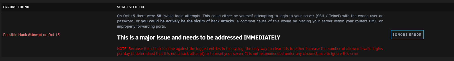

FML. So I could REALLY use some help from the forum here with this one. I received the following as part of the 'Fix common problems' plugin last night at about 11pm ET. Shortly after at about 11:30pm ET, I grabbed a diagnostic report and shut the whole server down. I could use some help making heads or tails of where to look in the report for future reference and what the group see's in terms of concerns.

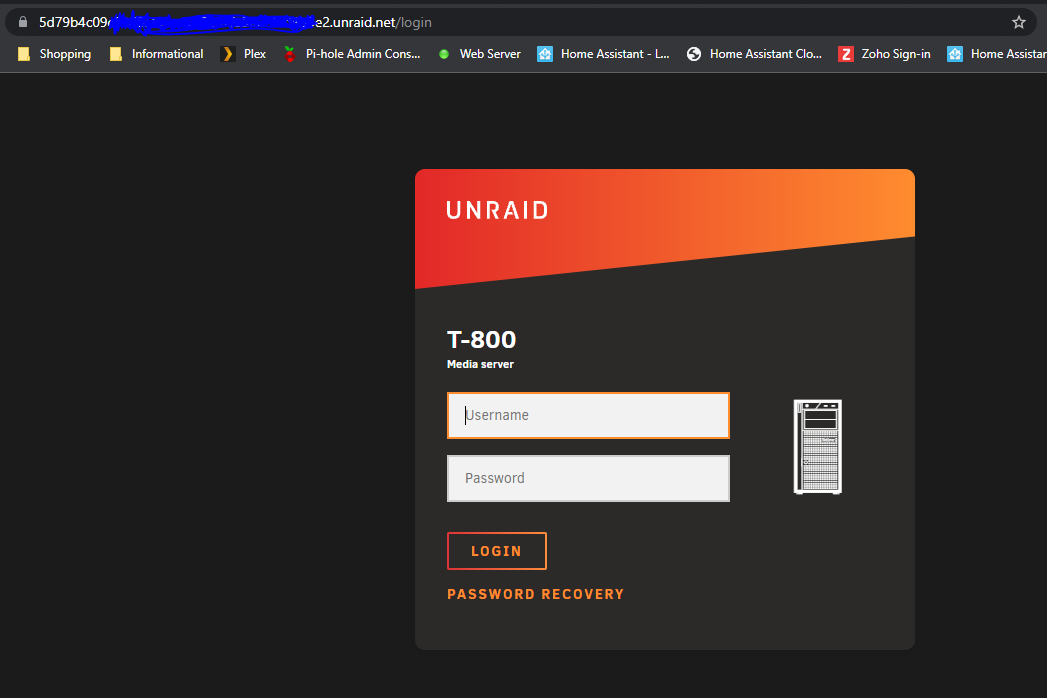

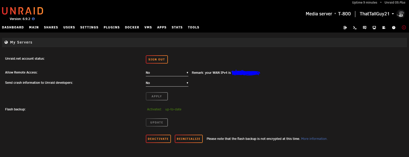

Attached MyServers screenshot.
I also just tried to access my unraid login screen from my phone while on my mobile network. As expected, it timed out and was unable to load. The second attachment is of the login screen while only connected to Wifi. As you can see, I only use the My Servers plugin to save a backup of my flash drive.

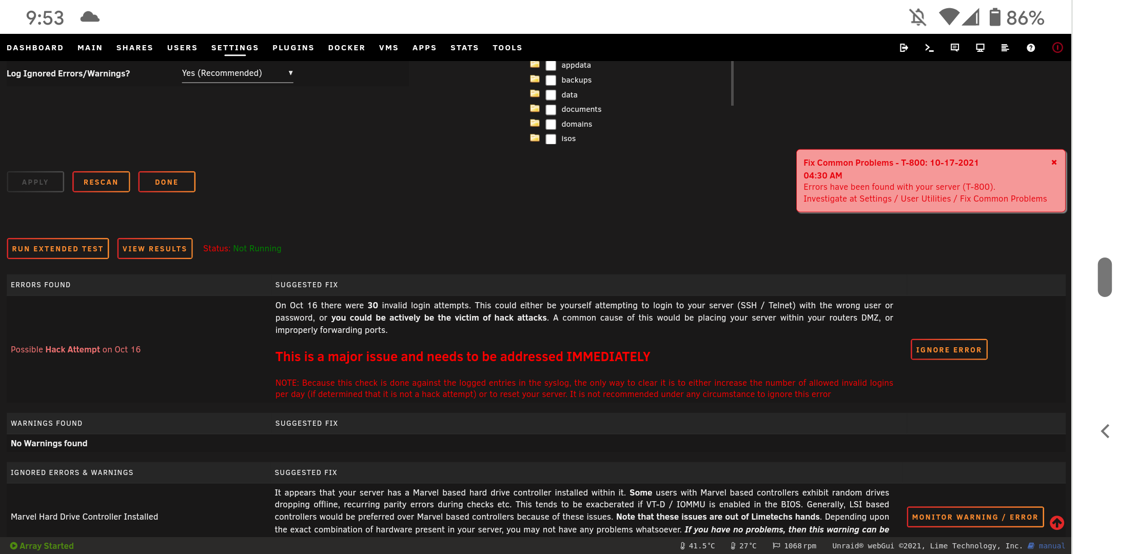

HELP STILL NEEDED!!! I'm not sure what's going on still.
  • I logged into my server a little bit ago this morning and saw there were still possible hacking attempts being made this past Saturday.
  • I've attached my diagnostic report and then restarted my server again.
  • To date, another user mentioned I may have my server available externally, which I don't see how it could be the case.
    • I've attempted to access my server from my mobile device and it does not load. The 'My Server' plugin is setup but not configured to allow for remote access.
