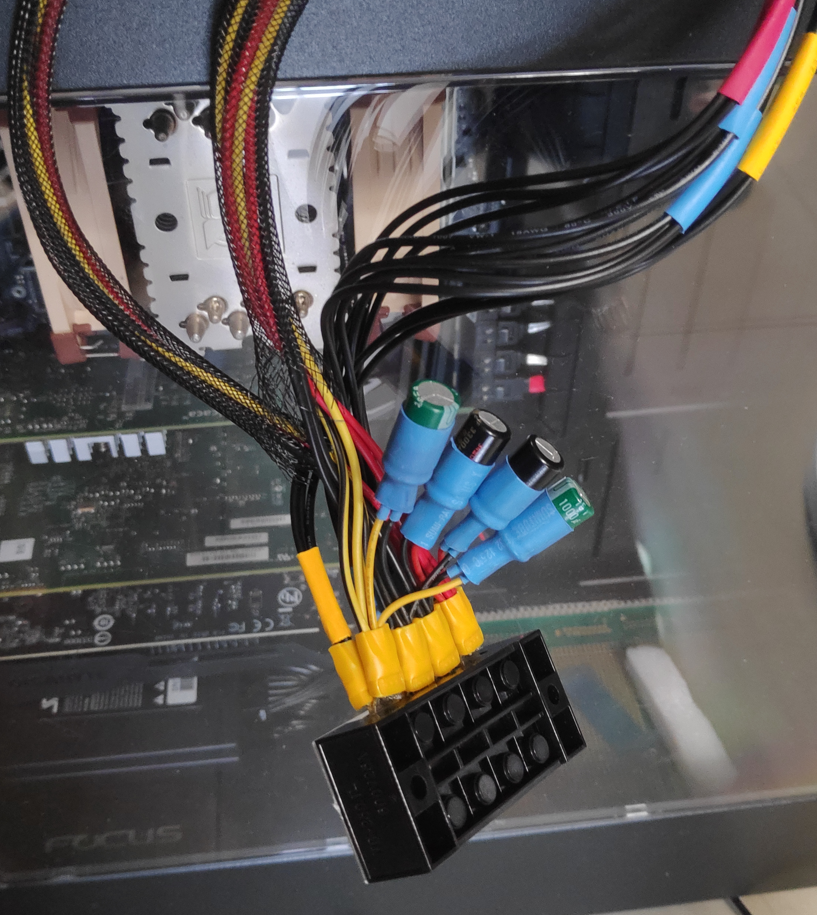

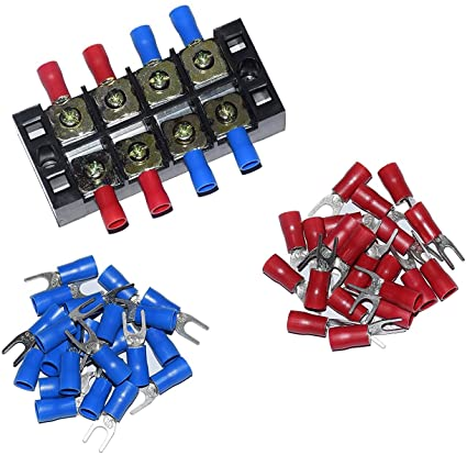

I will build something use DIY component. One side coming from PSU and the other side connect to harddisk. 4 terminal are 12v G G 5V.
Each "Insulated Terminal Barrier Strip" ( red black yellow ) will insert 3 or 4 wire and I will soldering to ensure reliable connection.

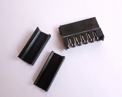

I will build different harddisk wire set ( black wire with correct diameter ) for different need, just detach / attach at terminal block.
Each wire will connect max 4 disk, and inset to DIY SATA plug at the end.
Anyway, max 16 disks, never use Y power splitter.
image.png.9b4f41bc73e3ad74d7a103e6d74f4659.png image.png.72eb0e2d250ef4e7a88524935de57332.png
Or something like that, if connect point have two "Insulated Terminal Barrier Strip", then it can increase the no. of connect device or to change the direction.
Edited by Vr2Io
What are the role of those electronic components ? Are those capacitor ?
Yes, those are capacitor, use to minimise ripper voltage, it also share the loading of PSU inside capacitor, it should little bit help to extend the PSU life.
