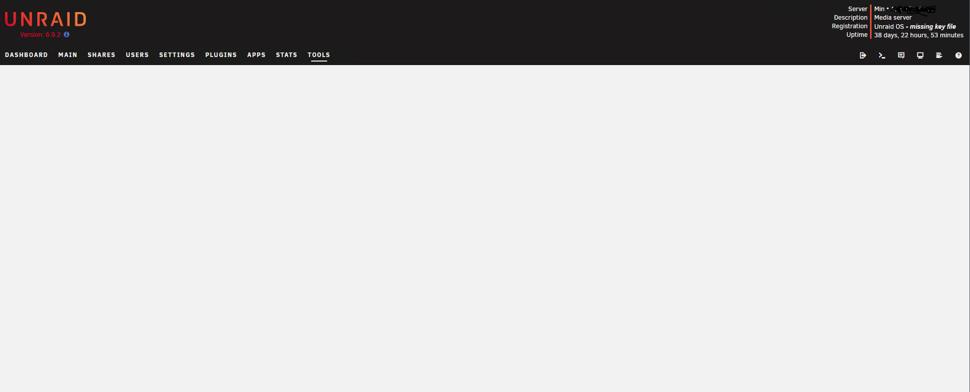

At 0800 I got the following email from myself, as follows:
cron for user root /sbin/fstrim -a -v | logger &> /dev/null
fstrim: /boot: the discard operation is not supported
When I went to check my server, every menu is blank. There is a warning about my license key missing.
All shares are accessible and up. Plex via a docker is working OK. I can get in via SSH.
I have re-seated the USB key, but have taken no other actions yet - I have not rebooted - for fear of making it worse.
What should I do next?  I'm not sure how to get diagnostics:
root@Min:~# diagnostics
Starting diagnostics collection... mkdir: cannot create directory ‘/boot/logs’: Input/output error
done.
ZIP file '/boot/logs/min-diagnostics-20211019-1130.zip' created.
I don't have flash exported, so I have no way - that I know of? - to get to that path.
Thank you!
Edited by Ouze
solved
based on this, the flash was pulled or dropped offline.  Reboot is your recourse.  Use a USB2 port if at all possible.  If this continues, either replace the flash or try the Flash Remount plugin.
Thank you, crossing my fingers and rebooting now. 😨
Ok, mostly good news, some minor bad news:
Before I rebooted I tried copying the syslog to disk1. It did so, but it doesn't seem to be useful: whatever broke seems to have broken prior to when the log went sideways, but attaching what I have anyway.
The other minor issue: I rebooted dirty. I thought "poweroff" was safe from googling, but that clearly is not correct, as it's doing a parity check (Powerdown didn't seem to do anything). Is there a command I could be using in the future?
Thank you again for the swift assistance, I really appreciate it!
syslog.zip
powerdown is safe.  But the reason why the system thinks it's an unclean shutdown is due to the flash drop, the OS was unable to write the flag that signified it was a clean shutdown.  You can safely cancel.
Awesome. Thanks again!
