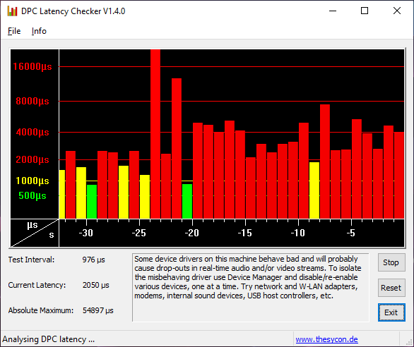

October 25, 20214 yr Author I found the "dpclat" Latency Checker in some posts. So i tried it and iam getting really high results as you can see in the picture. Unfortunatly the tool doesent tell me which latencys are bad. Has anybody some idears?
October 26, 20214 yr You could try latencymon and follow these advices: https://www.sweetwater.com/sweetcare/articles/solving-dpc-latency-issues/ Probably irq conflicts: msi util v2/v3 can help in this. Edited October 26, 20214 yr by ghost82
