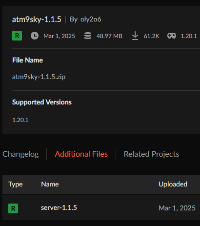

@Goobaroo is the forge-installer jar supposed to download the mods per the modlist.html? The issue myself and a few others in the thread have had is that the mods are not being downloaded into the /data/mods directory. For now I am going to put them there manually based on my prism instance, but I am curious what the original intended way for the container to download them is.
Forge installer only downloads forge.  The container itself downloads the server install from the modpack author.  If they are missing mods in their server pack then they will be missing.  It is a bit different than how the client side mods get downloaded.  That is a much higher traffic level than the server packs so authors want the income from the ads associated with downloading them.

Ok so I think I figured out the issue here, the modpack is downloading atm9sky-1.1.5.zip when it should be downloading server-1.1.5.zip.
EDIT: I submitted a pull request here https://github.com/Goobaroo/docker-atm9sky/pull/1
Edited by beamolm
Seems the curse forge API is returning the wrong URL for the serverPack for this release.
I've removed the bad container and pushed up a new goobaroo/atm9sky:1.1.5 image with the correction.

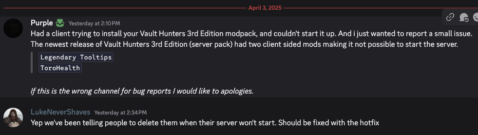

13 hours ago, maereax said:
I just updated my vaulthunters 3 docker to the 17.1 update and it now crashes on launch
tried a fresh install to a new appdata folder and getting the same thing
Looks like some of the mods are crashing on startup.  3.17.0.0 works, you can force your server to that version by adding the version to the repository field in the settings. goobaroo/vaulthunters3:3.17.0.0
I'd check to see if there are other reports on their discord.
@maereax I also re-published my 3.17.1.0 container to automatically fix their mistake.  If you switch to advanced and force update, the latest will delete those two mod files.
