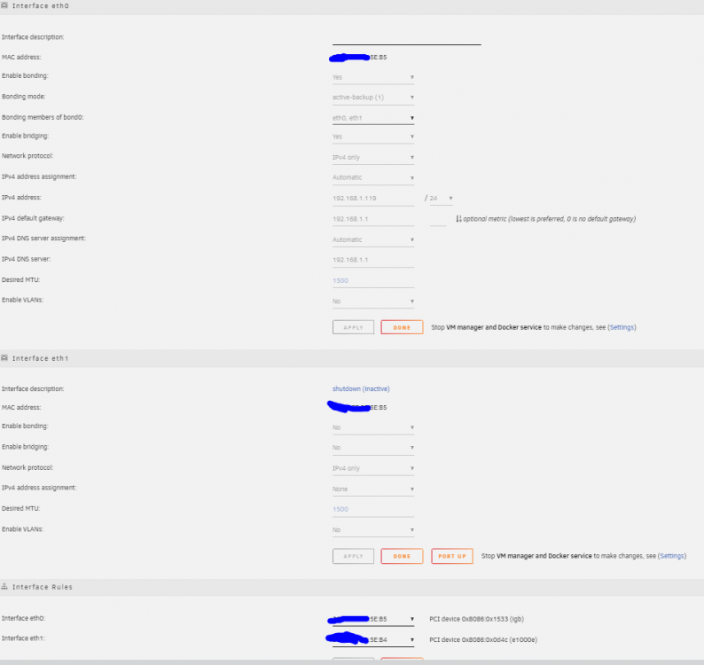

I also figured it might be beneficial to show my Unraid network settings.  See picture:  I'll note I am confused why I have two Interfaces?  I am in no way a technical expert with networking (equipment) but confused on why I have eth0 and eth1 that use the same MAC address.  I did "Port Down" the eth1 interface as reflected in the image; however, I still got the issue noted above after that change.
...you are running a bonded interface, in active backup mode, build from your two Intel based NICs.
Apparently one of these is having problems and when that happens, the active member of the bond will switch over to the other NIC.
You need to find out what is actualy killing the link.
Does this happen to only the first NIC or does this also happen to the other one?
You could try by changing the enumeration, by swapping the MAC addresses for eth0 and eth1.
unraid will normally use eth0 as the default, active NIC.
The first line of your log indicates that this is not a cabling issue but an issue with your PCI(e) interface the NIC sits on.
Also, the Address for both NICs indicate, that these are not on the same BUS address, hence not a DUAL card.
Try to disable ASPM in BIOS for the NICS and/or PCIe.
If the one(s) that fail are on a external card, try to use/deploy into a different slots.

Thanks.  I guess I'll check out Board BIOS settings.  I'll note that this is not an external card.  All NIC's would be integrated with the mobo.  I have no separate cards.  For reference the Mobo is a Supermicro X12SCZ-F.   I know there is a bios update out there for it -- i'll contact Supermicro to see if it relates to the NIC's.  I'm always hesitant on the bios updates.
Also, I didn't know I had two NIC's.  I took a quick look at the Mobo specs and guess you are right.  It shows:
Network Controllers:
Single LAN with Intel® PHY I219LM LAN controller
Single LAN with Intel® Ethernet Controller I210-AT
Which actually makes sense because I have 3 network ports in the rear i/o:   IPMI (Supermicro), LAN2, and LAN1.  I am currently only using the LAN2 port.
Would you also suggest switching to the LAN1 port and using that?  Or wiring both up to the switch?  Like i said, I am horrible with my knowledge of networking and am amateur at best :).  Thanks for your help and time in responding!  Note that LAN2 seems to be linked to the 5E:B5 mac address in my picture above.  LAN1 is linked to 5E:B4 which again is not wired into my network switch.
Edited by Hawkins12
Ah, yes...you are right.
It is always the same NIC that is failing and then recovering again. It is the one named eth0, running the Intel igb driver, from your picture above.
Check the bios, especially energy saving features (often called ASPM) and try disabling these...if possible, only for the NICs.
You can test the second, if this will behave better, as it uses a different driver in Linux/unraid (e1000e).
If you only want to deploy a single link (bond with active backup mode will allow for higher availability, as it will switch over in case of a problem) you could disable bonding in unraid config. Should you keep it, deploy both ports with a patch cable to your switch.

So I am still testing this but I did not mess with bios settings just yet.  I did plug another ethernet cord from the 2nd LAN spot to the switch and it seemed to have made a difference.  I havent had the issue for two days.  Perhaps i have a bad NIC?
...perhaps you just have a bad cable, really.
Messing with the BIOS as you call it is only a browser tab away, the next time you boot that rig, as you have IPMI [emoji1787]
If that's a new motherboard, I doubt that there is a defective NIC, but you never know. Try ASPM disable on the NIC first.
