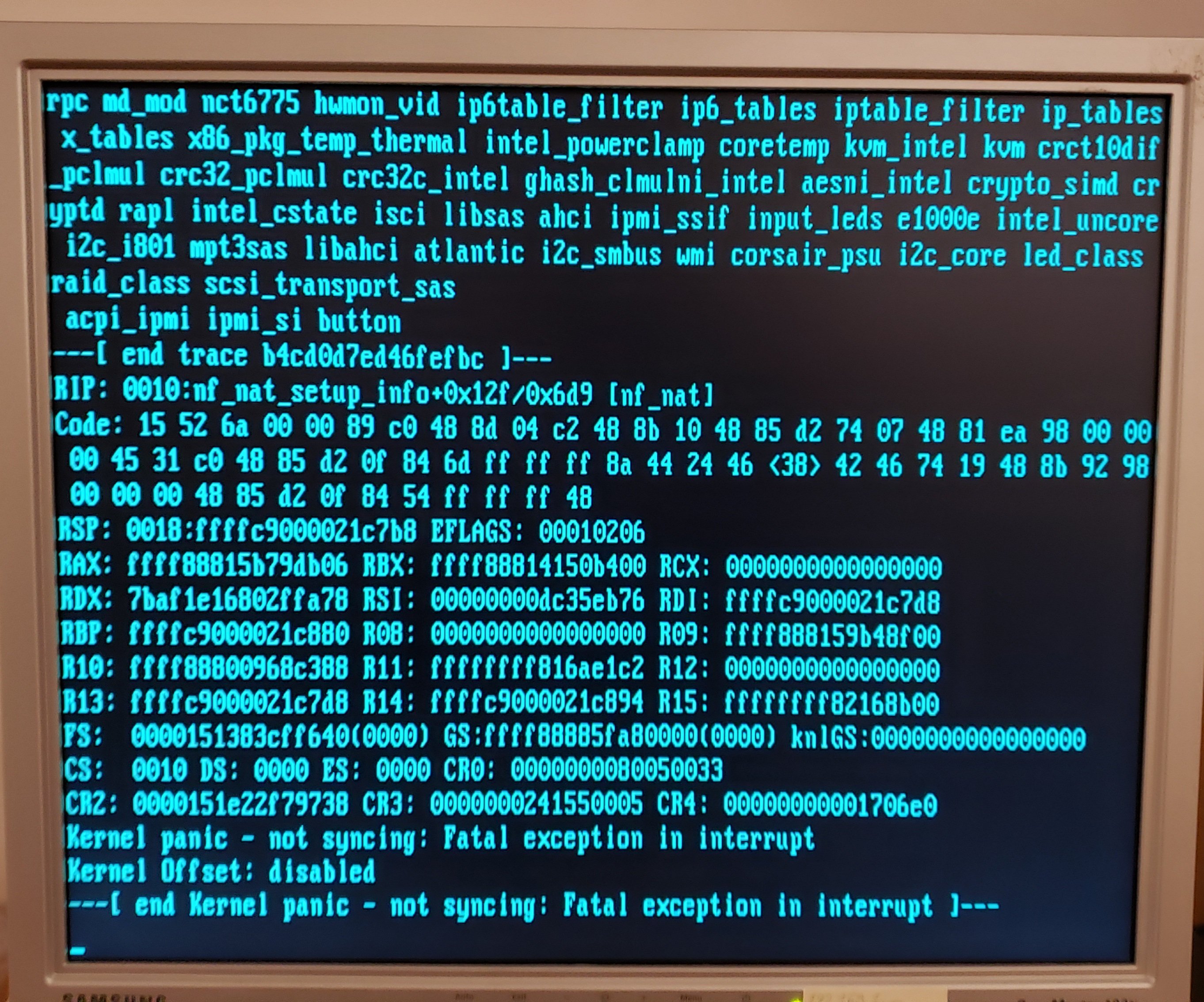

This time i have the syslog file and i did a screen shot of the monitor attache to the server.
hope you will have everything needed to help me...

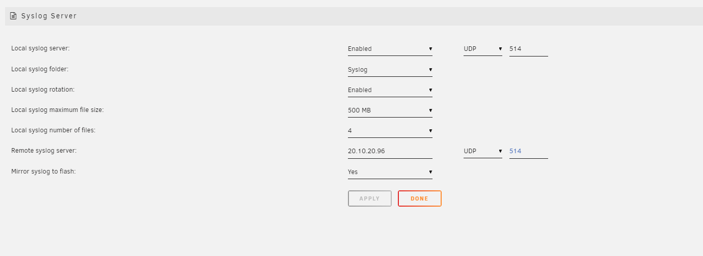

i made a folder for all syslog and put it on an other server.

The "regular" syslog is in RAM and so doesn't survive reboot after crash, so the need for syslog server. Syslog server only captures the syslog during the times it is active.
well then i do have a big problem, because when the server crash, i cant do anything with it..
i tried ssh, log in, but it's totaly frozen, and the only thing i can do is a cold shut down with the power button for 5sec.
so... if so, i will never get that log?

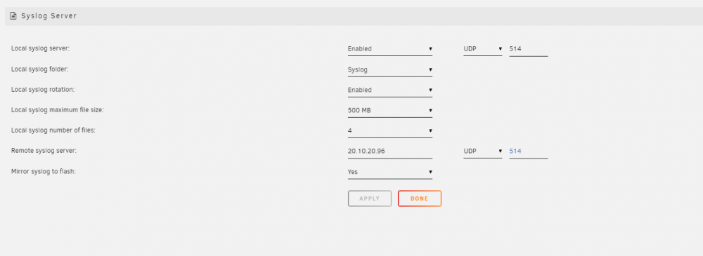

If you setup syslog server and have it running, then it will save syslog wherever you have it configured to save it, and then after crash, you can get that syslog and post it.
Ok cool, i did setup as the screenshot in the previous post, if this is good, then the next crash, i will have it up until the crash, i hope it will be enough.

Macvlan call traces are usually the result of having dockers with a custom IP address, upgrading to v6.10 and switching to ipvlan might fix it (Settings -> Docker Settings -> Docker custom network type -> ipvlan (advanced view must be enable, top right)), or see below for more info.
https://forums.unraid.net/topic/70529-650-call-traces-when-assigning-ip-address-to-docker-containers/
See also here:
https://forums.unraid.net/bug-reports/stable-releases/690691-kernel-panic-due-to-netfilter-nf_nat_setup_info-docker-static-ip-macvlan-r1356/
Hi, and thanks for the fast respond...
i just switch to ipvlan and now have to re-install all the docker to the vland.
Thanks for your help guy's.

p.s. my server did not freeze since JorgeB pointed me to the Macvlan problem, so i switch to ipvlan, and so far it's good... Thanks
