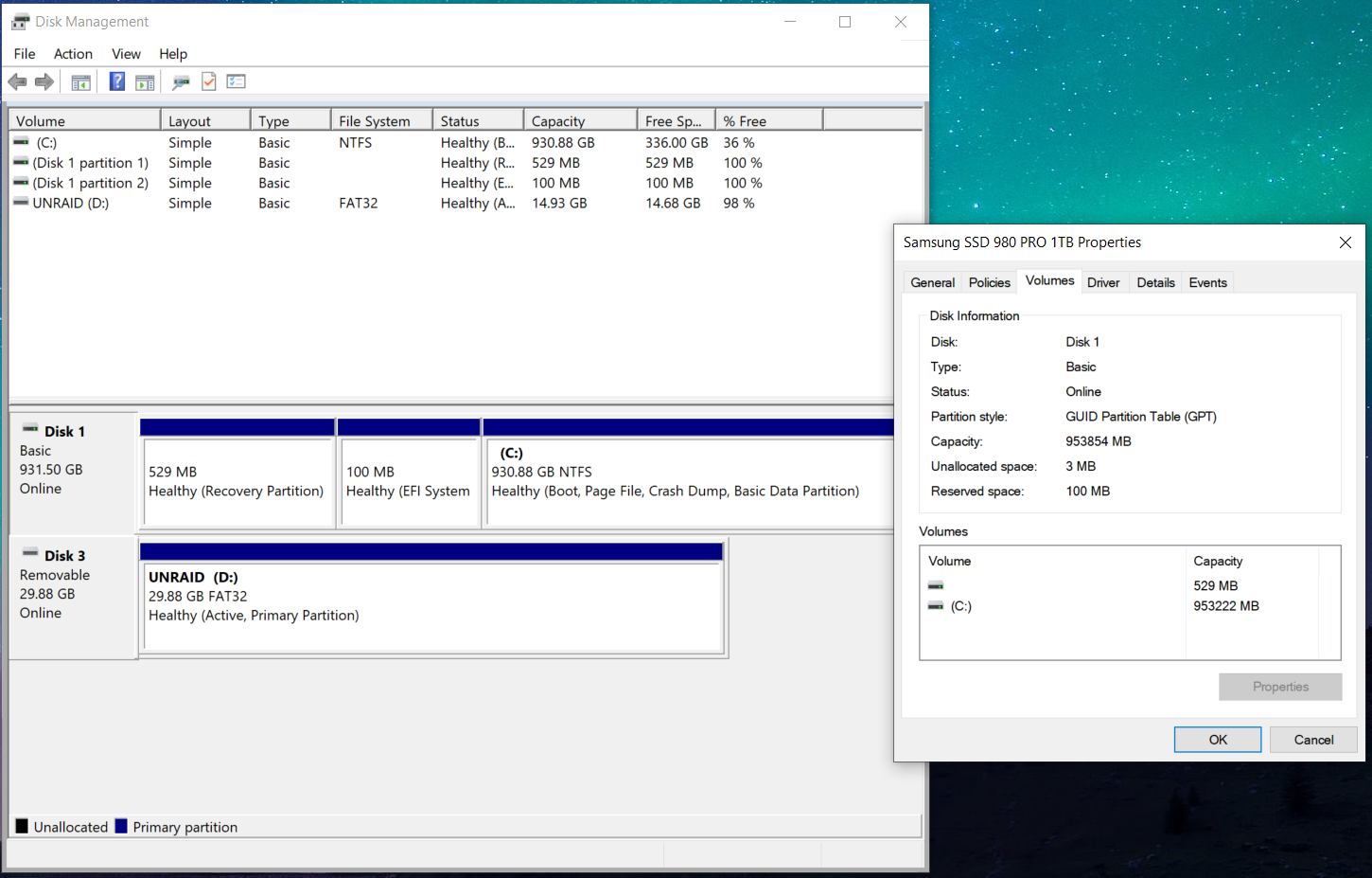

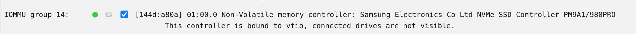

My disk layout screenshot and IOMMU group information for the NVMe controller are attached.
