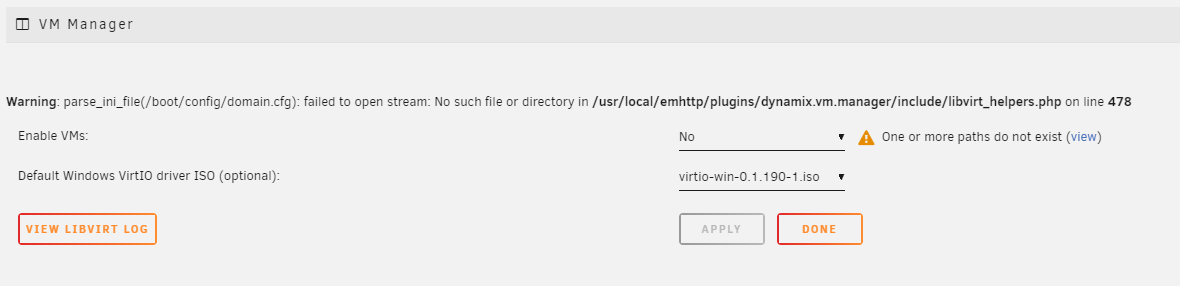

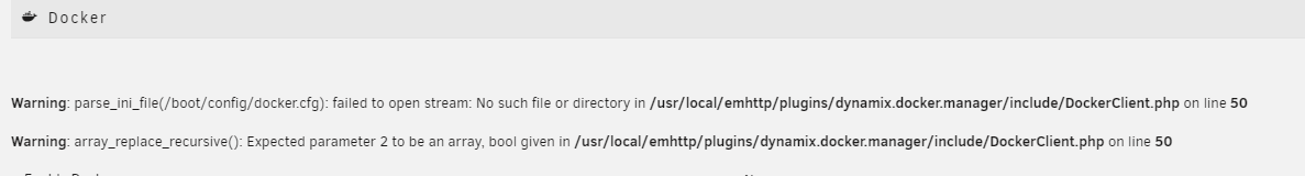

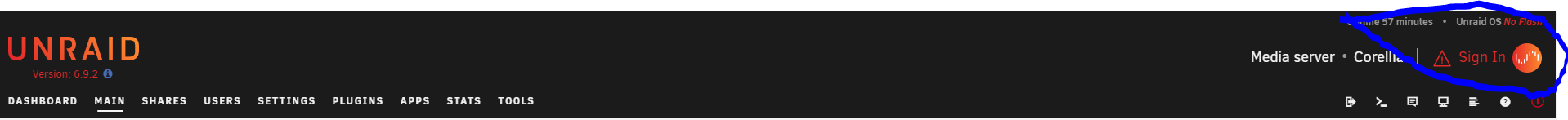

My server was up for about 45 min running a few dockers and one Win10 baremetal VM, did a CA plugin update and nothing else, switched to the VM tab and after more than usual time to load it returned and error, reset the whole UI and now my cache pool is gone, the VM still runs (i'm writing from it) and both Dockers and VM tabs are gone i assume because the systems is missing the cache pool.
I can't sign in and there is a No Flash message in the upper right corner
Unraid flash drive is present

Docker settings shows this error:
VM Manager
Dockers and VM folders plus Appdata are stored in the missing cache pool.
Flash drive dropped offline, make sure you're using a USB 2.0 port.
It is on a USB 3.1 Gen2 port, the 2.0 ports are passthrough my win VM.

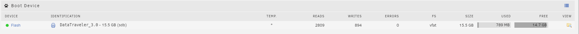

Plugged the flash on the same USB port that it was before and it started mostly normal, dockers and VMs running and all drives present but showing warning: USB drive is not read-write and running parity check.
After some search on the forums and thinking that could be an USB flash dying issue  I decided to restore the MyServers backup from this morning, started Unraid with the new USB flash, reset users pwd and activated key, now the server seams to be running normal, like nothing happened at all.
