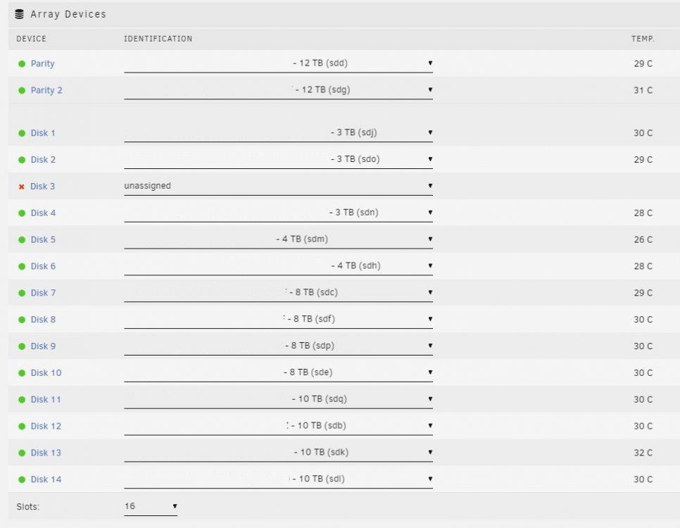

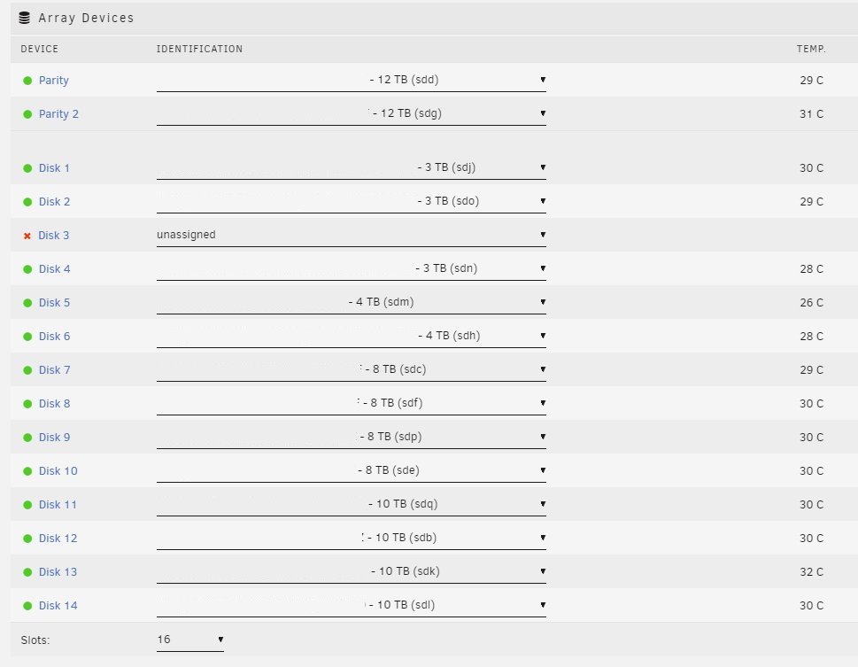

What I did:
- I added #13 and #14 to the array
- I "somehow" removed #03 from the pool and UNRAID is now showing drive is in "error state: no device identification"
> When I try to add #03 to the array again, UNRAID identifies the drive as "new device" and wants to overwrite it.
What I want to do:
I want to remove #03 and rebuild parity, but I don't know how?!
Do I have to use the new config procedure for this? Which boxes do I have to tick?
Thank you for your precious help!

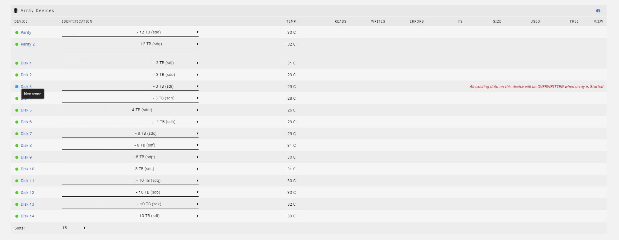

What do you mean by showing the correct content?
The drive is showing up, but when I want to add it, UNRAID wants to overwrite it.
Here are two screenshots
Edited by dan_raid

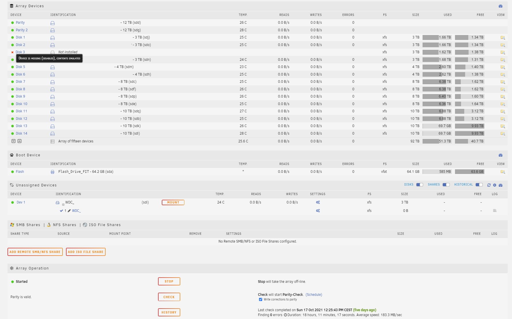

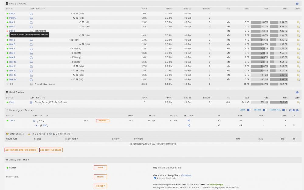

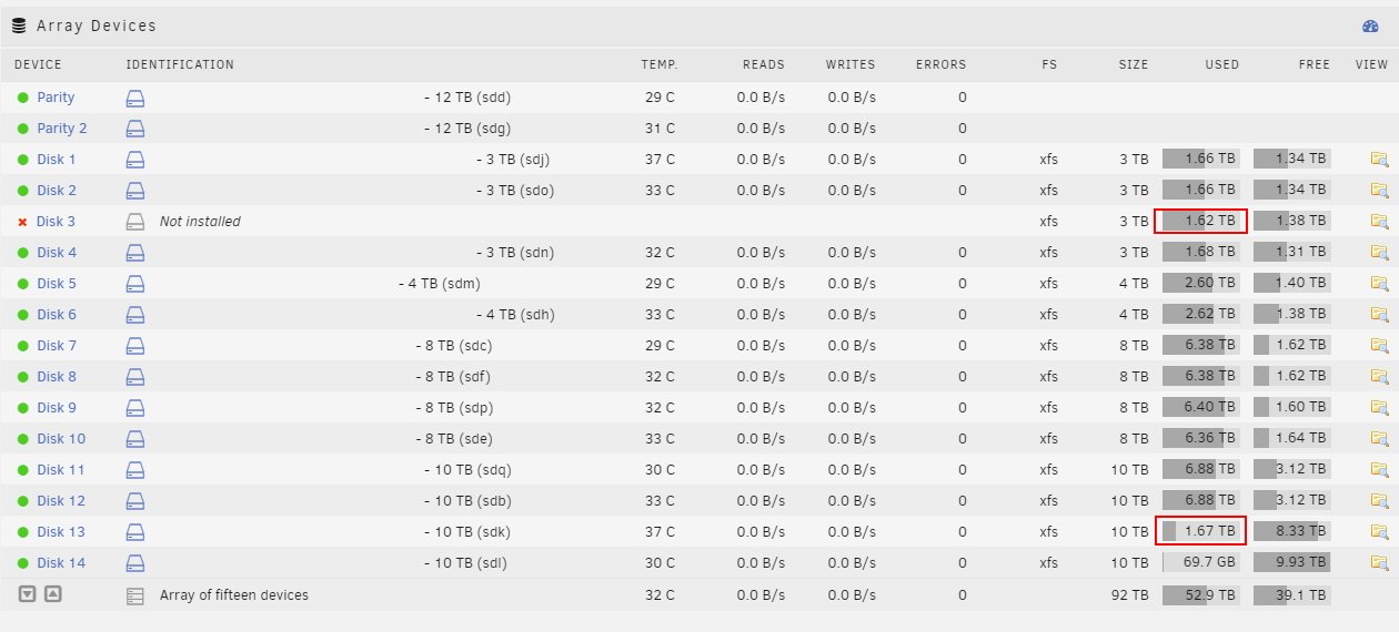

When you start the array without adding the drive, and leave it unassigned, does it mount and show the contents?
When I start the array the drive is listed as missing / not installed.
The contents of it are emulated.
Here is a screenshot:
From this point I want to remove drive #03 and rebuild parity, but I do not know how.

I ran both commands, after the last one I received the following message:
For me it looks like everything is fine. I am right?
That part looks good. If you click on the "view" folder on the far right of the main GUI screen for disk 3 and disk 13 and compare, do they look identical? Does disk 13 now show 1.62 TB used instead of 69.7 GB?
I checked the overall folder structure and it looks similiar.
Disk #03 has 1,62TB and Disk #13 now has 1,67TB.
Good!
Hopefully it's not just similar, but identical.
The commands you ran first copied, then compared what was copied, and no differences were noted, so you should be fine there.

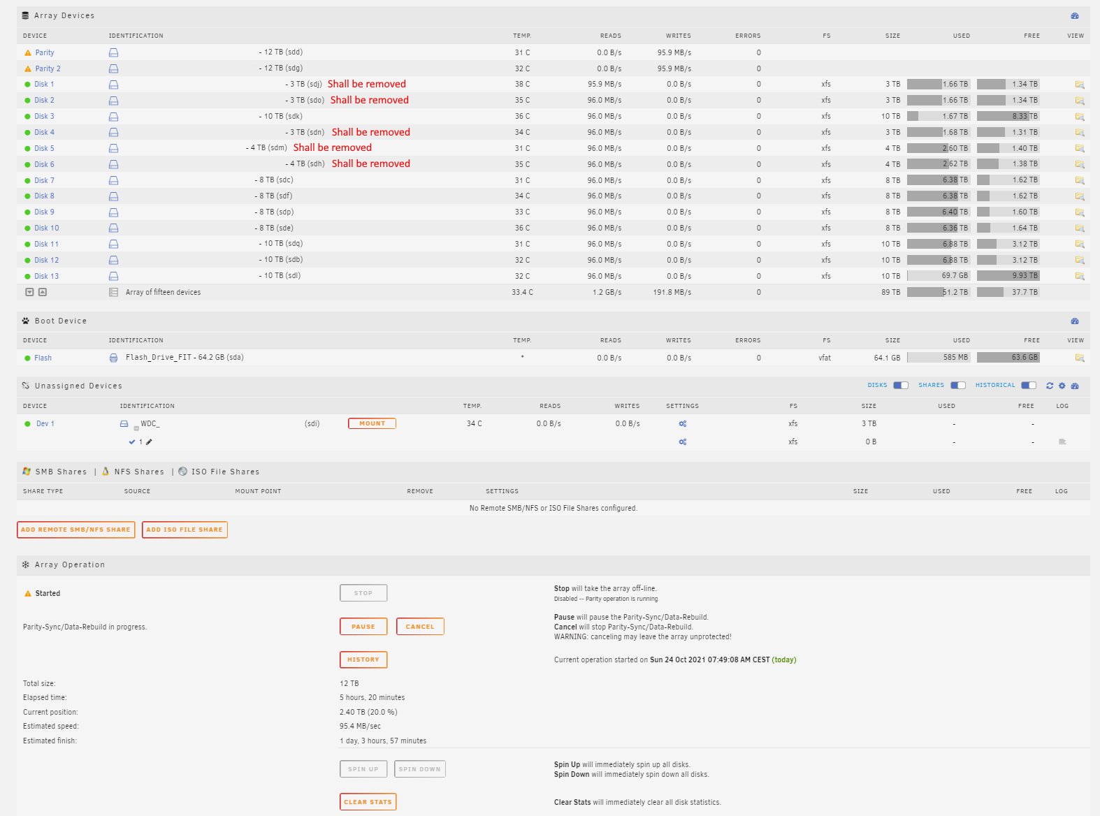

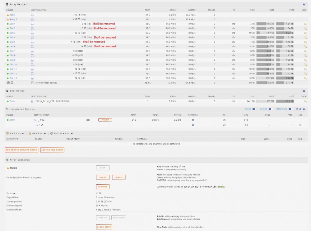

I followed your steps and parity sync is running:
After this step I want to remove disks #01, #02, #04, #05 and #06 (as marked in the screenshot above).
Is the best way to repeat the steps from above?
rsync -arv /mnt/disk1/ /mnt/disk3
rsync -narcv /mnt/disk1/ /mnt/disk3
rsync -arv /mnt/disk2/ /mnt/disk3
rsync -narcv /mnt/disk2/ /mnt/disk3
rsync -arv /mnt/disk4/ /mnt/disk3
rsync -narcv /mnt/disk4/ /mnt/disk3
rsync -arv /mnt/disk5/ /mnt/disk13
rsync -narcv /mnt/disk5/ /mnt/disk13
rsync -arv /mnt/disk6/ /mnt/disk13
rsync -narcv /mnt/disk6/ /mnt/disk13
Edited by dan_raid
Yes, with some additional info.
The reason I had you specifically rearrange the drives was to put the data that had been on drive 3, back in the drive 3 slot. What you are proposing will work fine, and you can remove all the drives at once with a single new config and parity rebuild operation.
However, once you are done, the data will be on different data slot numbers. If you haven't customized any share allocation settings, that will be fine. However, if you had defined any shares to specifically use drive slots, those will need to be changed to the new drive slot numbers. Unraid by default doesn't care which data goes on which disk, but you can force it to only use certain disks, which is why I told you to put the destination disk back in slot 3. That way if you HAD customized things, they wouldn't break.
BTW, if you poke around you will find other methods of getting data from drive to drive, most involve moving instead of copying. I advocate copying for several reasons. It's faster. You can verify the copy before you make things permanent. You still have the data as a backup on the removed disk.
The biggest reason to move instead of copying is verifying all the data is on the destination if you insist on actively using the array while the file operations are taking place.
As long as you do not add or modify data while doing the copy, you won't have any issues. You can read and play files from the array during the copy with no problems.
Adding or modifying files in a user share while the copy is taking place could possibly result in the changes not transferring to the new drive.
If you are ok with not adding or modifying files on the server while you get this done, then you are good to go.
