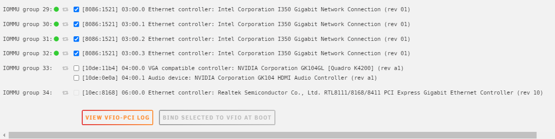

求救求助:网卡和USB直通后,打不开VM-windows
系统:6.10.0-rc1  和 6.9.0-rc2 都试过了。
HVM: Enabled
IOMMU: Enabled
直通设备:板载USB 和 四口网卡I350
直通方式: downstream & system tool 勾选,flash里面也写了代码
直通: VM里面勾选其中一个网口。
问题:再次打开VM,显示GUEST HAS NOT INITIALIZED THE DISPLAY (YET).。一直打不开,CPU全跑到100%
请问有遇到相同问题的兄弟姐妹吗?求助求助。

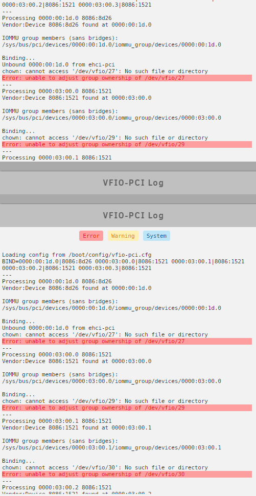

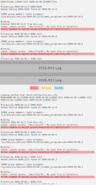

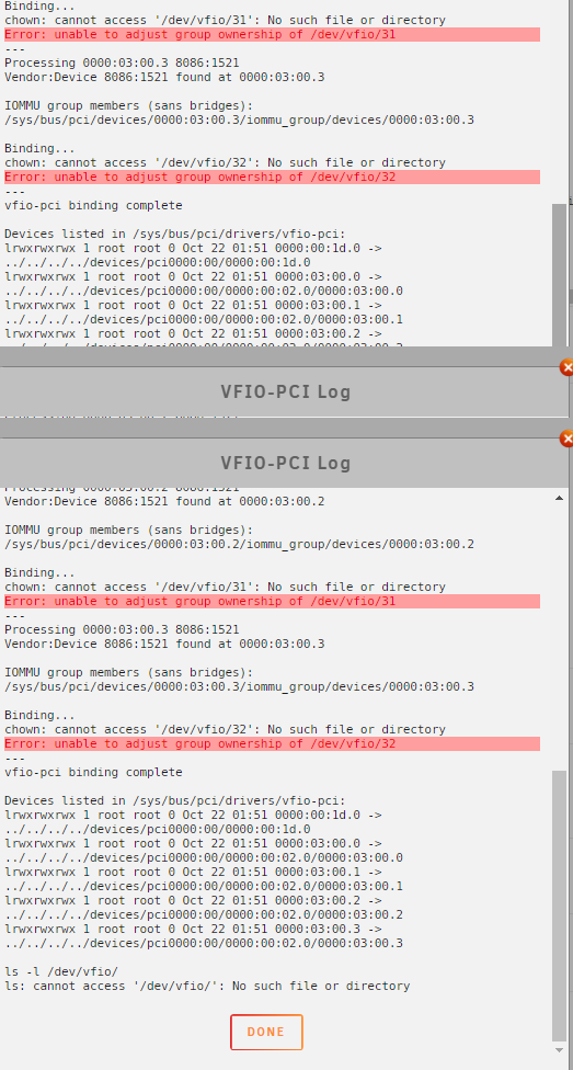

我看了一下VFIO-PCI LOG。好像说没找到。但是不知道具体是什么解决这个问题。
Loading config from /boot/config/vfio-pci.cfg
BIND=0000:00:1d.0|8086:8d26 0000:03:00.0|8086:1521 0000:03:00.1|8086:1521 0000:03:00.2|8086:1521 0000:03:00.3|8086:1521
Processing 0000:00:1d.0 8086:8d26
Vendor:Device 8086:8d26 found at 0000:00:1d.0
IOMMU group members (sans bridges):
/sys/bus/pci/devices/0000:00:1d.0/iommu_group/devices/0000:00:1d.0
Binding...
Unbound 0000:00:1d.0 from ehci-pci
chown: cannot access '/dev/vfio/27': No such file or directory
Error: unable to adjust group ownership of /dev/vfio/27
Processing 0000:03:00.0 8086:1521
Vendor:Device 8086:1521 found at 0000:03:00.0
/sys/bus/pci/devices/0000:03:00.0/iommu_group/devices/0000:03:00.0
Binding...
chown: cannot access '/dev/vfio/29': No such file or directory
Error: unable to adjust group ownership of /dev/vfio/29
Processing 0000:03:00.1 8086:1521
Vendor:Device 8086:1521 found at 0000:03:00.1
/sys/bus/pci/devices/0000:03:00.1/iommu_group/devices/0000:03:00.1
Binding...
chown: cannot access '/dev/vfio/30': No such file or directory
Error: unable to adjust group ownership of /dev/vfio/30
Processing 0000:03:00.2 8086:1521
Vendor:Device 8086:1521 found at 0000:03:00.2
/sys/bus/pci/devices/0000:03:00.2/iommu_group/devices/0000:03:00.2
Binding...
chown: cannot access '/dev/vfio/31': No such file or directory
Error: unable to adjust group ownership of /dev/vfio/31
Processing 0000:03:00.3 8086:1521
Vendor:Device 8086:1521 found at 0000:03:00.3
/sys/bus/pci/devices/0000:03:00.3/iommu_group/devices/0000:03:00.3
Binding...
chown: cannot access '/dev/vfio/32': No such file or directory
Error: unable to adjust group ownership of /dev/vfio/32
vfio-pci binding complete
Devices listed in /sys/bus/pci/drivers/vfio-pci:
lrwxrwxrwx 1 root root 0 Oct 22 01:51 0000:00:1d.0 -> ../../../../devices/pci0000:00/0000:00:1d.0
lrwxrwxrwx 1 root root 0 Oct 22 01:51 0000:03:00.0 -> ../../../../devices/pci0000:00/0000:00:02.0/0000:03:00.0
lrwxrwxrwx 1 root root 0 Oct 22 01:51 0000:03:00.1 -> ../../../../devices/pci0000:00/0000:00:02.0/0000:03:00.1
lrwxrwxrwx 1 root root 0 Oct 22 01:51 0000:03:00.2 -> ../../../../devices/pci0000:00/0000:00:02.0/0000:03:00.2
lrwxrwxrwx 1 root root 0 Oct 22 01:51 0000:03:00.3 -> ../../../../devices/pci0000:00/0000:00:02.0/0000:03:00.3
ls -l /dev/vfio/
ls: cannot access '/dev/vfio/': No such file or directory

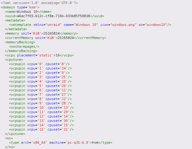

机器不是越新越好,要匹配你的实体机,把硬件和虚拟机配置贴出来看看。
明白。请看下配置

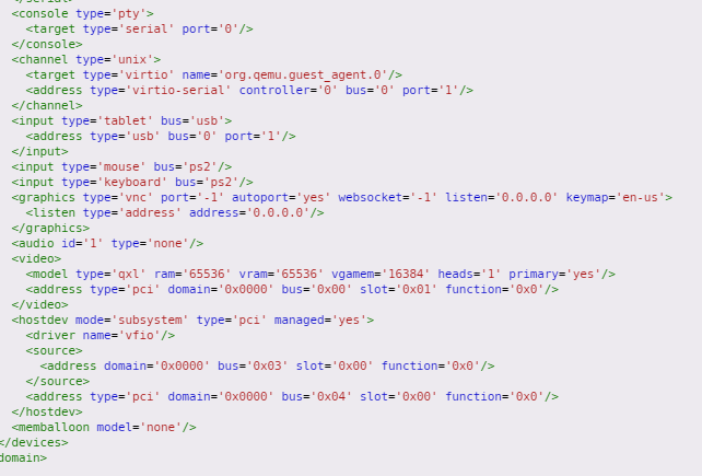

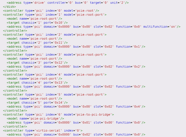

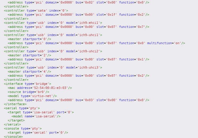

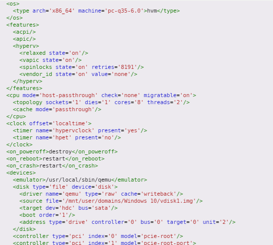

<domain type='kvm'>
  <name>Windows 10</name>
  <uuid>a6ac7f03-b12c-cf8e-716b-033b85f50838</uuid>
  <metadata>
  </metadata>
  <memory unit='KiB'>25165824</memory>
  <currentMemory unit='KiB'>25165824</currentMemory>
  <memoryBacking>
    <nosharepages/>
  </memoryBacking>
  <vcpu placement='static'>16</vcpu>
  <cputune>
    <vcpupin vcpu='0' cpuset='8'/>
    <vcpupin vcpu='1' cpuset='24'/>
    <vcpupin vcpu='2' cpuset='9'/>
    <vcpupin vcpu='3' cpuset='25'/>
    <vcpupin vcpu='4' cpuset='10'/>
    <vcpupin vcpu='5' cpuset='26'/>
    <vcpupin vcpu='6' cpuset='11'/>
    <vcpupin vcpu='7' cpuset='27'/>
    <vcpupin vcpu='8' cpuset='12'/>
    <vcpupin vcpu='9' cpuset='28'/>
    <vcpupin vcpu='10' cpuset='13'/>
    <vcpupin vcpu='11' cpuset='29'/>
    <vcpupin vcpu='12' cpuset='14'/>
    <vcpupin vcpu='13' cpuset='30'/>
    <vcpupin vcpu='14' cpuset='15'/>
    <vcpupin vcpu='15' cpuset='31'/>
  </cputune>
  <os>
    <type arch='x86_64' machine='pc-q35-6.0'>hvm</type>
  </os>
  <features>
    <acpi/>
    <apic/>
    <hyperv>
      <relaxed state='on'/>
      <vapic state='on'/>
    </hyperv>
  </features>
    <topology sockets='1' dies='1' cores='8' threads='2'/>
    <cache mode='passthrough'/>
  </cpu>
  <clock offset='localtime'>
  </clock>
  <on_crash>restart</on_crash>
  <devices>
      <source file='/mnt/user/domains/Windows 10/vdisk1.img'/>
      <target dev='hdc' bus='sata'/>
      <boot order='1'/>
      <address type='drive' controller='0' bus='0' target='0' unit='2'/>
    </disk>
    <controller type='pci' index='0' model='pcie-root'/>
    <controller type='pci' index='1' model='pcie-root-port'>
      <model name='pcie-root-port'/>
      <target chassis='1' port='0x10'/>
      <address type='pci' domain='0x0000' bus='0x00' slot='0x02' function='0x0' multifunction='on'/>
    </controller>
    <controller type='pci' index='2' model='pcie-root-port'>
      <target chassis='2' port='0x11'/>
      <address type='pci' domain='0x0000' bus='0x00' slot='0x02' function='0x1'/>
    </controller>
    <controller type='pci' index='3' model='pcie-root-port'>
      <target chassis='3' port='0x12'/>
      <address type='pci' domain='0x0000' bus='0x00' slot='0x02' function='0x2'/>
    </controller>
    <controller type='pci' index='4' model='pcie-root-port'>
      <target chassis='4' port='0x13'/>
      <address type='pci' domain='0x0000' bus='0x00' slot='0x02' function='0x3'/>
    </controller>
    <controller type='pci' index='5' model='pcie-root-port'>
      <target chassis='5' port='0x14'/>
      <address type='pci' domain='0x0000' bus='0x00' slot='0x02' function='0x4'/>
    </controller>
    <controller type='pci' index='6' model='pcie-to-pci-bridge'>
      <model name='pcie-pci-bridge'/>
      <address type='pci' domain='0x0000' bus='0x01' slot='0x00' function='0x0'/>
    </controller>
      <address type='pci' domain='0x0000' bus='0x02' slot='0x00' function='0x0'/>
    </controller>
      <address type='pci' domain='0x0000' bus='0x00' slot='0x1f' function='0x2'/>
    </controller>
    </controller>
      <master startport='0'/>
    </controller>
      <master startport='2'/>
    </controller>
      <master startport='4'/>
    </controller>
    <interface type='bridge'>
      <mac address='52:54:00:81:e3:03'/>
      <source bridge='br0'/>
      <model type='virtio-net'/>
      <address type='pci' domain='0x0000' bus='0x03' slot='0x00' function='0x0'/>
    </interface>
    <serial type='pty'>
        <model name='isa-serial'/>
      </target>
    </serial>
    <console type='pty'>
    </console>
    <channel type='unix'>
    </channel>
    </input>
    <graphics type='vnc' port='-1' autoport='yes' websocket='-1' listen='0.0.0.0' keymap='en-us'>
    </graphics>
    <audio id='1' type='none'/>
    <video>
      <address type='pci' domain='0x0000' bus='0x00' slot='0x01' function='0x0'/>
    </video>
      <driver name='vfio'/>
      <source>
        <address domain='0x0000' bus='0x03' slot='0x00' function='0x0'/>
      </source>
      <address type='pci' domain='0x0000' bus='0x04' slot='0x00' function='0x0'/>
    </hostdev>
    <memballoon model='none'/>
  </devices>
</domain>
我估计是直通网卡没成功,尽量不要自己修改flash vfio-pci.cfg,就算勉强直通,也不稳定 。unraid~工具~系统设备抓图看看,直通网卡那块。虚拟机配置抓图,看模板费劲。

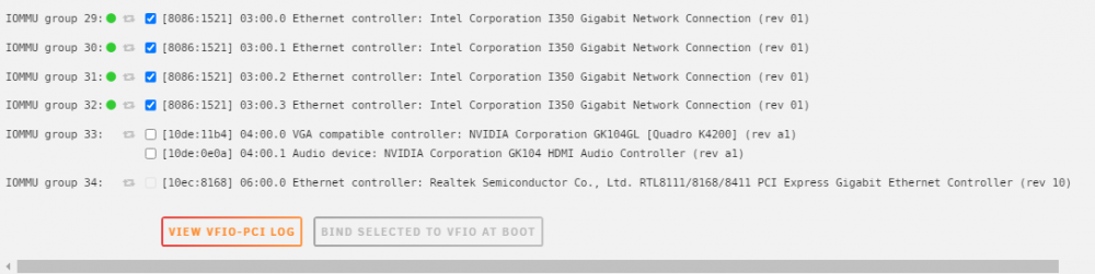

给。感谢帮忙!
HVM: Enabled
IOMMU: Enabled
应该是直通网卡没有开启成功,是分组了,也打了勾,但信息显示这几个组没有正确开启,试试把虚拟机设置里面PCIe ACS 覆盖选择both,另外把不安全中断也打勾,重启看看。可行的话再取消不安全中断试试。
另外你的服务器硬件是什么,IOMMU分组数怎么这么多,抓整个系统设备图看看,
