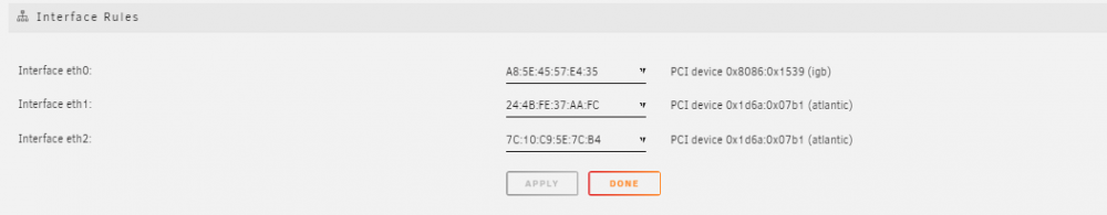

Both are the Asus cards 10 gig network cards, plugged into my bottom pcie slots on the board on the unraid server. Not using onboard eithernet port. I tried bonding eth0 eth1 and eth2.  1 and 2 are the Asus cards.  On the bottom for the order of the connections I put etho, then both Atlantic (Asus cards)  I have the same Asus card plugged into my desktop board.  I have been leaving the 1 gig Ethernet plugged in on the desktop so I can keep connected to the server Web Gui. Once I get it working not sure if I need the 1g connection.  $orry for missing info. If you need more please let me know.  Thank you appreciate it.
OK, that*s the important info, as we talk about changing things, the enumeration is important so we are in sync here.
Do you also have as separate Switch or is the ISP-Box you are referring to also equipped with several LAN ports?
Where is the 1G connection of your desktop plugged into?
Does the ISP-Box or seperate Switch also have a second 10G port available?
The "problem" is, that you will be running both 10G cards of unraid in the same IP-network. Your Desktop, with both 1G & 10G plugged in will acquire two IP-Addresses and you need to tell it how to decide which one the two to use when connecting unRaid.

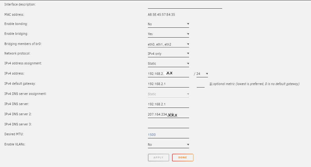

38 minutes ago, Badboy said:
Just the ISP Box. No router connected. I'm going through your steps right now.
Here's the settings I just used. Didn't work.  Unraid's UI wouldn't even load.
Settings looks OK.
So, when you did not get to unraid UI, the situation was setup like this...
  • in unraid eth1 was connected to ISP-box (10G)
  • in unraid eth2 was connected to desktop (10G)
  • in unraid eth0 (1g) was disconnected from ISP-box
  • in desktop, 1G was disconnected from ISP-box
Did you reboot your desktop?
Did you try to ping the unraid IP from your desktop?
What is the output from a "arp -a" command from commandline on your desktop?
When you (leave unraiud bridge settings as shown in your pic)
  • connect desktop 1G and unraid eth0 (1G) zu your isp-box
  • *and* disconnect 10G from desktop and eth1 (10G) from unraid....
...does that work?
If so, will it still work, when
  • you disconnect the 1G from desktop
  • connect desktop 10G to isp-box (so unraid only connected with eth0/1G)

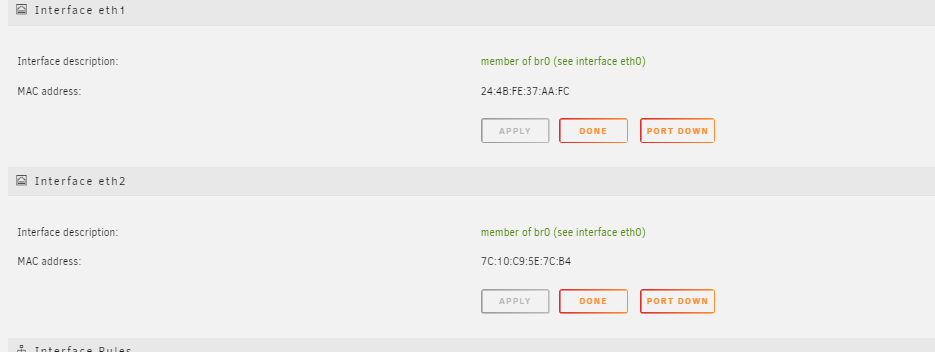

34 minutes ago, Badboy said:
There is no cable in the motherboard ethernet port. Not sure why Eth0 is showing.
Because the card/NIC has a loaded driver...if there is a cable or not does not matter.

It will only do that if there is a cable connected, i think...is there and is the other end of that cable connected to your desktop?
strange, that is does not show a link.
No, it is a bridged setup...all ports are interconnected, like with a switch.

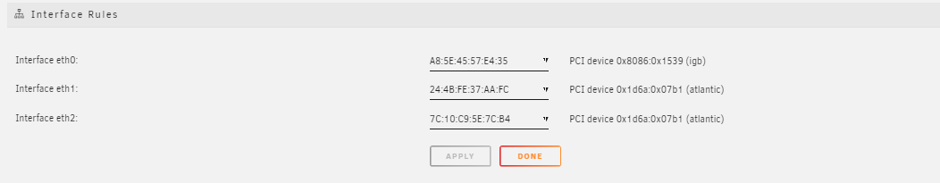

  • still disbale bond mode, enable bridge mode
  • change the numbering, so that eth1 10G is connected to your ISP-box.
  • remove eth0 and eth2 from the bridge
  • connect the new eth1 10G to isp-box
  • disconnect eth0 and eth2 from unraid
  • connect 1G of desktop to ISP box.
...does this work?
Change / swap eth1 for eth2.... so we can test the second 10G card in unraid this way
Then swap 10G to 1G on unraid (remove eth1 and eth2 from bridge, add eth0 to bridge) and ISP-Box and connect desktop with 10G to isp-box (disconnect its 1G)
Does this still work?

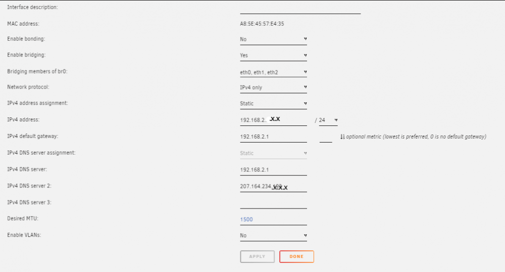

On the back of the server I switched the cables eth1 and eth2 around.  Server still had internet. Both those cards are working. Just can't seem to get the connection from the desktop to one of those cards to work.
I don't have a cable into Eth0, switch is the motherboard port. Would that make a difference?
Edited by Badboy
...so this is in bridge-mode only (no bonding) in unraid?
In that case, you might have a problem with your desktop, finding the correct IP-Route.
In your desktop, what is the output of the following commands when entered into a commandline shell:
  • ipconfig
  • route print -4
Also, please post your unRaid diagnostics.zip
...depends.
