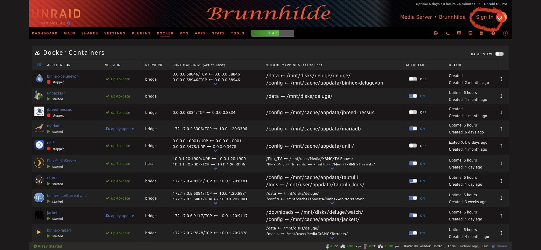

I don’t think this is much of an issue but when I login to my server on my iphone the status shows that the server is not logged in. Clicking the link and logging in doesn’t change the status.
The status displays correctly on desktop browsers.

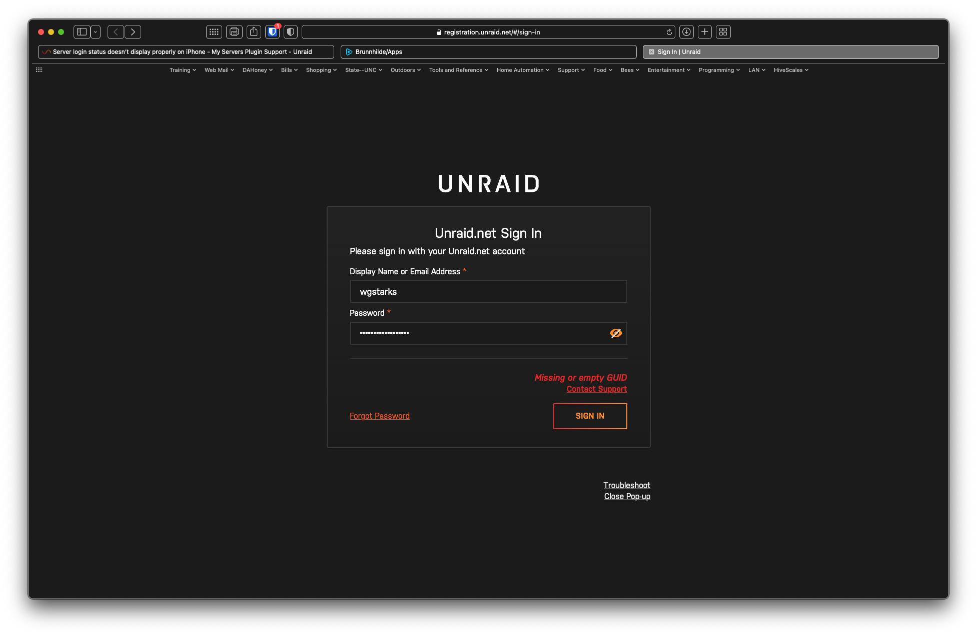

Ok. I uninstalled then reinstalled from CA. Now I am presented with this screen but sign fails-
1704885254_ScreenShot2021-10-24at4_56_01PM.thumb.png.e87b83f9dad154af7e578fe1d93b7654.png
I have verified that the credentials are correct.
