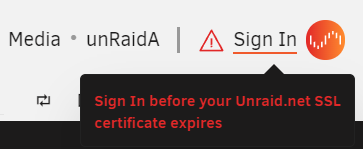

October 24, 20214 yr @ljm42 Noticed that one of my servers wasn't signed in (shouldn't it automatically renew anyways?) Signing in doesn't do anything and just brings back the same thing. If I go to Settings - Management settings, the page just continually reloads and doesn't let me do anything 6.10-rc2h
October 24, 20214 yr Just noticed the same problem here, i noticed my server wasn't showing as signed in, so i try the sign in and after closing the sign in window the main window looks the same, i'm not signed in. Tried clearing cookies and reloading the page. Tried it in Edge browser which i've never used for Unraid before and it was the same issue. Unraid v6.9.2 Edited October 24, 20214 yr by BadBunny
October 24, 20214 yr I found the same thing, but after removing and reinstalling the plugin, everything worked again. Just had to reenable the flash drive backups in the settings.
October 24, 20214 yr Try removing and reinstalling the My Servers plugin then signing in again. I suspect there might be a bug with the API portion. If this doesn't work after you sign in again please direct message me the output of this terminal command (this will contain apikeys so we don't want to share publicly) cat /boot/config/plugins/dynamix.my.servers/myservers.cfg This will let me know if the server is correctly storing your sign in status. If your info is correctly there then the issue is stemming from a backend bug – where it's overwriting the sign in status cached on the server with incorrect info. Particularly on the Management Access page we have data watchers to refresh the page after sign in / out to ensure the settings shown are correct. So the bug is triggering that to constantly happen.
