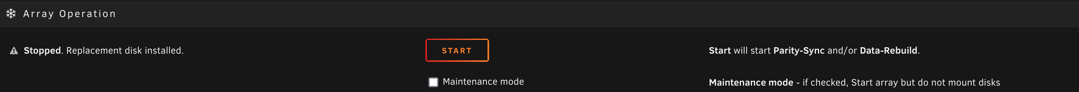

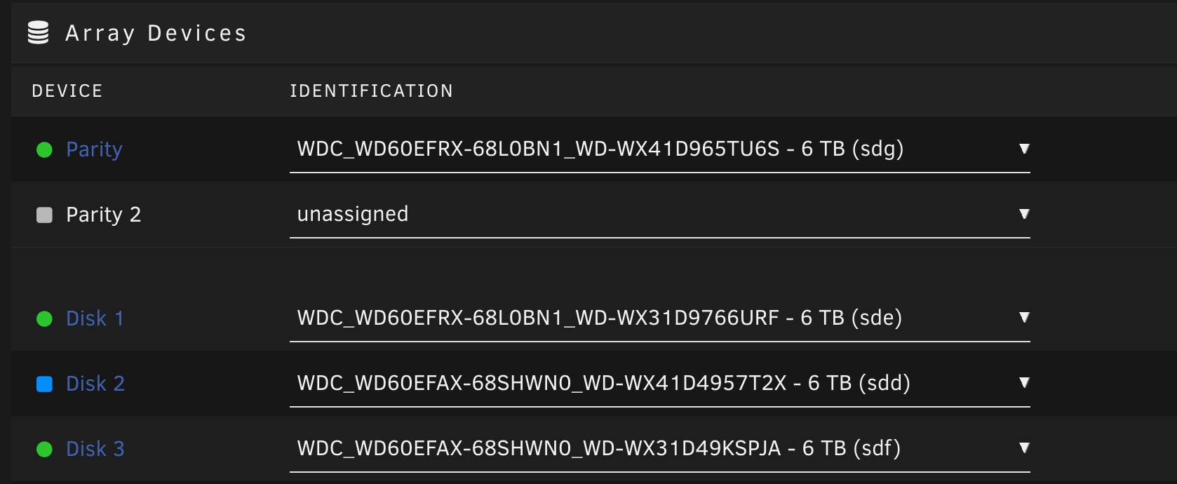

I have also another question/idea: Since i replaced disk2 because i thought it's the failed disk and because i didn't erase the old disk yet, i would like to put it back in. Is Unraid going to erase all data on this disk and rebuild it or is it going to sync parity only when i start the array?
1942814652_Bildschirmfoto2021-10-25um15_38_44.thumb.png.686b08ff3cbd22b8caf894e68d946e8d.png1679200688_Bildschirmfoto2021-10-25um15_39_17.thumb.png.941a35073d28ee0992904a0fd885c811.png
The reason i want to do this, is to get back the old hdd setup and perform tour solution mentioned above or maybe there is a way to enable disk2 and replace disk1 without any data loss.
Edited by parazit
You need to do a new config and re-sync parity, or it will be erased.
