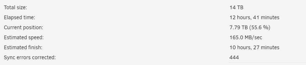

As i have restarted everything I wanted to run the parity check again, to see if my 426 parity errors disapperard and were fixed.
At this time i am at ~ 45% of parity checking and there were 374 errors found until this point. How could this be??
Why has the parity check before my reboot not fixed these 426 errors?
Should I be worried, that there are more problems, which caused these parity errors not getting corrected?

24 minutes ago, greenflash24 said:
To my surprise there were a lot of parity errors found (>200 parity errors),
Perfectly normal, up to a few thousand can be normal, depends if the array was writing during the shutdown.
Auto-parity check after an unclean shutdown is always non correct.
Okay, good to know that. I thought i have stopped the automatic parity check and restarted it with "correct parity" option enabled.
Is there a way to see wether the last parity check was run with the "correct parity" option enabled or not?

Nov  7 03:45:01 Home-Server kernel: md: recovery thread: PQ corrected, sector=11251872560
Nov  7 03:52:29 Home-Server kernel: md: recovery thread: PQ corrected, sector=11386424240
Nov  7 03:53:21 Home-Server kernel: md: recovery thread: PQ corrected, sector=11401817800
Nov  7 03:53:30 Home-Server kernel: md: recovery thread: PQ corrected, sector=11404475304
Nov  7 03:55:52 Home-Server kernel: md: recovery thread: PQ corrected, sector=11446669072
Nov  7 03:58:29 Home-Server kernel: md: recovery thread: PQ corrected, sector=11493457136
Nov  7 03:59:26 Home-Server kernel: md: recovery thread: PQ corrected, sector=11510510632
Nov  7 04:01:46 Home-Server kernel: md: recovery thread: PQ corrected, sector=11551985920
Nov  7 04:03:01 Home-Server kernel: md: recovery thread: PQ corrected, sector=11574569616
Nov  7 04:05:30 Home-Server kernel: md: recovery thread: PQ corrected, sector=11619463408
Nov  7 04:14:06 Home-Server kernel: md: recovery thread: PQ corrected, sector=11775728160
Nov  7 04:17:55 Home-Server kernel: md: recovery thread: PQ corrected, sector=11845403800
Nov  7 04:26:48 Home-Server kernel: md: recovery thread: PQ corrected, sector=12005106232
Nov  7 04:33:24 Home-Server kernel: md: recovery thread: PQ corrected, sector=12122775560
Nov  7 04:38:49 Home-Server kernel: md: recovery thread: PQ corrected, sector=12219312464
There I see "corrected"!
So shouldn't these errors be corrected by the first parity check, which was according to the syslog indeed a correcting check.
Also now until this point there are more sync errors found (and corrected ??) as in the last parity check:
Maybe there are other issues which caused these parity invalidations 🤔
But what could these be?
Edited by greenflash24
Yes, it was a correcting check, run two consecutive correcting checks without rebooting, if the second one still finds errors there's likely a hardware issue, most commonly is bad RAM, but could also be controller/disc related.
Not with stock Unraid unless you still have the syslog available covering that period.  If you have the Parity Check Tuning plugin installed then the parity history shows extra information including the type of check that was run.
