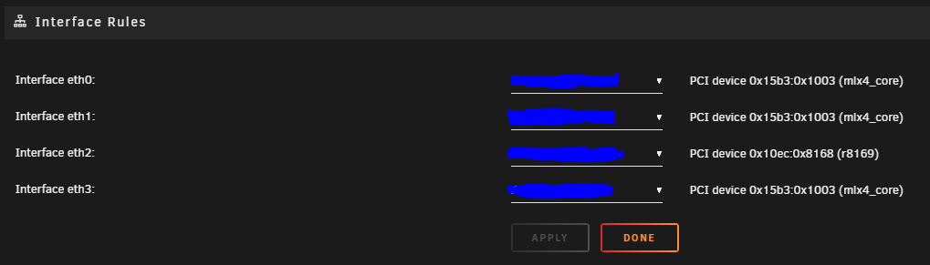

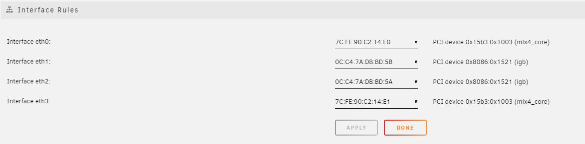

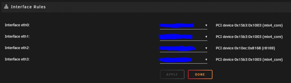

A few issues are present, being:
- network interface assignments changed.
On Unraid1 I have eth0, eth1, eth2 and also eth3(?) yet I only should have 3 physical interfaces.
On Unraid2 I'm getting eth0, eth2, and eth3. I'm not sure where eth1 has been skipped.
- duplicate entries in the network-rules.cfg file.
On Unraid1, I'm seeing 4 entries in config for the rules (eth0 to eth3) but still show 3 physical interfaces. This causes an apparently known issue where I am unable to edit the "interface rules" in the network setting GUI. I have to go back to the network-rules.cfg file, delete one of the entries and back to the GUI. This reoccurs after each reboot.

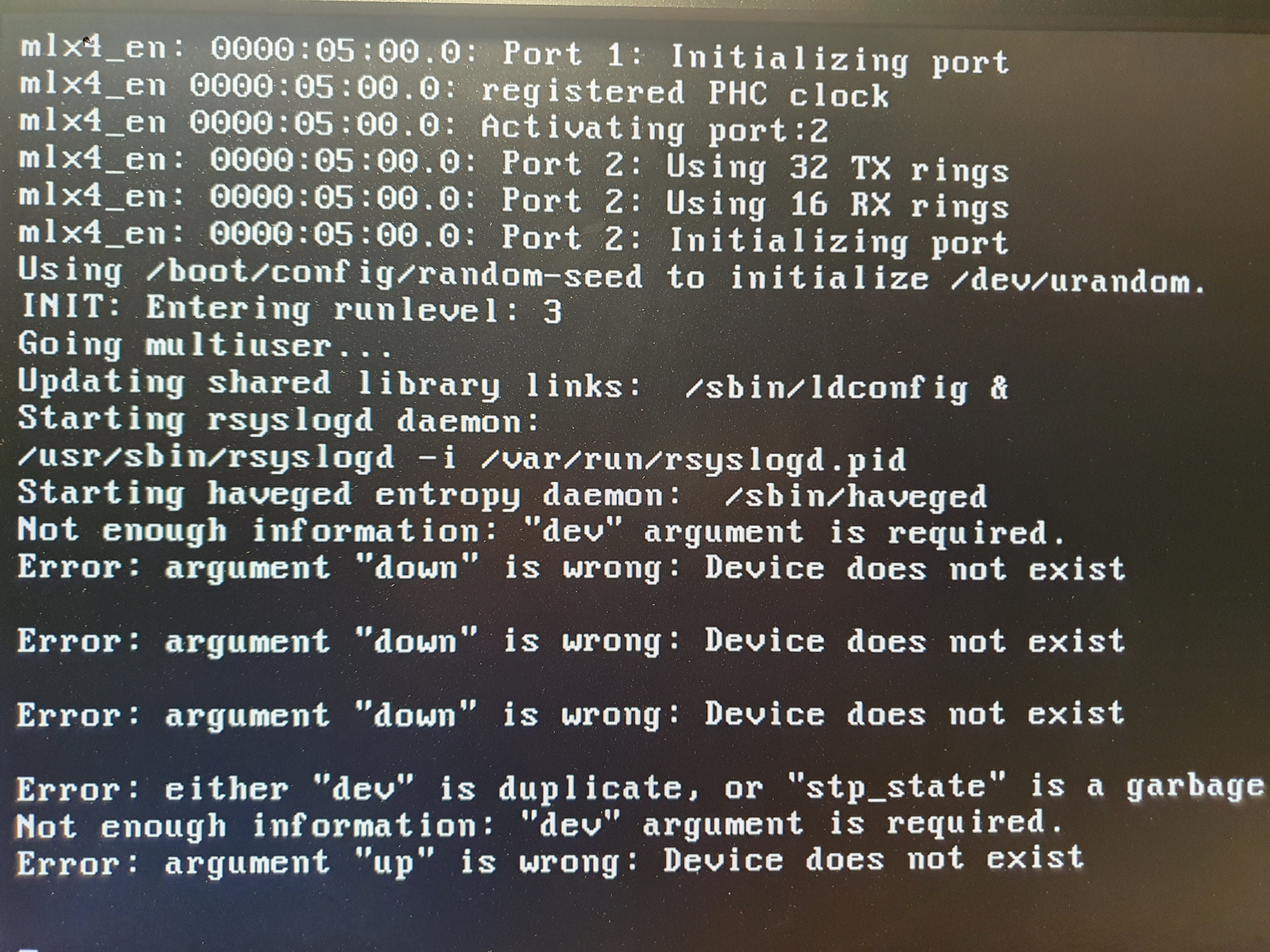

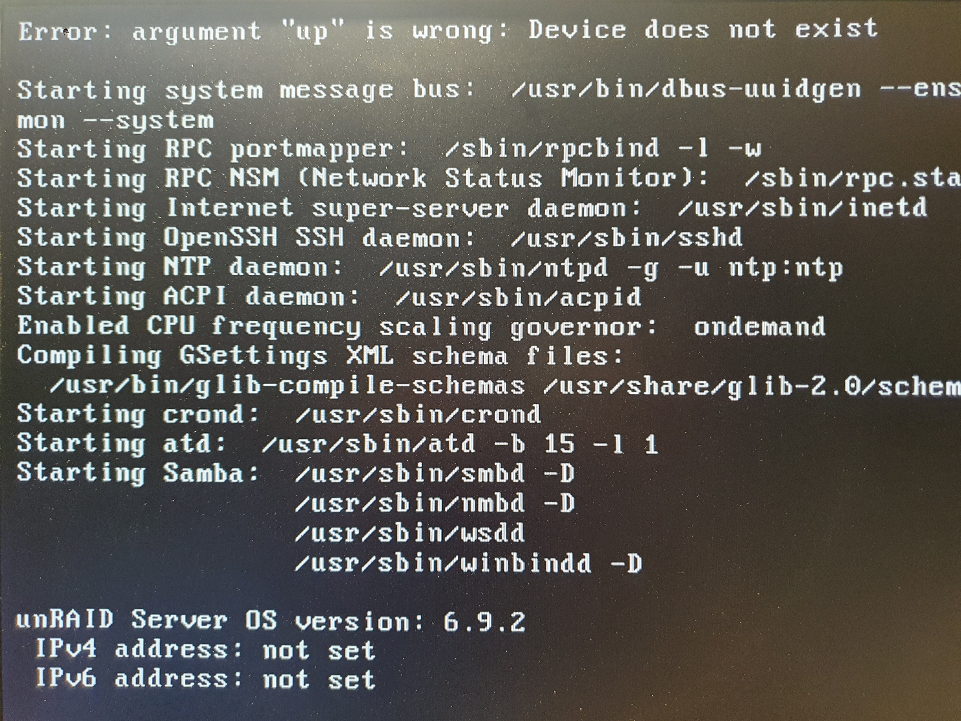

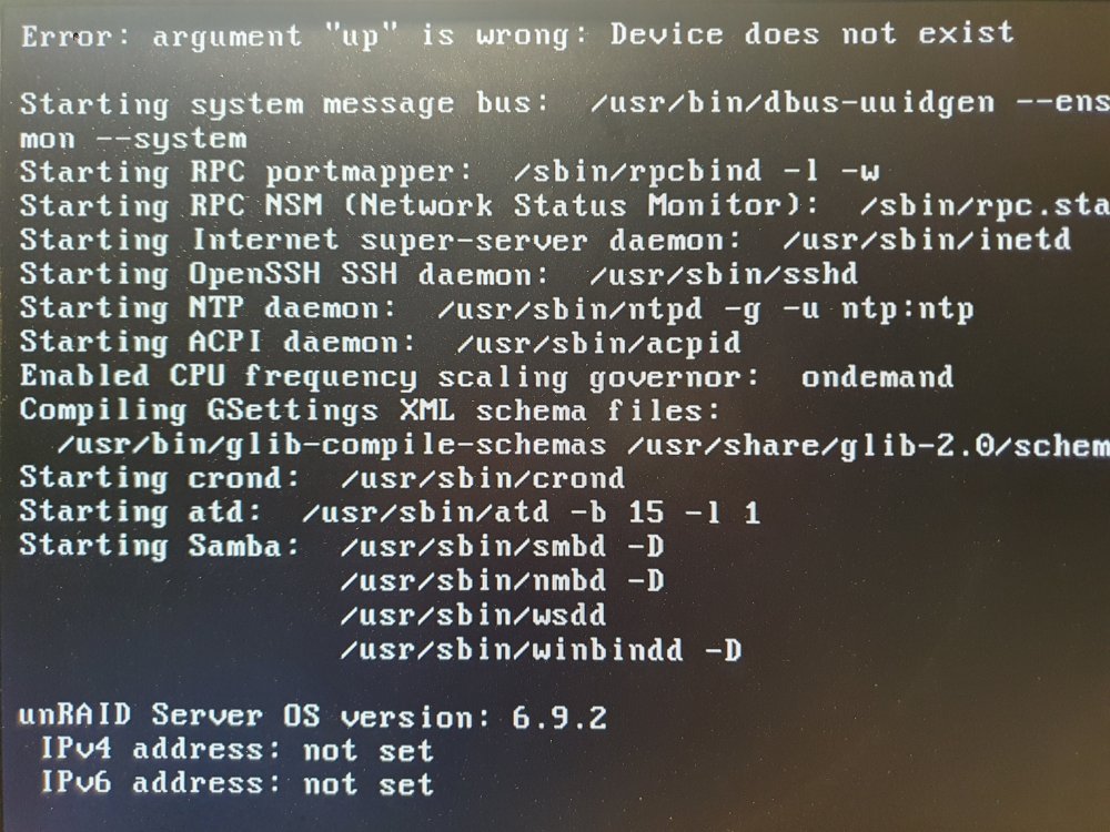

On Unraid1, I have started seeing errors in the bootup log stating:
'Not enough information "dev argument is required.
Error: Argument "down" is wrong: Device does not exist'
There doesn't seem to show an IP on the main bootup screen either, not sure if this is related:

- fix "interface rules" duplicates manually again
- confirm that everything is in correct order
- reboot
- fix "interface rules" again, and confirm
- network settings, enable bonding and bridging
- reboot
- confirm settings stuck, fix "interface rules" again

Also on Unraid1, the physical interfaces now seem to show up as eth0, eth1 and eth3.
I still need to manually modify the network-rules.cfg file after each bootup, otherwise 4 interfaces show up in the "interface rules" GUI.

- boot up log errors (I think) related to interface assignments.

Also, I have this issue on both servers where there is seemingly a skipped interface.
I noticed in the network.cfg that initially there is the line for 'BONDNICS[0]'.
Originally, this read as 'BONDNICS[0]="eth0 eth1 eth2 eth3"'
But now it reads as 'BONDNICS[0]="eth0 eth1 eth3"' on Unraid1, and 'BONDNICS[0]="eth0 eth2 eth3"' on Unraid2.
Unraid1 is where I'm having the issue where it seems to not be able to decide which interface id is being used, and lists 4 in the network-rules.cfg file. Unraid2 has not shown this particular issue.
Also, this bootup error seems to have disappeared after I jumped through hoops to remove-then-re-add the br0 interface, that I mentioned above.
I suspected that was related to the bridge getting messed up somehow, and that seems to have reset it.

Also that error message from an initialisation script "device does not exist" during boot is suspicious.
Either the device was there triggering/when the script had been started, but got lost until the script reached that part of the code (ghost device) OR that script is no longer functioning in itself.

Well, this just became a major issue for me today.
Rebooted my secondary, and the cards swapped around again, so that the onboard is eth0, with the mellanox as eth1 and eth2.
This also means that the bond MAC address is now my onboard, which is not good. My assignments use the Mellanox card.
While this is happening, I still have no access to the interface rules dialogue, so now everything is messed up and I cannot switch it back.
Also checking the system, I can see that the network-interfaces.cfg file is not created.
@bonienl I realise that this is not like a support ticket or something but this is supposed to be fixed?
I don't know what to do. I'm kinda stuck here. Any advice?

However, now I have this (THe dropdown shows duplicates):
I'm going to delete the interface-rules and reboot to see how that helps.
Edited by KptnKMan

I hacked the network-rules.cfg manually with the correct interface IDs, kernel modules and hardware addresses... and it reboots fine now.
I've rebooted the system 3 times in a row now just to see if something drifts, but its ok... for now.
How mine is supposed to look in my config:
