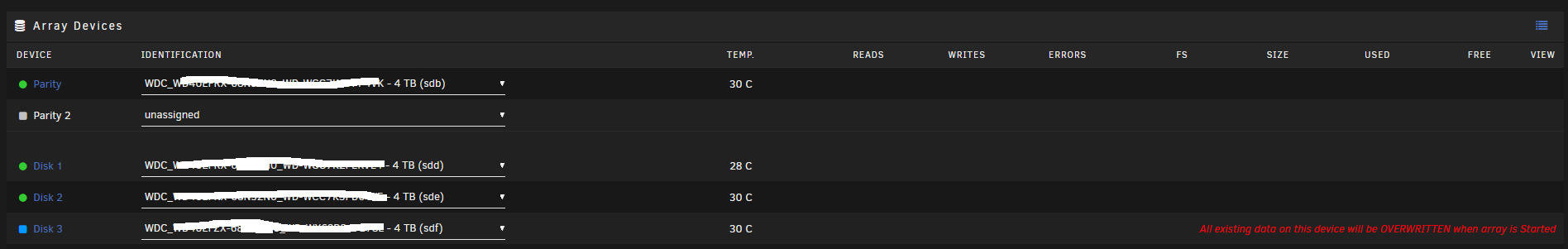

I then tried reinstalling with a 6 month old flash backup (this was the next latest backup), web gui is working but as the backup is 6 months old. I had installed a new hard drive in that time, and i cant mount the newest hard drive without the data being overwritten.
How do i progress without losing the data from the newly installed hard drive?

You can:
  • use Tools->New Config and select the option to keep all current assignments
  • return to the Main tab and assign the additional drive
  • Start the array to commit the assignments and start building parity based on them.
Note that your array will not be protected until the parity rebuild finishes.

Thank you,
just to clarify, that would build parity based on all the data already on the drives.
Yes.
