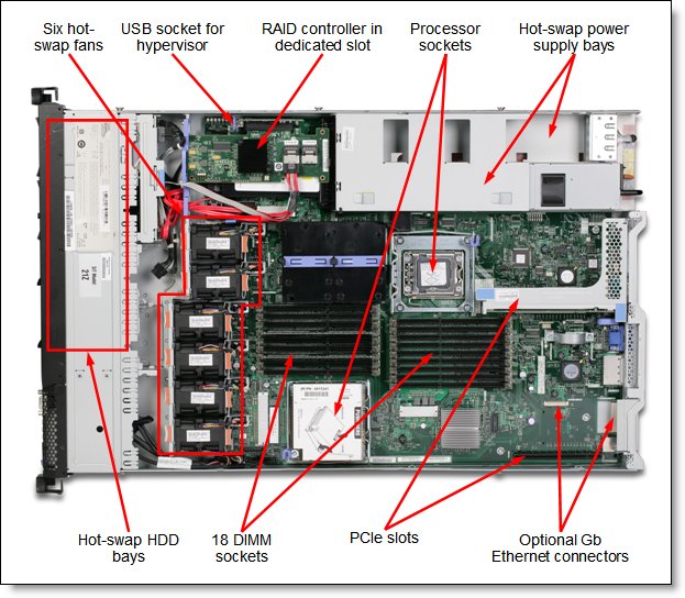

I was curious why the brackets aren't provided so I looked up the server they come from.  It's a 2U and the card lays flat and doesn't need the bracket.
The card in the picture isn't a BR10i by the way.
Sorry I would have meantioned it earlier, its like an internal P400, etc.. in a HP server. Thought every one knew why the IBM pulls had no plate. We need a good group buy on the plates  ;D
