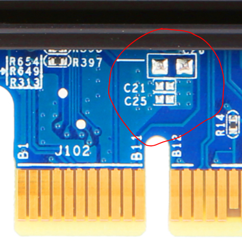

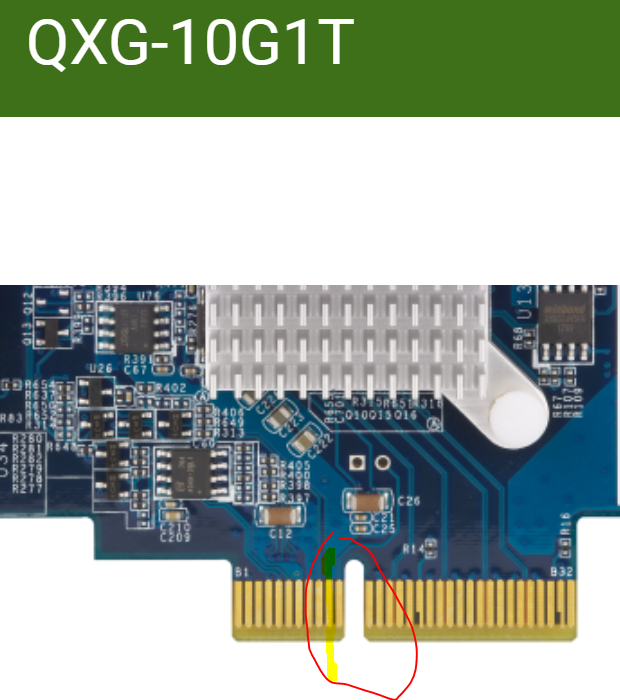

For Asrock x570m pro4, I suppose it may due to no 3.3v-aux present when system in S5, you can further check on this PCIe slot pin and solve if you know electronic circuit.
https://electronics.stackexchange.com/questions/225389/pcie-power-when-system-off
By some checking, Qnap B10 pin have circuit trace and component ( C21 C25 C26 C222 C223 ) but Synology have the trace only ( missing C21 C25 & C2X )

1. For Synology E10G18-T1 does not have WOL, it should be the NIC haven't implement  3.3v-Aux for the chips as standby power.

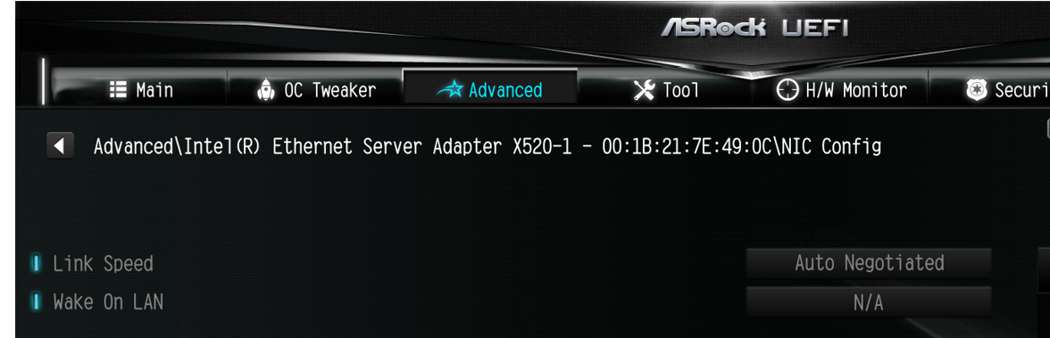

2. Tplink not work on Asrock, it should be mobo relate, could you check does mobo BIOS "NIC" UEFI WOL setting or status.
Edited by Vr2Io
There is nothing else in BIOS settings of x570m pro4 for WOL. Actually only Intel chips provide additional section in BIOS settings.
I have this option with N/A on X550, just like you shown. But Intel's 10Gbe NICs have no WOL at all.
Only if I activate "Boot from LAN", I see additional options for DHCP of NICs, but it had no influence on WOL functionality.
