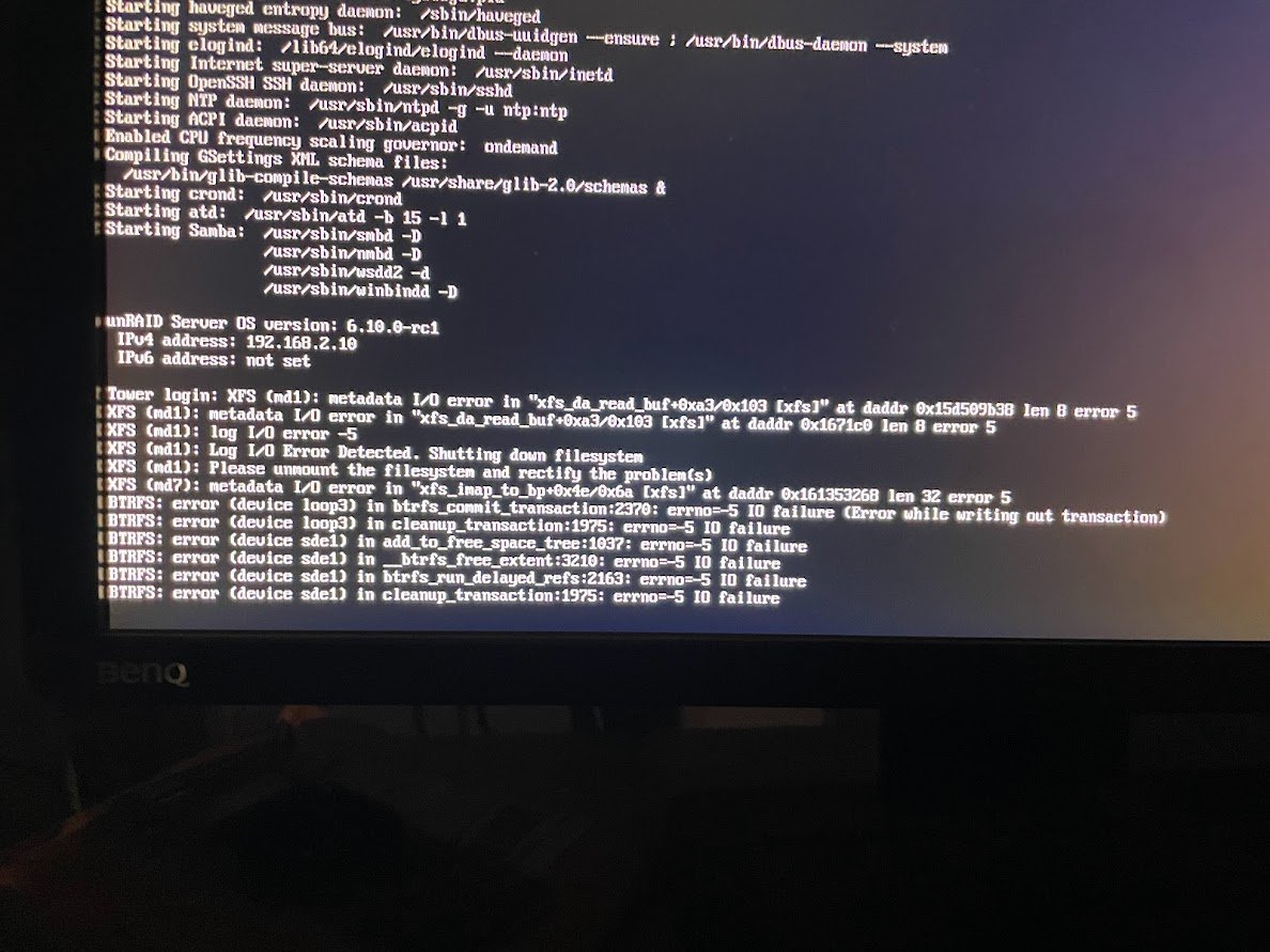

I hope someone here can help me.
Every time I hit check the drives to sync the server will lock up.   I have attached a screenshot of the error on the monitor and the Diag file.
I have taken the parity out and formatted it and using the PreClear plugin if I have it check the MBR that fails as well.
I am open for some advice on fixing.

A couple thing you can try:
-Update LSI firmware to latests
-Connect the disks directly to the LSI, bypassing the Netapp, you can only connect up to 8 but just for testing purposes.
If none of that helps you can enable the syslog server and post that log after a crash to see if there are more clues on the problem.
