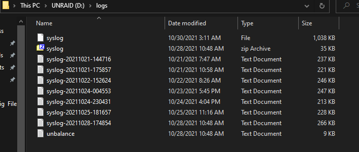

Syslog is mirrored to the flash drive and here are the results from last try.
syslog

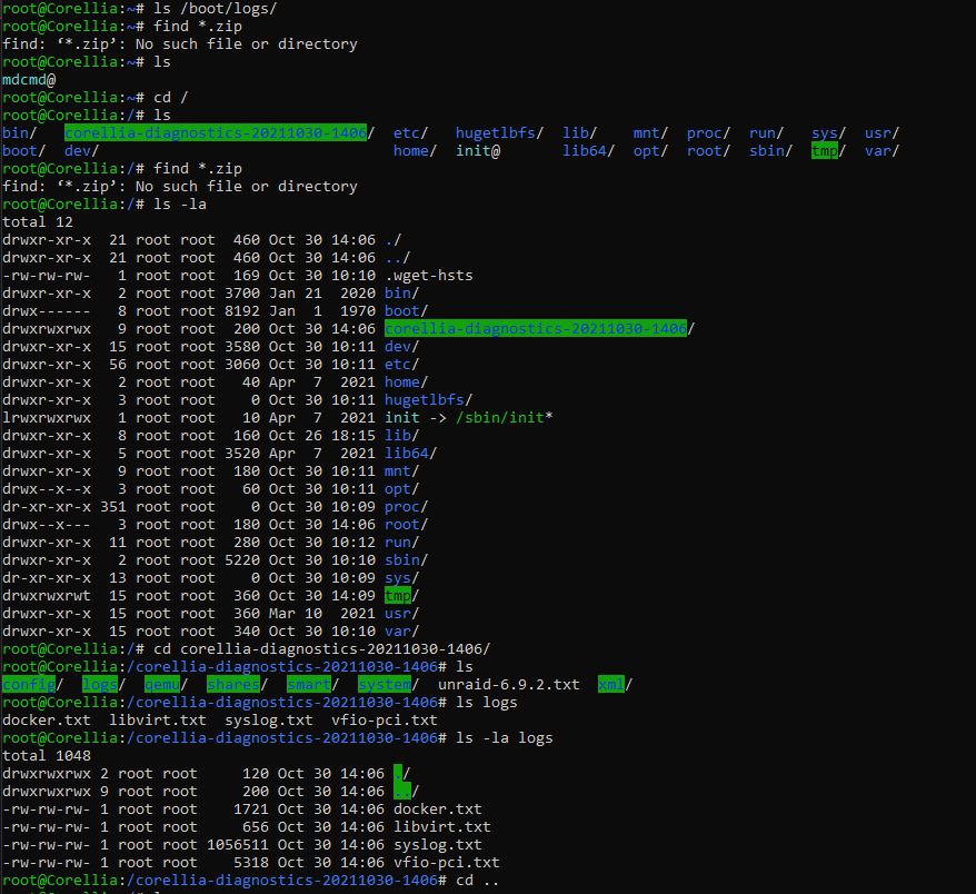

Sorry i forget to say although diagnostics are created from SSH session,
after shutdown server and plug the flash drive in my laptop there is no zip file on it, the only thing i can see is a directory with that name after cd / and LS the root directory

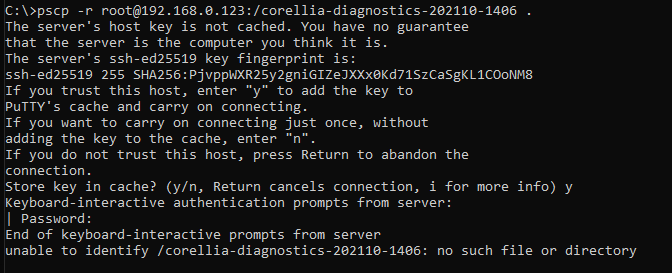

I've tried to copy the whole directory to my local machine with pscp but it seems i'm a bit lost finding the correct path

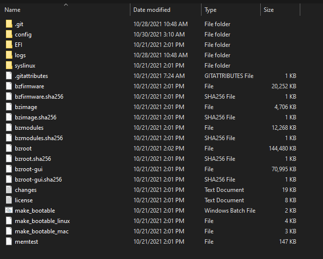

Here is how it looks the flash drive on windows
Try the following command:
ls -al /boot
You should get a listing of the files in the root of your flash/boot drive.  I suspect that you won't get anything except (perhaps) an error message.  I think your flash drive has gone 'missing'.   Make sure that it is plugged into a USB2 port as USB3 ports are known to be involved in boot drives going missing...

I've managed to copy diagnostics zip file to my local drive using pscp :D, i hope it helps.

Shutdown, put flash in pc and let it checkdisk. While there make a backup. Boot from a USB2 port.
This flash drive i've made last week after another one failed and returns unable to write on it, we can say is a new one, it is true that when i plugged it to windows i get the message saying the drive have errors but it didn't happened before.
