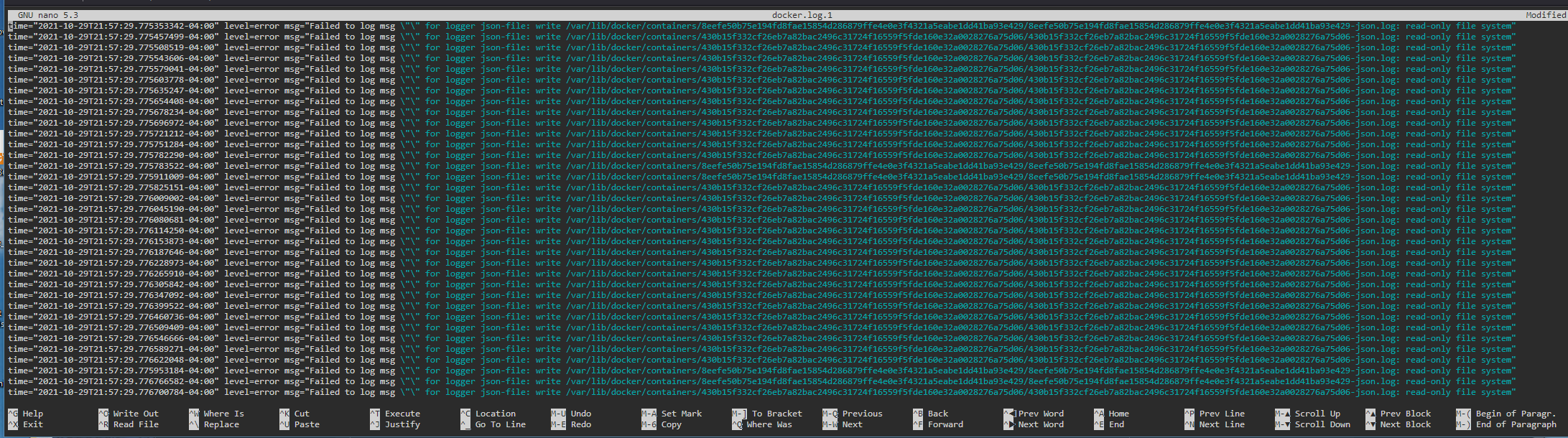

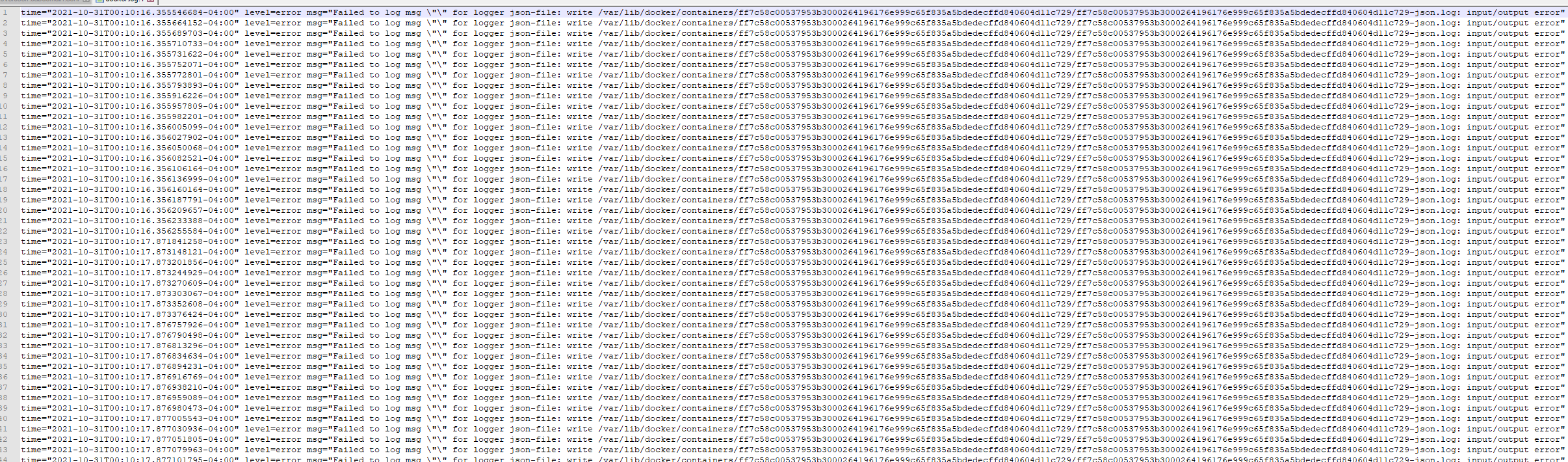

A few days ago I woke up to Plex not working and the container refusing to start. Quickly learned that the docker log was full. I rebooted the system and all was fine. I monitored the log size for the next couple days and it stayed at 1%. This morning however, back to 100%. I need help trying to figure out what is causing this issue. The docker.log is full of the errors that you see in the below screenshot. I've also attached my diagnostic zip. I've since rebooted the server to get everything working again.

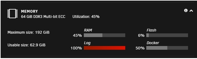

I actually checked the docker img, it's sitting at 50% and was when the log filled. Here is a screenshot I grabbed:

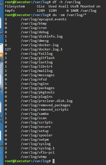

And in the screenshot in the previous post, you can see that docker.log.1 is 127mb. I grabbed it off the server to check and it is in fact 127mb and full almost entirely of those "...read only file system" errors .

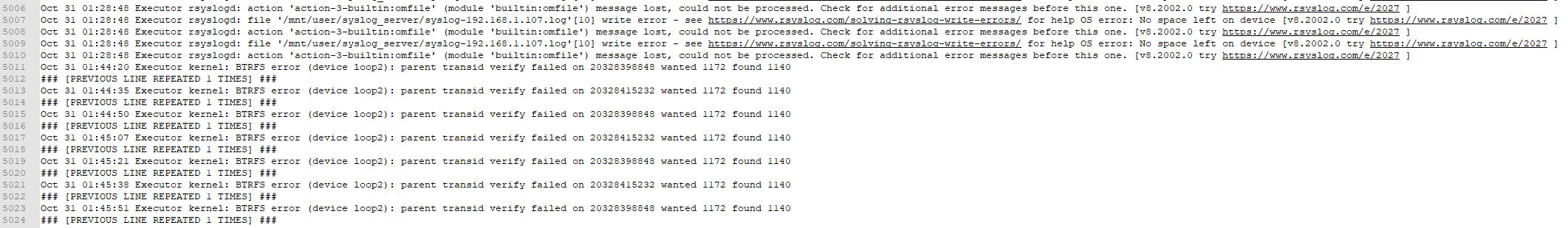

Oct 30 00:03:11 Executor kernel: verify_parent_transid: 7967 callbacks suppressed
Oct 30 00:03:11 Executor kernel: BTRFS error (device loop2): parent transid verify failed on 17584734208 wanted 1640023 found 1639989
By far the easiest way for this to happen is when the image fills up.

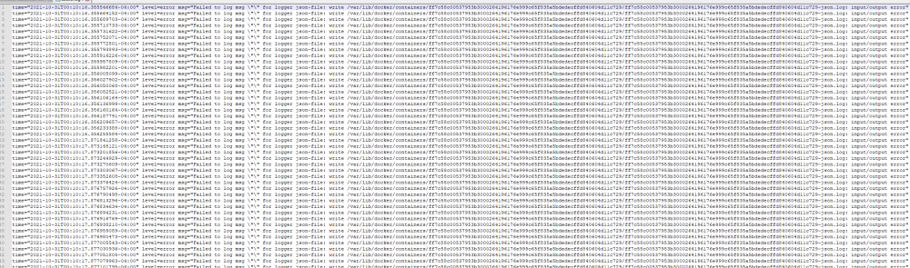

OK, log file filled back up again over night, docker.img still at only 57% utilization. The docker.log.1 file is filled with this:
Attached latest diagnostic file. I deleted and rebuilt the docker.img so that shouldn't be the issue.

I'm trying to get better at investigating so forgive my questions. But how do you know that the log errors like:
are from docker.img?
I also see that those errors started after the log space errors, so maybe the docker.log is filling first and then throwing those errors that look like docker.img corruption?
