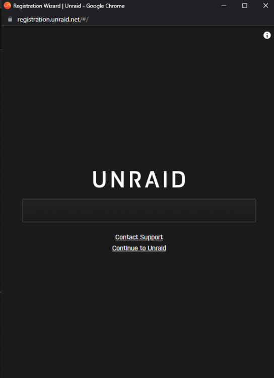

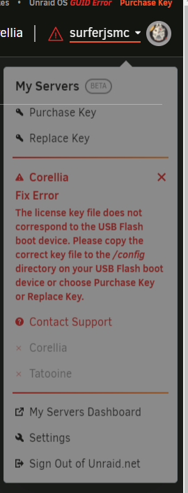

November 1, 20214 yr Hi! After a few days fixing issues with my server it turns out i had to replace my flash drive for the second time in 2 weeks. Downloaded latest flash backup from MyServers and make the new boot drive, when i logged to server and change users pwd i proceed to fix error with key but every time i tried the pop-up windows is almost empty Now i have this error key doesn't correspond to USB flash, tried uninstalling and installing myservers plugin, downloaded the key file and replace it manually but there is no way to fix it. Edited November 2, 20214 yr by surferjsmc
November 1, 20214 yr The automatic Flashdrive change procedure is only available once a year. As stated on the screenshots you provide, you have to contact support : https://unraid.net/contact
November 1, 20214 yr @surferjsmc can you please share screenshots of the browser development console in both the webgui and the pop-up window after the pop-up window opens? This might help us figure out what's going on with this bug you're hitting. Right click on the page > choose "Inspect" > then select the "console" tab in the panel that opens.
November 1, 20214 yr @surferjsmc please disregard the above message. I just saw your support ticket and it included more verbose details about your situation. I was able to re-create your bug. I'm in the process of deploying a fix for the pop-up. Please give it about 10 min or so from the time of me posting this message then try again. The pop-up should fully load. That said, because you replaced your flash drive already this year it means your ineligible for another replacement. Please respond to the support email that we sent you with any additional info regarding the key replacement.
November 2, 20214 yr Author @zspearmint the pop-up issue is now fixed and i've already respond support email. Thanks!
