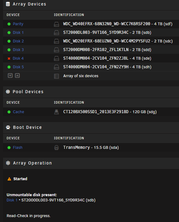

Hi all, I've got the following error on the Main tab for one of my disks, but then another disk is showing as "Device is Disabled".
This is all after a powercut I had yesterday.
Attached is my diagnostics after starting the array
Any idea what I need to do to resolve this? My disk/hardware knowledge is not great

Disk4 dropped before disk1 started rebuilding, so rebuilt disk1 will be corrupt, was this done on top of the old disk or a new one?
Problems with disks 1 and 4 look power/connection related, replace cables.

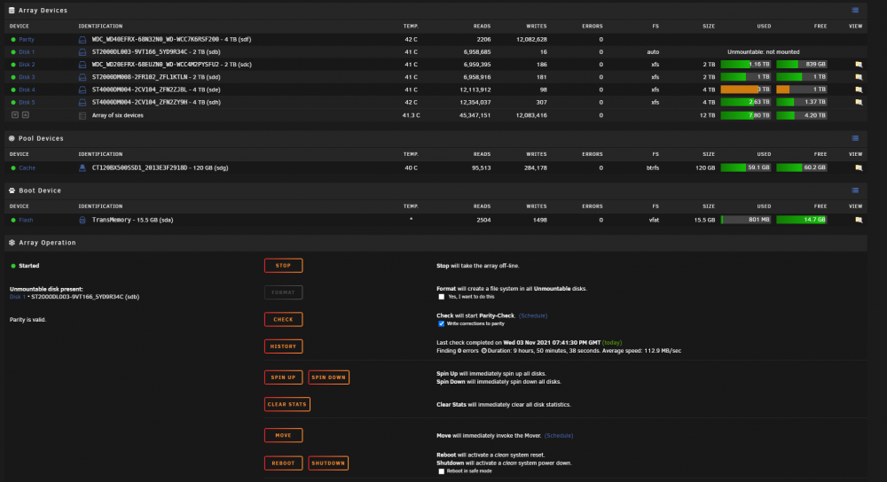

Post a screenshot of Main - Array Operation.
Here you go
OK, that's what I thought from diagnostics but just wanted to make sure.
Do you have a spare disk you can use to rebuild disk4?
I do not currently have any spare. Do we think disk 1 is dead?
Don't think there would be much point in rebuilding disk4, since disk1 is corrupt a rebuilt disk4 would also be corrupt, best bet is to do a new config to re-enable disk4, as for disk1 you can run a filesystem check but most likely there won't be much of use there.

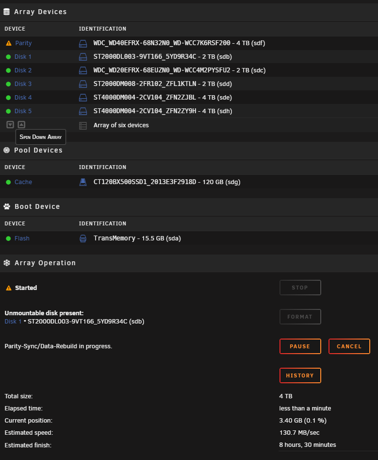

How do i do a new config to disk4?
-Tools -> New Config -> Retain current configuration: All -> Apply
Then start array to begin a parity sync (or check parity is already valid before array start and then run a correcting check).

And Parity sync is now running

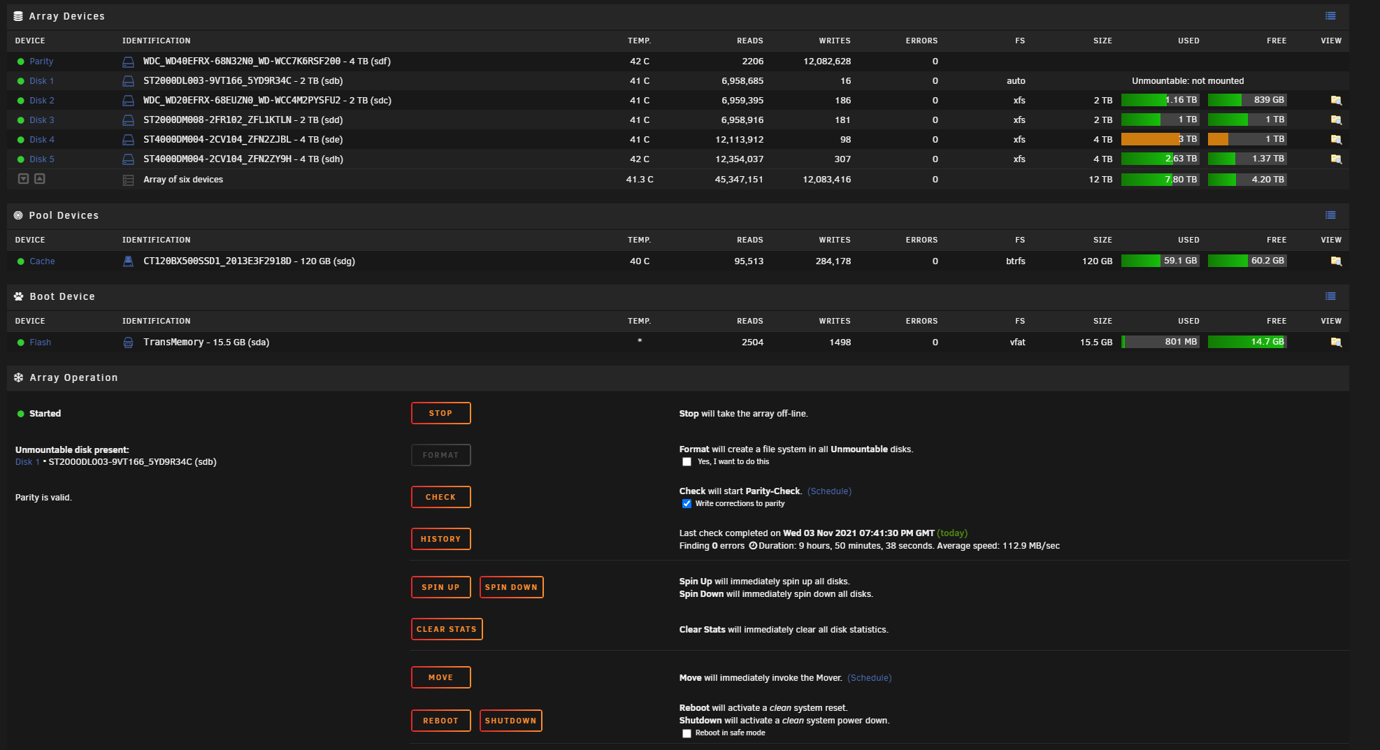

As far as I'm aware disk4 is now in a correct state and no longer emulated too
Didn't even noticed that the emulated disk4 was now mounting, so maybe disk1 can still be fixed, but kind of surprising due to all the errors during the rebuild.
Sync finished with 0 errors. For some reason there's no File System Check available for disk1 now. The option is completely missing. It appears for all of the other disks
