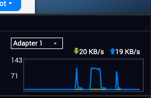

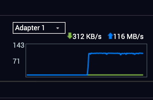

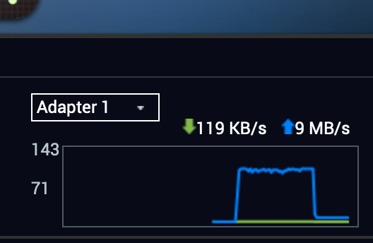

I wanted to show a new graph, because the one I posted above made it look like the speeds go up again while in fact it shows three separate copy commands (I aborted them after the speed dropped).
That said, the write speeds stayed longer this time. For about 35GB I had full speed and then they dropped to 9MB/s.
Screenshot 2021-11-02 at 07.03.27.pngstormy-diagnostics-20211102-0704.zip

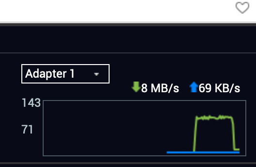

Just tried another way: copying from my unRaid NAS to my Qnap NAS and I get the same behaviour (see picture). So its not only writing via network but also reading where I get the bottleneck :(

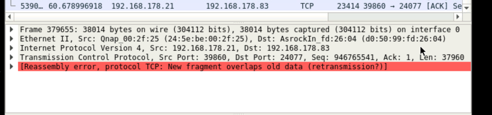

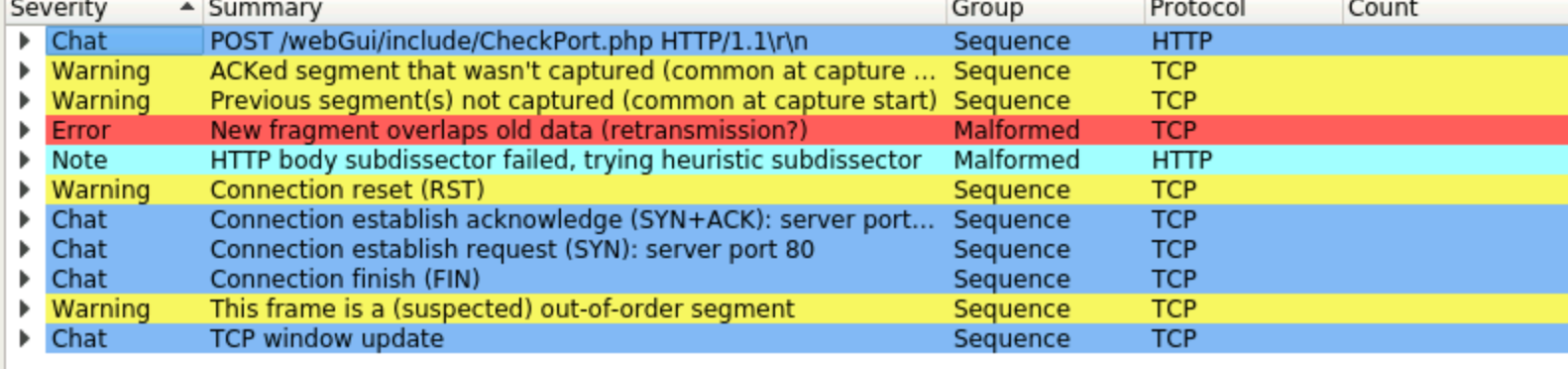

@trurl I tried some Wireshark (me= network noob) and found this:
Does this help?

I'm not that good myself. Other than maybe changing cables I don't know what to suggest. Let's see if @JorgeB will take a look.
Not a big networking guy, but it does look like a network issue, try different cables/switch/NIC.

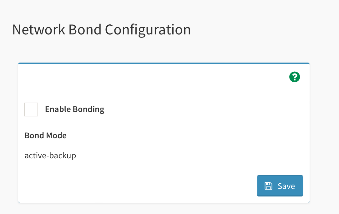

Alright, so its fixed. Not a big fan oof ASRock that's for sure...
So it wasn't enough to disable network bonding which I already had:
365686496_Screenshot2021-11-12at21_53_22.thumb.png.8c2c1b0a5d945f7405fa081d748a7ddd.png

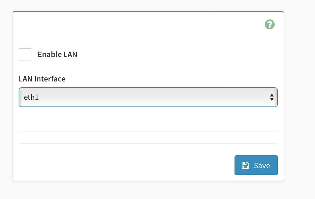

I also had to disable eth1 (eth0 is the IPMI):
256673736_Screenshot2021-11-12at21_53_39.thumb.png.384b8e4190347cb858311bf4c98eda37.png
It really didn't help that the MAC address of eth1 wasn't listed in unRaid (not blaming Limetech, probably ASRocks fault). Eth0 I can understand because its the IPMI port.
Then I used one of the 10GBe ports in unRaid (disabled bonding as well) and put it as eth0 (this is not the same eth0 as the IPMI port) and disabled all other ethernet ports.
If anybody else has this problem or this board, for the love go God do not disable eth0! I did and while eth1 was set to DHCP it didn't get an IP address. While stupid me saw the 0.0.0.0 IP in the BMC I thought it was a display error because DHCP for sure would work....of course it didn't and I had to buy a VGA to HDMI adapter in order to access the BIOS or the BMC because I couldn't access it anymore over LAN.
