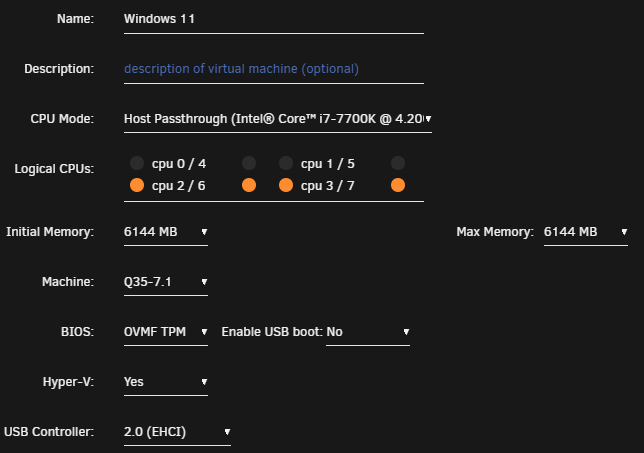

Have you added nested kernel option in syslinux? Tbis is for intel
label unRAID OS
  menu default
  kernel /bzimage
  append initrd=/bzroot kvm_intel.nested=1
AMD. kvm_amd.nested=1
Edited by SimonF

I had this working in unRAID 6.10.0-rc1. Since then I only run my windows VM bare metal because the WSL2 performance is like night and day. Anyway, here is my XML
It says Winndows 10 but it's actually Windows 11. Yes enabling nested=1 was necessary
