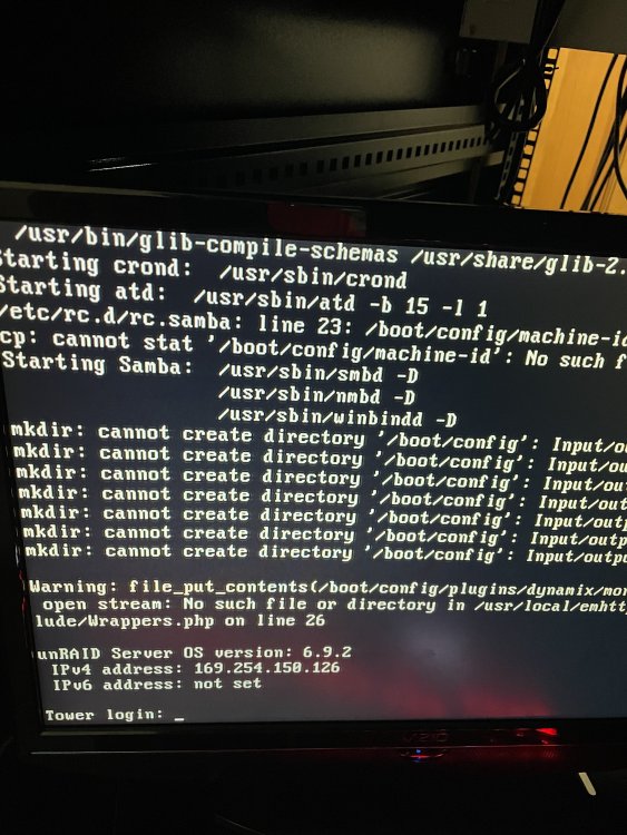

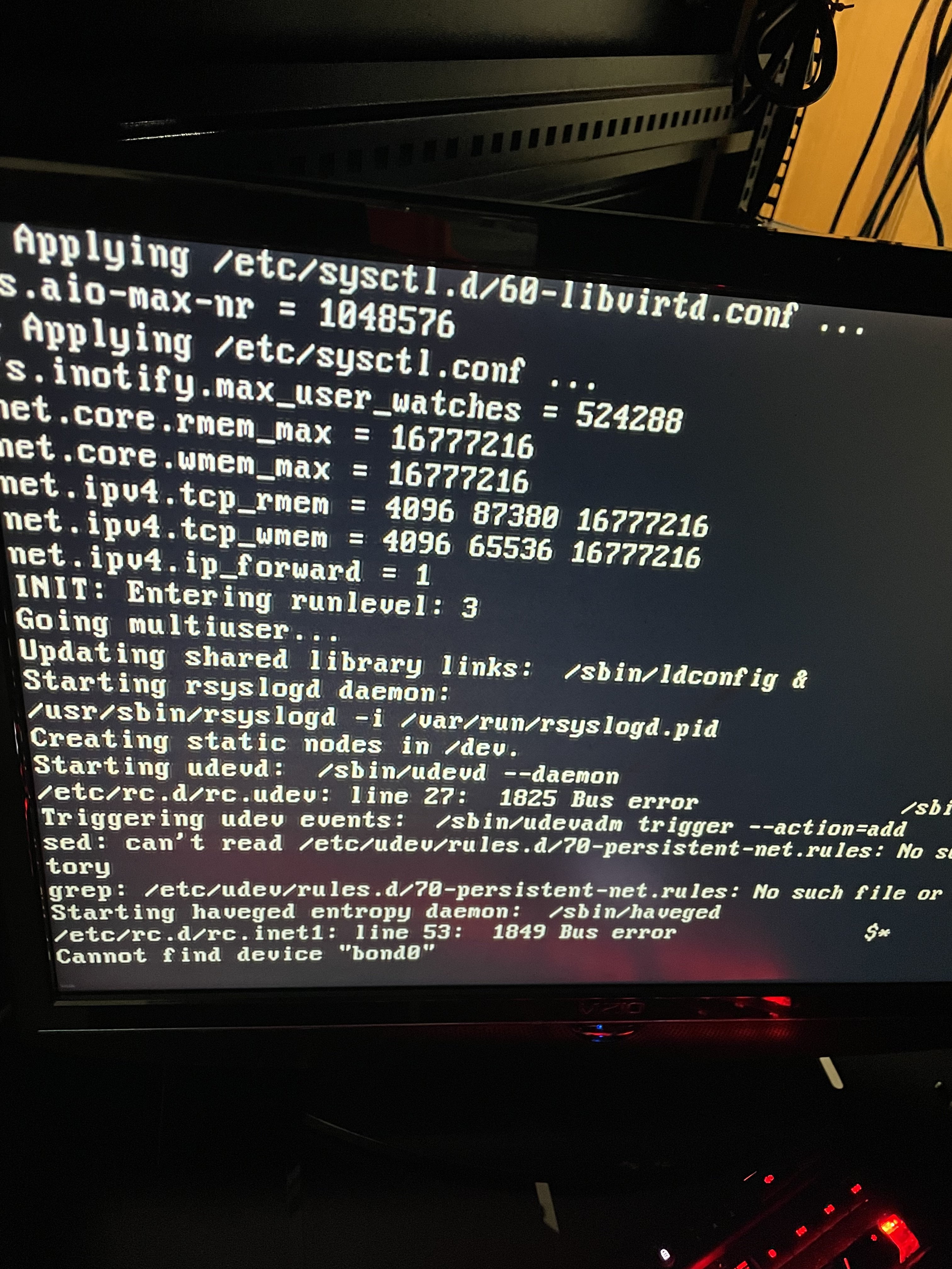

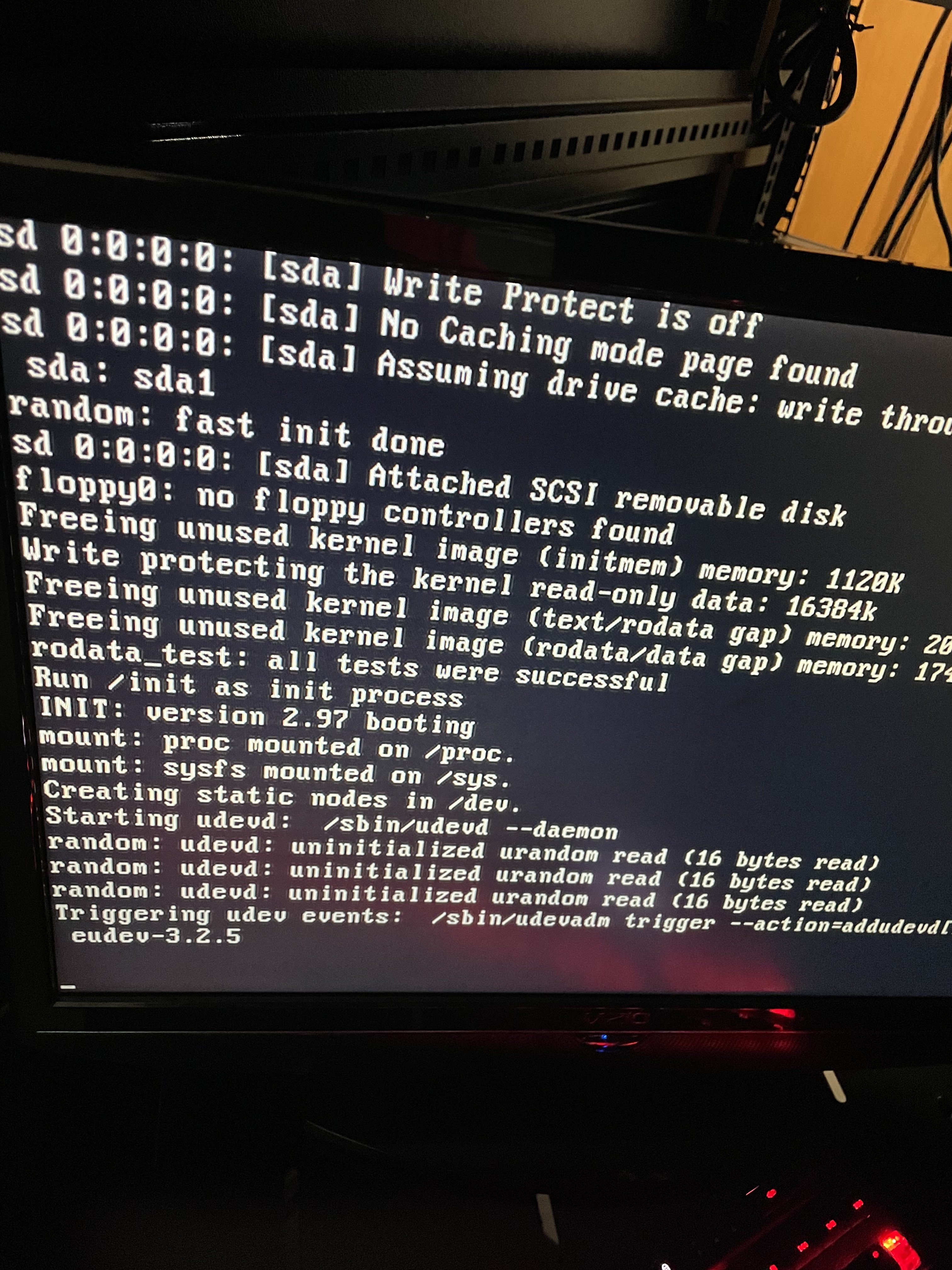

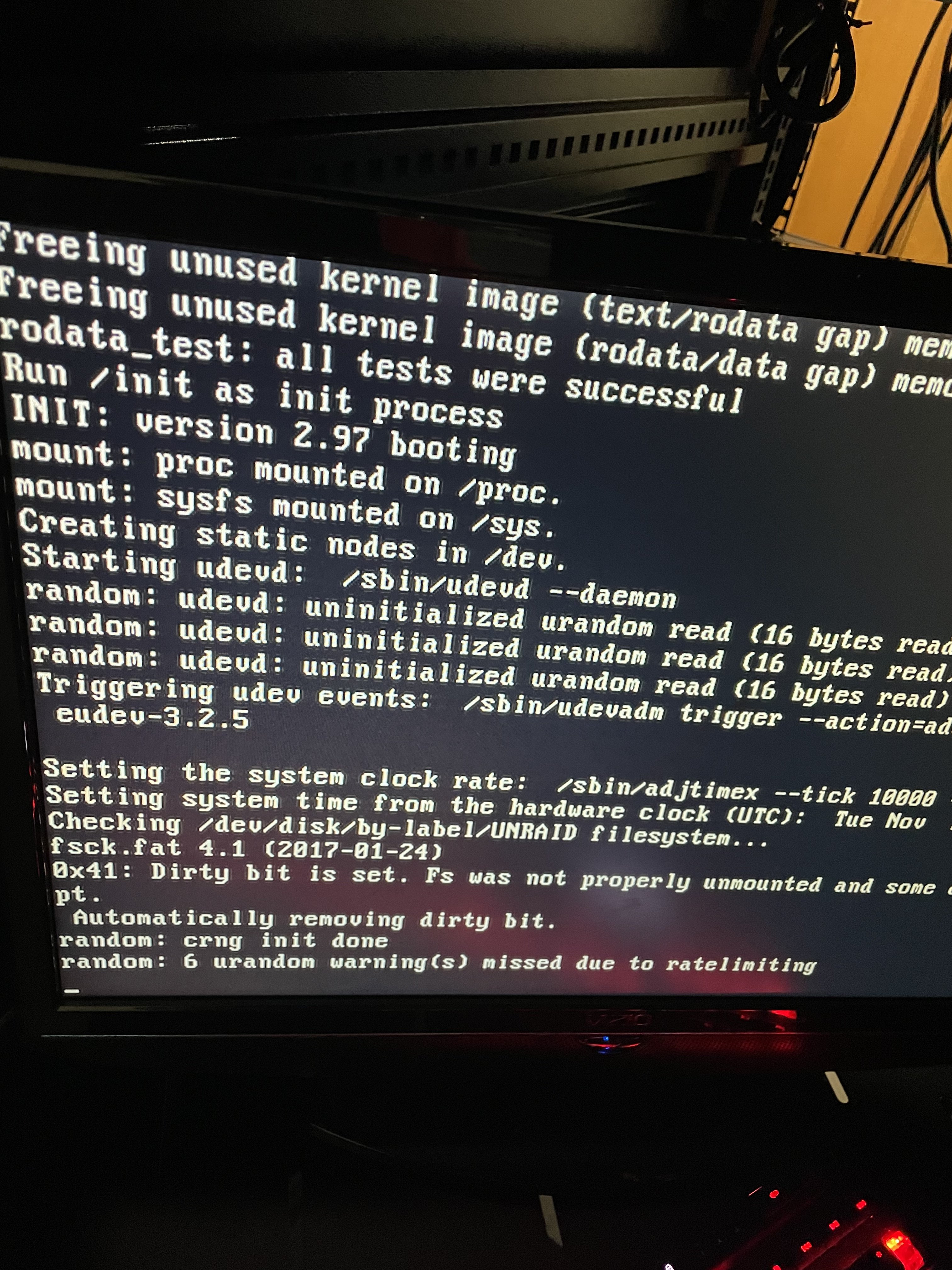

I've looked through the comments related to this and tries a few things from there but no luck.  I have unRaid on a USB stick plugged into a ASRock X470D4U2-2. I'm seeing the "Cannot Find Device Bond0".  I can't seem to get any logs from the USB stick when I looked at it on a Windows PC (files seem to be there and intact".  I've spent most of the last 6 hours trying to fix this. I've tried plugging the ethernet into different slots, moving the thumbdrive around, updated BIOS, downgrade BIOS etc etc.  No idea why this is happening as its been about 2 years.  I've taken some pictures of whats on the screen but like I said I can't get logs.  I also can't type anything once you see the "tower login" at the end.  Can someone lend some assistance?  Thanks in advance.

That looks like a flash drive problem, make sure you're using a USB 2.0 port and/or try a different one.
