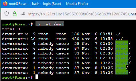

Open the GUI Terminal and run the following commands:
ls -al /mnt
You should get something like this:

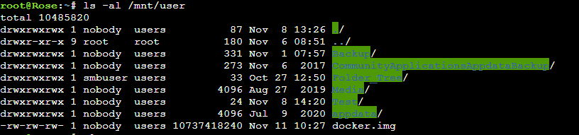

ls -al /mnt/user
You should now get something like this:
You can either use the Snip-&-Sketch tool or left-click and sweep across the Terminal Windows  which will copy the text to the clipboard.  (If you do the second method use the toolbar in the reply box to output it as 'Code'.)

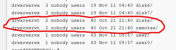

Per a request from Frank1940
These two shares are there because of the Unassigned Devices plugin.
I don't use the plugin so I am not real familiar with it but I seem to recall that can be problems if the physical disk(s) for these shares are removed and then you attempt to write to these disks.  (I hope someone else who has more experience with the plugin will jump in at this point...)
I had used these when testing with an external drive.  I removed the two Unassigned Devices plugs the memory issues have not reoccur over the last two nights.  I'm calling this one done.
