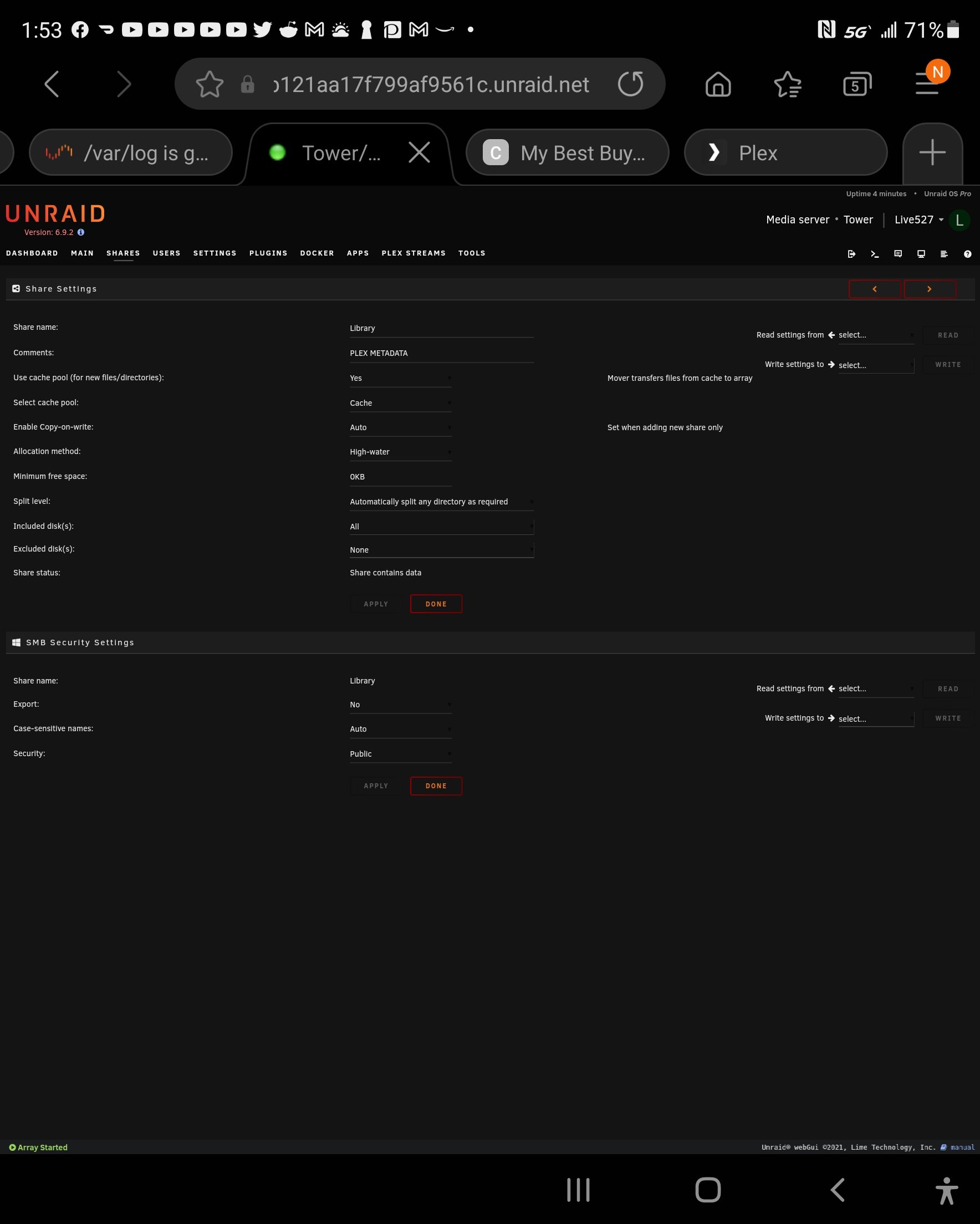

47 minutes ago, Live527 said:
library share
That share has files on the array and on plexssd, but it isn't configured to use that pool. And it is cache-yes, which would make it get moved to the array. You want it to be Use cache pool: Prefer and Select cache pool: plexssd
Nothing can move open files, and mover won't move duplicates. You have to go to Settings - Docker and disable dockers before you can get these moved where they belong.
You can see how much of each disk is used by each user share by clicking Compute... for the share on the User Shares page, or using the Compute All button at the bottom.

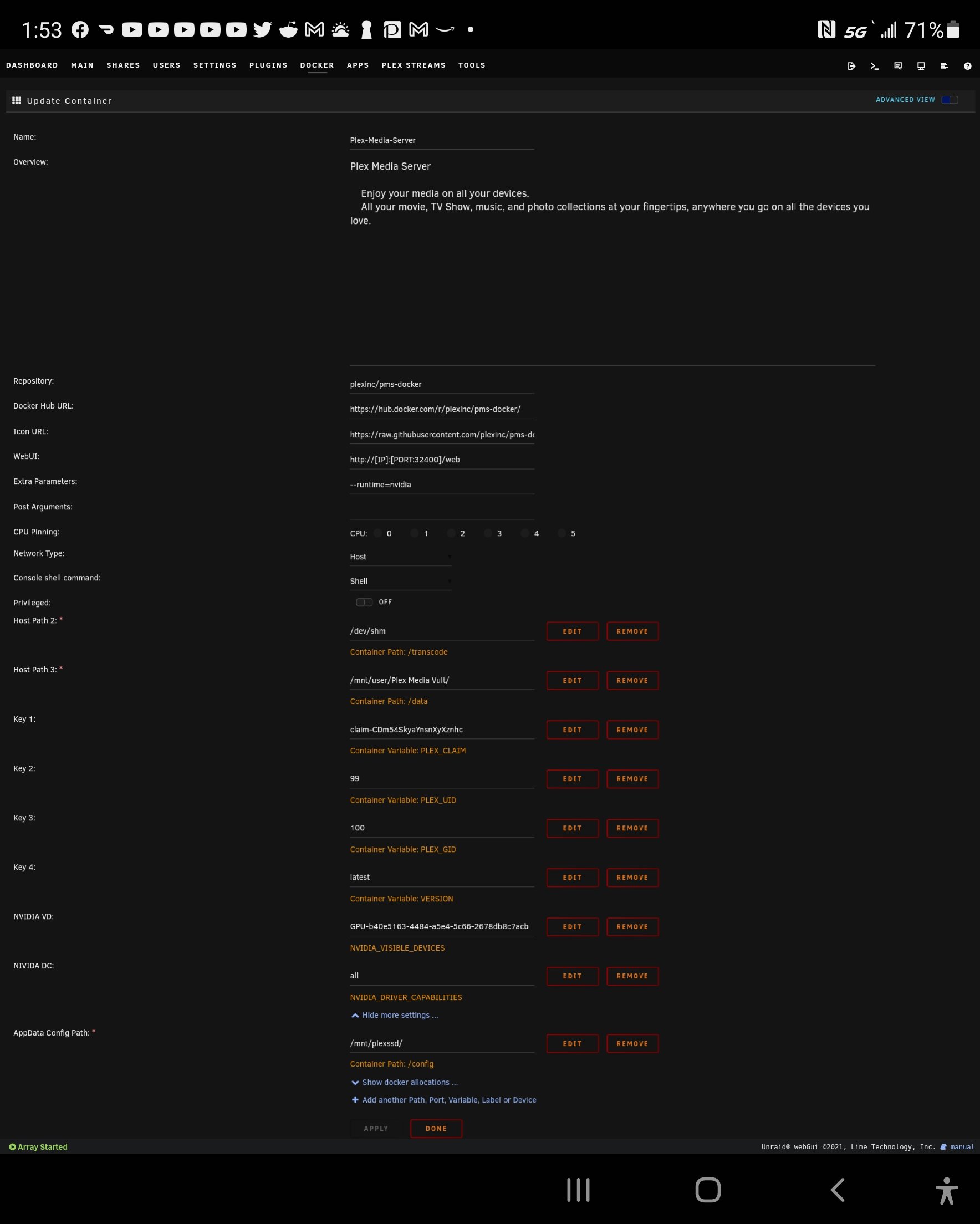

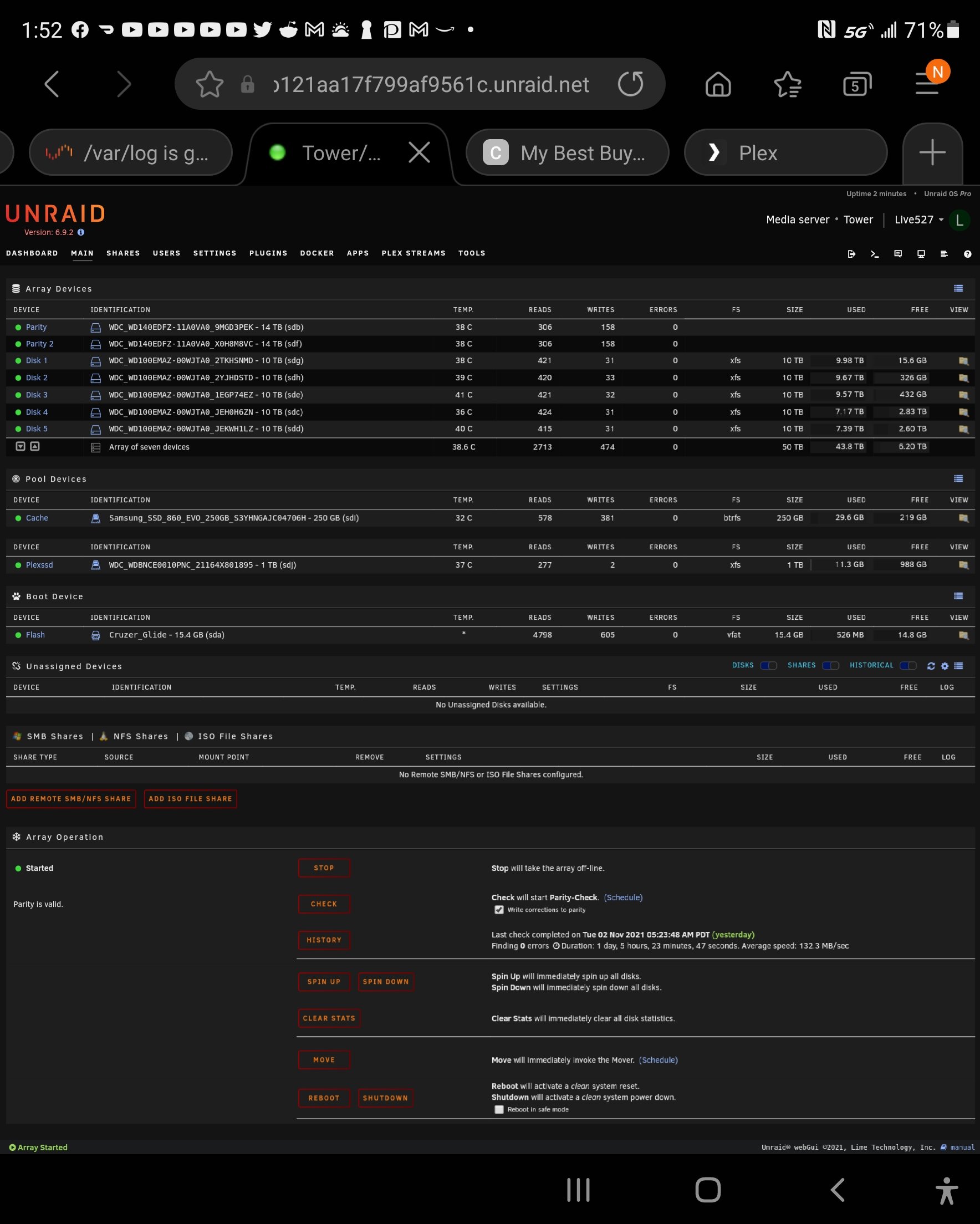

Here is some screenshots of how it's set up now and explain to me how I can fix it.

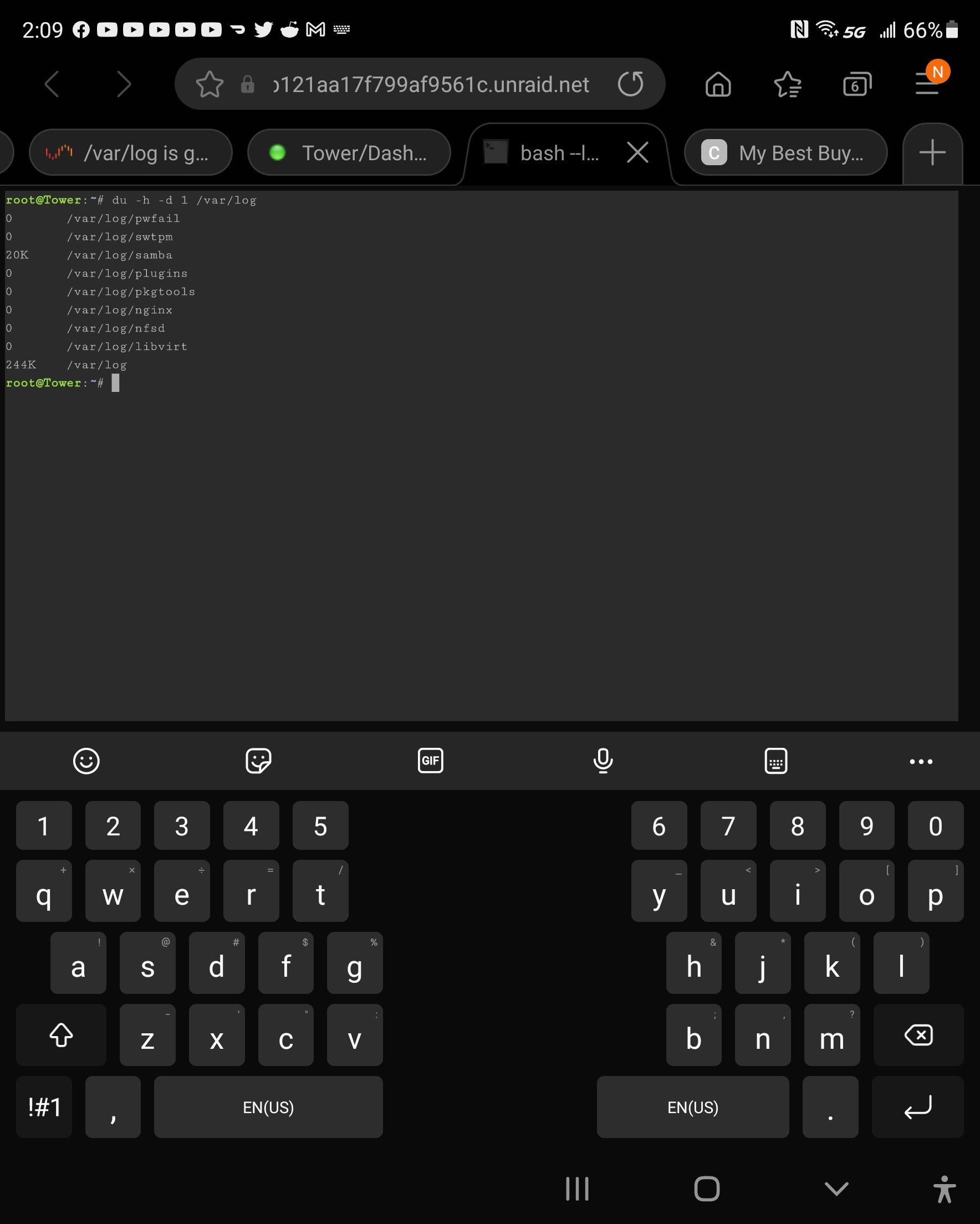

Also, not sure what is filling your log space since the syslog isn't that large. What do you get from the command line with this?
du -h -d 1 /var/log
As of resetting my server it's back to 1% used
This is what I get now
What fix I was talking about was the plexssd thing. I wanted the metadata only on that or dose the plex docker container always make a backup library folder. If so how to I get it to be on the parity drive as it has the icon saying it not protected
It isn't a backup library folder, it IS your library folder. User shares are simply the top level folders of all array and pools, so you have a Library folder that spans that plexssd and some array disks. If you want it all on the array so it is protected by parity, then you will have to move it off that pool and set it to not use cache. But, your plex won't perform as well with it on the array, and it will keep array disks spunup.

So looking at the pictures I sent I have everything set up correctly right.
It isn't they way I would do it, and it doesn't get all of your Library share onto the array.
ok confused now how should it be set up
I have a two cache pools plus the array. How do I get it all set up correctly.
