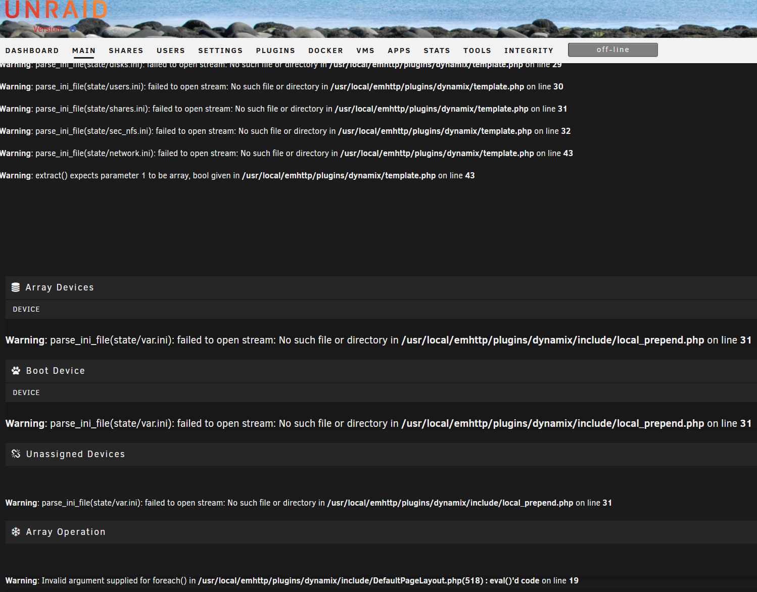

Hey guys, after months running perfectly, my server starts acting up.
I found it with the WebGUIs busted yesterday in the evening. I saw that I couldn't access /boot so I figured that the flashdrive dropped for some reason.

But it failed again only a few minutes later from the log. This time, it's not an issue of the flashdrive dropping, so I grab my diagnostics.
Nothing jumped out in the logs, but my linux knowledge is quite limited. :/ Does anyone see something that could be the cause ?
