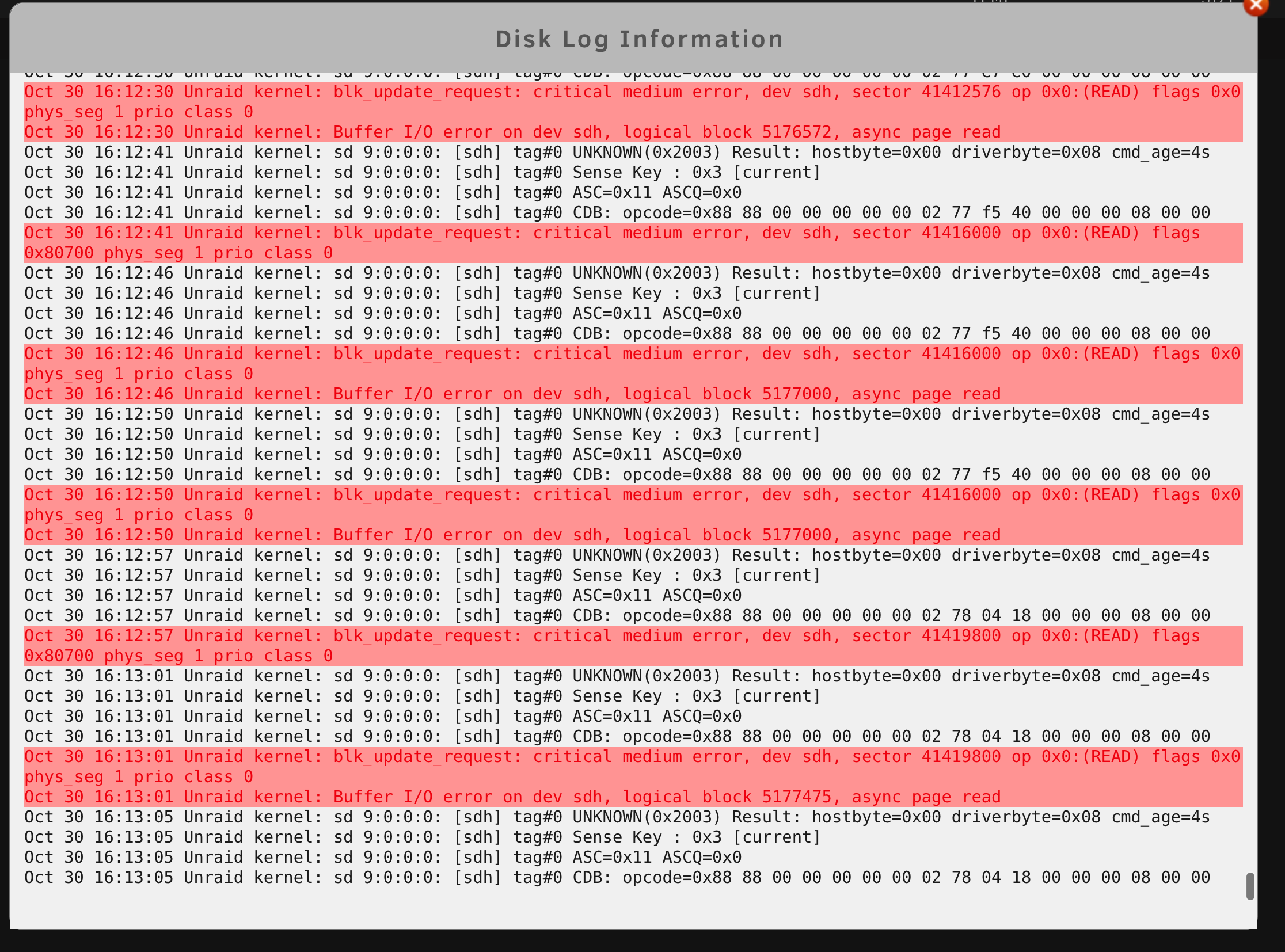

I have just purchased a new WD Red Pro 6TB and i am seeing a lot of "blk_update_request: critical medium error" in the pre-clear log.
The disk is connected through a USB Adapter instead of SATA at the moment, because all SATA ports are in use.
Is that a normal behavior?

No - sounds like a faulty disk.    You could try running an extended SMART test to confirm.
I have did the extended SMART test and the test was good. After that i ran the pre clear script and everything was fine except of the post read verification. Is that something that i have to worry about?
Also the medium error in the Disk Information Log is still present, but thats kinda weird to me because i have those errors with a disk that failed and which i already replaced.
Any ideas?
Logs are attached.
Log.rtf preclear_disk_V9G95D3R_25071.txt

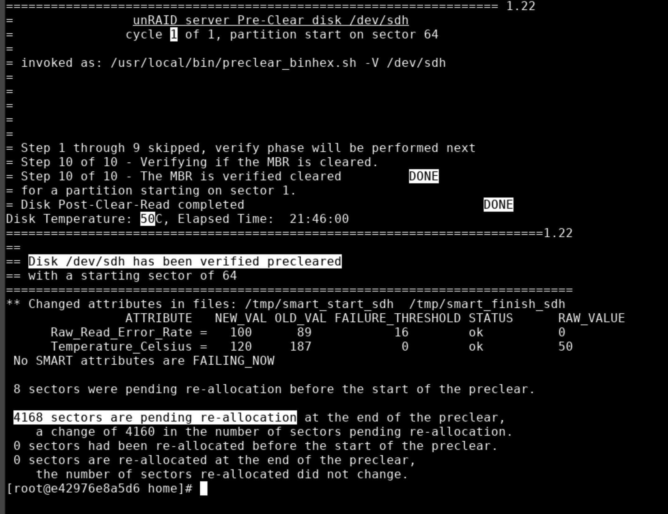

Unfortunately i still had errors during the post-read. Zeroing the disk was fine.
"4168 sectors are pending re-allocation..." does that mean i should RMA the disk eventhough the SMART Test was good? 583219121_Post-readresult.thumb.png.380fe4b79105930ec5a5843aa920e0bf.png
WDC_WD6003FFBX-68MU3N0_V9G95D3R-20211108-1309 (sdh).txt
On a new disk I would expect this value to be 0.   Even on an old disk a number this large would be a cause for concern.
Yes this value is 0 on all my disks thats why i don't even want to invest more to time for any other test. The result clearly shows that there is something wrong with the disk eventhough it's brand new.
