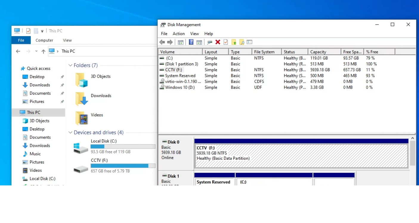

I've set up a cache pool and combined them to make as 1 large drive (2x3TB)
I/m trying to understand why unriaid is telling me me cache is almost full ~320GB free, yet Win10 VM shows as ~657GB Free.
When allocating disk in Win 10 disk management, i set the size just under 6TB.
But i have also noticed, that unraid VM allocation is only showing 5TB, i know when i created the vdisk, i set its szize to 6TB.
Any care to explain, so i can understand whats happening

I have run a disk defrag,
WIndows doesnt show the vdisk as "Thin provisioned" - Should it?
Also, unraid is still showing that im at 280GB free, when windows disk is showing at 740GB free

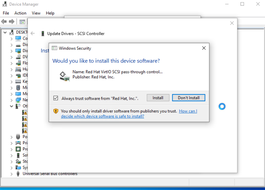

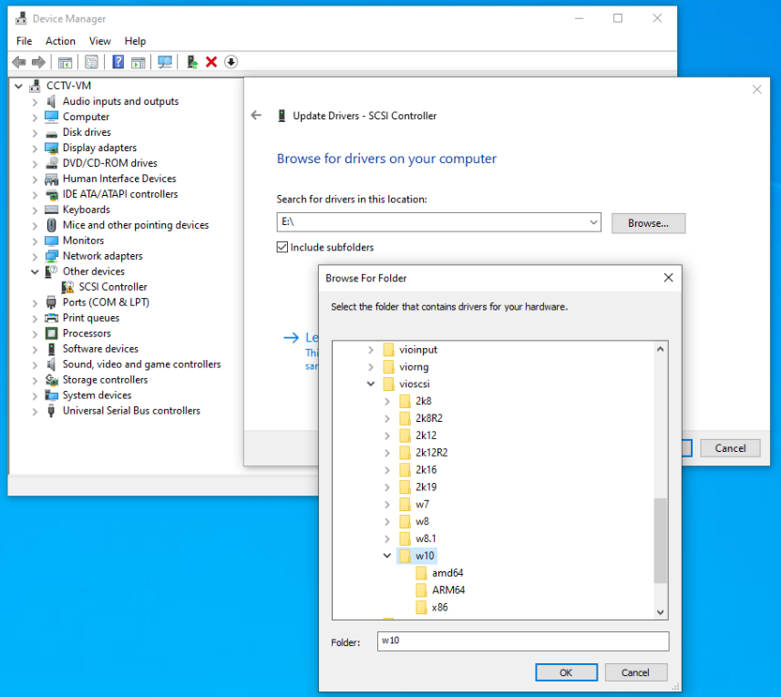

It does for me using the virtio-scsi driver, try with that one, driver is inside the amd64 folder.

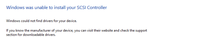

If i change disk to SCSI - It wont find the driver
Leaving as sata, Right Clicking on the driver and installing indicates driver installed, but does not change to thin provisioned.
I have added the "discard=unmap option" to the xml
No one before complained of the same, and I just tried on a new VM using the newest VirtIO driver ISO and still works, so you must be doing something wrong:
Double check the procedure
hmmmmm - i still get sam error
Perhaps, ill remove the vm and start form scratch

Windows still cant find driver!
So now, not really sure what im doing wrong!!
Sorry, no idea why it's not working for you.

I have tried the scsi option again but cant install driver from within device manager
