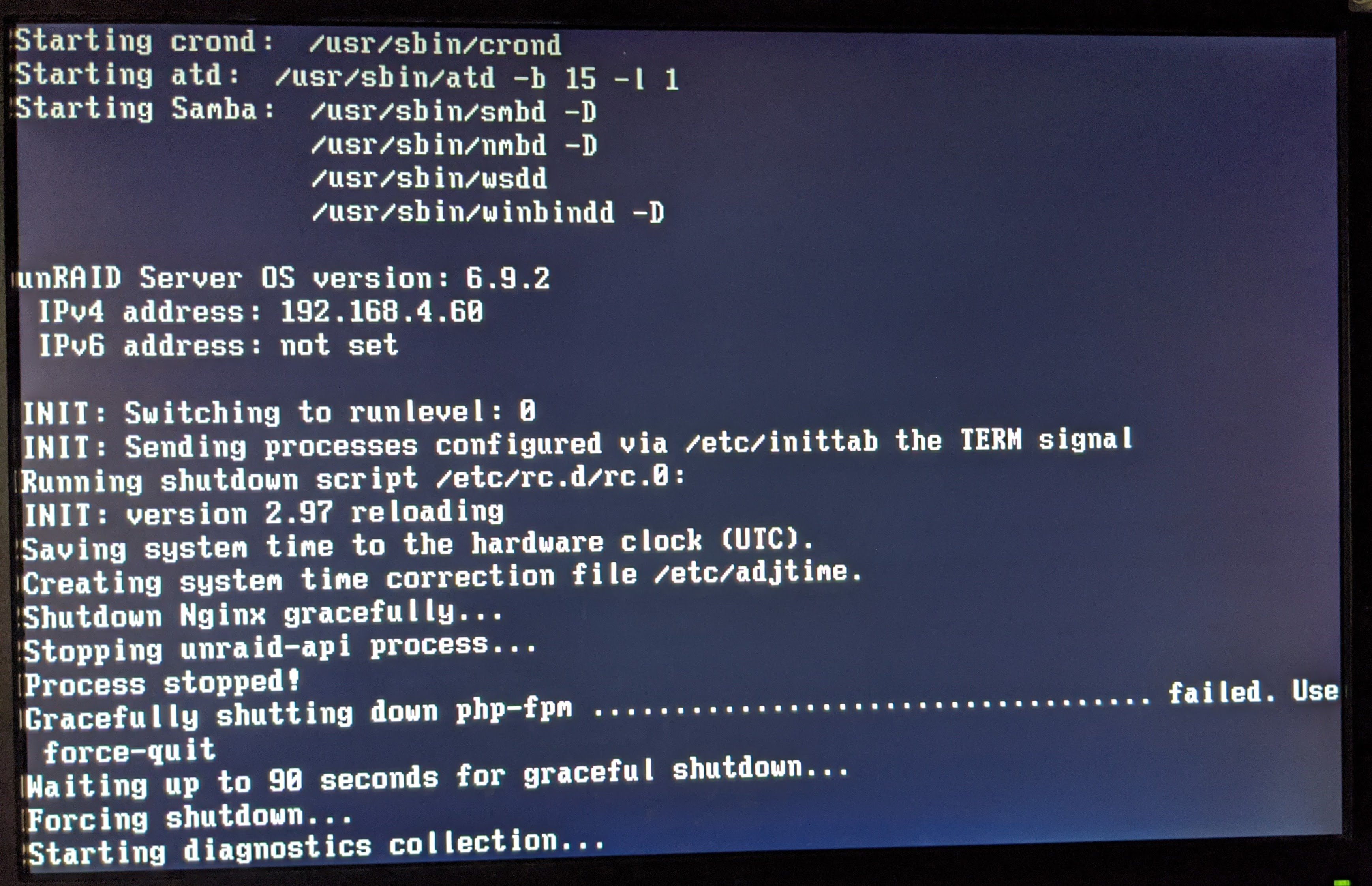

  • The machine drops off the network and becomes unresponsive to the locally connected keyboard after around a day - usually a bit after finishing the automatic parity check due to being powered off when it stops responding to the outside world. When I'm pretty sure it's become catatonic, I firmly pushed the power off button and it starts an orderly shut down, but freezes at "Starting diagnostics collection..."

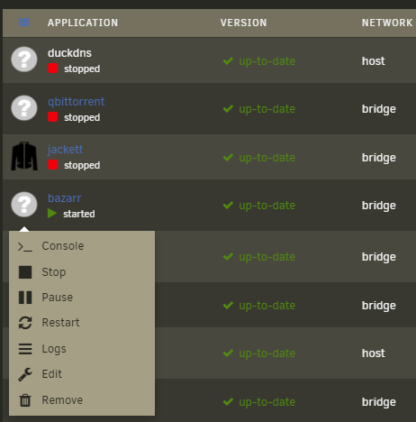

  • While it's on, the icons for most of the docker containers has disappeared, and for those that it has, the "WebUI" option is missing.

The BIOS is updated (was a good 2.5 yrs out of date) and "Power Supply Idle Control" is now set "typical current idle". I should know by tomorrow night if it's any less crashy... In my defense, it was pretty stable for large swathes of the past 4 years.

If you didn't keep your config folder from flash then you lost all your docker templates. The dockers would still exist since they are in docker.img but without the templates the webUI doesn't know how to work with them.

Not entirely clear what you are saying your problem is. Maybe screenshots would help.
Bazarr has no WebUI. And neither do any without icons.

What controls the context menu in the Docker container list? Where in the XML is it sourcing the icons? (what in the world could have borked that XML?)

Just to try it, I went to Community Applications and reinstalled a Docker over an existing Docker application I didn't care too much about losing recent work in (after making sure it was stopped). Carefully filling in the paths, it seems to have repaired the application. With that success, I moved onto the ones I cared more about and they all seem to work and present as expected.
What happens on the back end when I go to Community Applications and reinstall a Docker over an existing Docker application?
I think I'm fixed & I'll know if the instability was addressed by the BIOS update and setting "Power Supply Idle Control" to "typical current idle" if it doesn't become unresponsive over the weekend.
It launches the Add Container page. If you use the Previous Apps feature it fills that page from the template in the corresponding (same name) templates-user folder. If you don't use Previous Apps, it fills it from the default template for that docker provided by the developer. In either case, you can then make any changes to that Add Container page before submitting it.
Some elements of that page are hidden and so not editable unless you change the slider at upper right from Basic to Advanced View.
I've had just about 5 days of uptime now, which I haven't managed in months. I must have reset that "Power Supply Idle Control" which, as you pointed out is mentioned all over the place, for a Ryzen needs to be "typical current idle".
For the 2nd issue, the Dockers not having icons of WebUI, I found what worked was re-adding the dockers from Community Applications. My restored data and settings within the Dockers weren't touched, but the XML templates were fixed.
