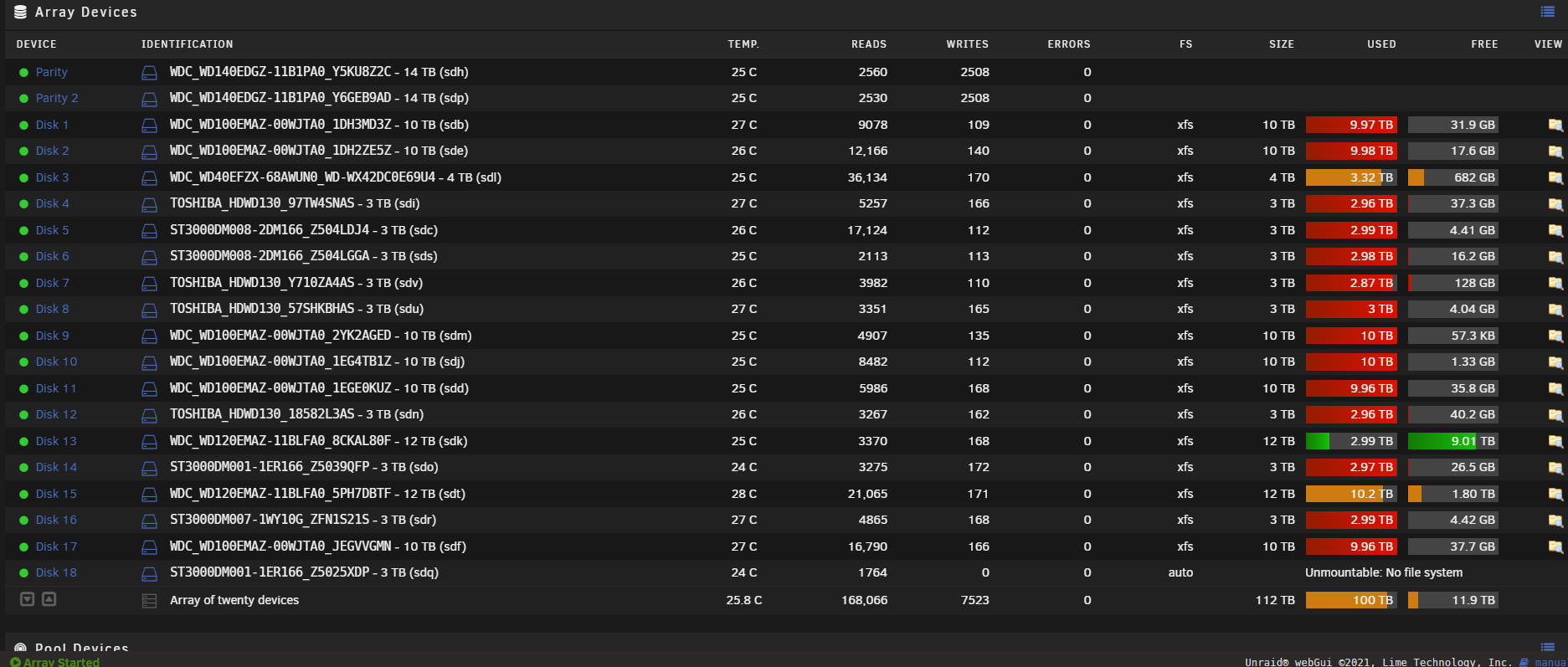

I thought a 3 TB disk went bad so I just replaced it with a bigger drive and parity ran everything ran well.  I then realized that the disk that went bad was unplugged.  I went ahead and added it to the array and it did an auto clear disk.  Once finished it became unmountable no file system.  How do I fix that.  If there is any data on that disk I do not need it as I believe it was cleared off when it was added to the array.  I don't mind posting the diagnostics but need to know which file in the diagnostics I need to post and how?  The log seems pretty long if that's it?  Isn't there an easy way just to reformat that drive and add it back to the array or something similar?

Post a screenshot of Main - Array Operation.

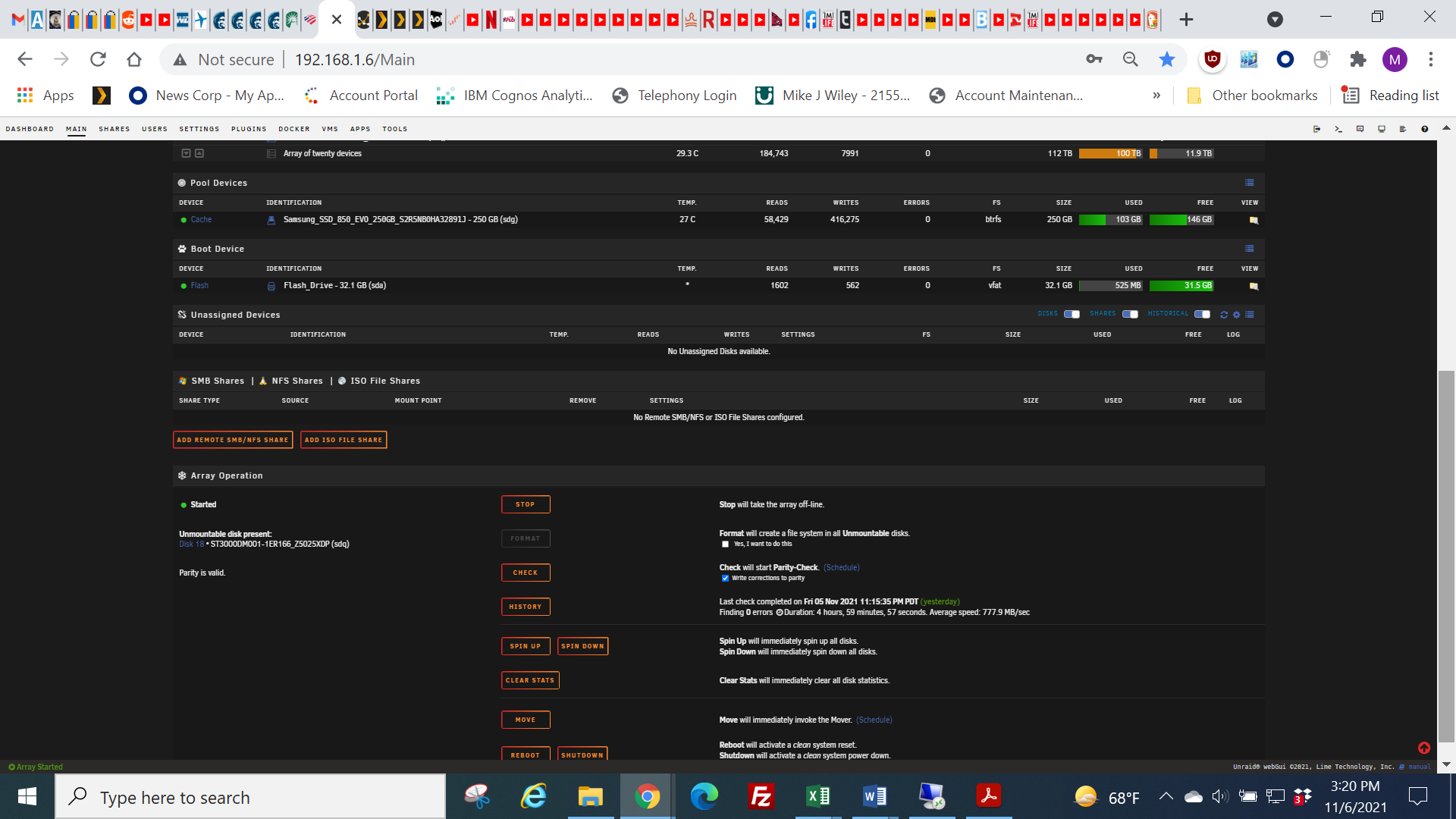

you mean the lower portion?
Yes - on that there is a format button that is enabled when you tick the associated check box.
I don't see it anywhere?  I have used it in the past but don't see it in the 2 screen shots above?  Can you pinpoint it?
It is the button that is currently greyed out on the last screen shot waiting for the checkbox to be ticked to enable it.
Ah man do I feel stupid DUH!  I did a find Format and there it was right there in the second screen grab!   I did not expect it there!  I am formatting it right now.   Thank you very much for your help
