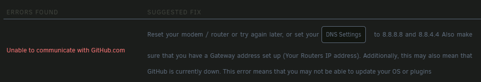

Update error
Here is the error displayed by "Fix Common Problems" plugin:
It looks like your Cloudflare creds aren't correct.  The error message is in the post.  You might want to log in to your CloudFlare account directly to validate that the email address and API Key remain unchanged.
ERROR: Invalid CloudFlare Credentials - 000 ---------------------------------------------------------------- Make sure the EMAIL and API_KEY variables are correct. You can get your CloudFlare API Key here: https://www.cloudflare.com/a/profile If you are using a zone token please remove the EMAIL variable from this container.
Just to be safe I re-copied my API key from Cloudlare and no dice. I think there is a larger issue preventing any internet access from this server at all
Did you try the fix it described in that error message?
I did with no luck
