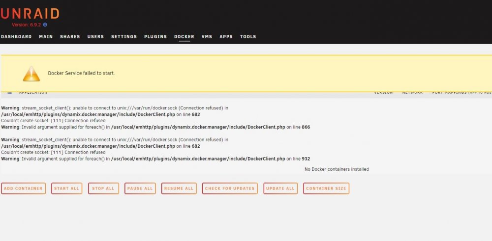

Two drive fail same time with same error count and Docker error - weird
Hopefully someone can help with this one. System been fine for months, this morning notice Plex not up. Logged into, two drives red balled. Both showing exact same count of errors, which is weird.
Looks like around 11:38 last night, things went nuts, tons of disk errors and such. It weird though, that two drives fail same time, with same number of errors. Array still up as I have dual parity, but another weird one, docker won't start, like it thinks it all gone as well.
Also, if I got the VM tab, just says no VMs installed... and I do have one VM previously running.
I've attached Diag zip and screen shot from docker screen. I'm assuming either something with the controller or the cables on those two drives, or maybe even the back plane on the 3x5 cage, but I've never seen an issue with that.

It looks as if a cache drive, disk14 and disk15 all dropped offline at about the same time.   Is there anything they share (cabling, disk controller) that needs checking.    As a result there is no SMART information for those drives in the diagnostics.
I suggest you power-cycle the server to see if those drives come back online and then post new diagnostics so we can see their state.

Yep, I replicate the entire array to a secondary system, just in case. :)
This was caused by the quite common controller issue with some Ryzen boards, looks for a BIOS update, it's been reported to help, if not consider getting an add-on controller.
Thanks for the info! I'll get that done asap!
Yep, was two years out of date, updated it to the latest.
Drive rebuild all complete and successful. Everything working ok again! Thanks @itimpi @trurl and @JorgeB
