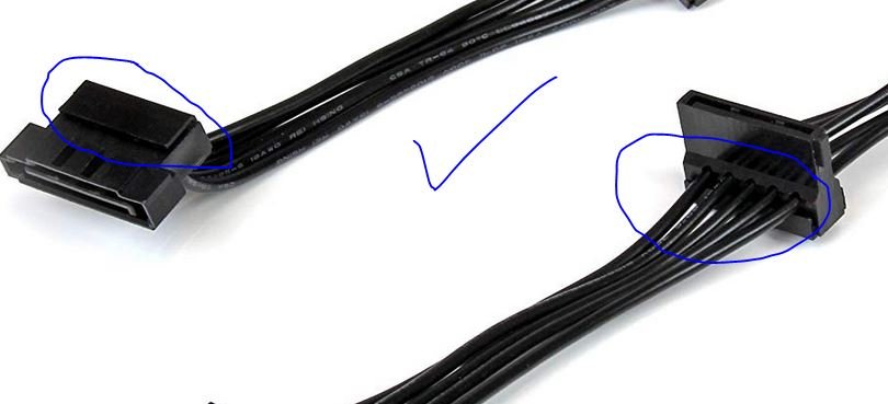

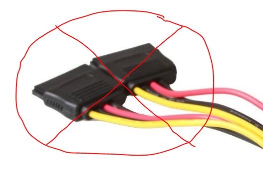

Why not just buy a quality SATA power splitter? As long as it's not the molded type connectors.. The StarTech 4x ones look good.
It is an option if used properly. The issue is the proper management of current, which can be trouble if you don't have electronics knowledge. It's easier if you can find a PSU which includes all the connectors you need, and leave the technical details for the PSU manufacturer.
Too many high current drives daisy chained through even a quality splitter can be trouble, the SATA power connector just isn't designed for large amounts of current. I believe the maximum 12V current through a SATA connector is 4.5 Amps, so each splitter chain is limited to that total for all drives connected.
A better option is the old style 4 pin connection, it can handle 11 Amps on the 12V rail, so a SATA splitter with the 4 pin connector as the source can handle many more drives safely.
Fair point, but 3 per connector is plenty safe for modern drives (reds are like 1.8 peak)- 4 if you like to play the odds :D. It is critically important that it's a quality connector, however. Ask me how I know (hint, it involves smoke).
